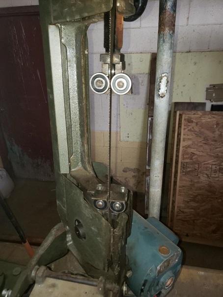

Quite a few months ago, I bought an old Horizontal Bandsaw.  1HP motor.  And I am trying to find a manual for it so I can order parts.
One of the blade guide rollers is missing. Which if I had looked a little closer I would have realized.
From what I can read on the plate, it is a
King Machinery Inc
Heavy Duty Metal Cutting Band Saw
I have more pictures if anyone would like to see.
Also I have googled and found Similar size horizontal band saws, I am just not smart enough to know if those parts would fit.
Any thoughts, ideas or info would be greatly appreciated.

That BandSaw will have many different names. I have worn out a couple, but I still use mine. Don't look for a hard answer, if you are missing a bearing, look at it's number and order one from your local bearing/parts store. The Saw is not perfect, but they still keep ticking. If H/F has a saw, look at it's parts sheet.

I have a Jet horizontal, vertical, band saw very much like yours it's better than 30 years old and going strong. Gide rolls are easy they're just sealed bearings with a center hole the size of the screw holding it on. Take it to a bearing supply or driveline supply/shop and buy a couple. Replace them ALL while you're at it or sure as the sun is bright the one you didn't replace will go south soonest. There is a 3rd guide roll that holds the blade down on the work, don't forget that one!
In the pic with the saw vertical it's a vertical band saw. If you replace the platen, the little square plate with the slot surrounding the blade with one about 12" square it becomes a VERY versatile metal saw. Change over is unscrew the little one and screw the large one on. Reverse the process to use it for a cut off saw.
One operator's manual is much like another where these little beauties are concerned. Parts not so much but they tolerate mix and match better than most machine tools.

Be patient with the guide roll screws, they've been in there a long time. Maybe hit them with a few drops of penetrating oil and let them soak a while. If the bearing supply doesn't have anything measure them and look online. These kinds of guide rolls are common everywhere.

Well last night I got the bearings off and then I went to Tractor Supply and D&B Supply (both are farm stores, tools, clothes, feed, implements, etc etc) and neither had bearings this small.
Today I went to a Bearing and Hydraulic place which is were I go when a hose blows or trying to fix an old hydraulic implement and got  all 6 bearings.
I know their prices may have been more than online BUT I am 100% sure they are exactly the same as what I took out of the machine.
I looked at the parts list for central machinery, Grisley and JET.  But since I could not get exact item specs, I was worried they would not fit.
She powered up in the horizontal position with no issue.
Vertical she does not spin unless you give the pully a little push (or start her in Horizontal and lift her up)
I am guessing this is because the motor is getting old?
I can not find a blade at any of these places so I will take a look online as Frosty suggested.
This blade is toast, I tried to cut a piece of thin pipe and the blade was sliding side to side.

It won't pull the band in vertical because the tensioner screw is loose or worn. The tensioner is the knob on the far end from the motor, turning it moves the guide wheel in or out, tightening or loosening the blade. When you tip it up the wheel moves downward under it's own weight and the blade loosens.
If the blade is loose it stop as soon as the teeth bite or won't cut straight, etc. We'll talk about tensioning and adjusting the new guides so she tracks straight. The tricks are pretty easy but you need it working to check and its really hard to learn if it doesn't work. Make sense?
OR doesn't the motor run when vertical? That's a whole nother kettle of skittles.
Mine started doing that and I found the gear box was all gummed up. Cleaning it out and greasing it with wheel bearing grease corrected the problem along with the adjustments Frosty mentioned. Also check the v belts motor to gear box for wear.

Looked inside and it looked ok,
The motor Runs in the horizontal position.
And will run in in the vertical position if I start the bandsaw in Horizontal and lift it up or If I give the pully a little nudge.
IF starting in vertical position the motor Whines like it is trying to move but does not, like it is bound up.
I will tighten the blade as much as i can.
This may be dumb but can it be over tightened?

According to the manual for my HF model the blade should be tightened just beyond where it is slipping on the drive wheel, no tighter.  I think that if over tightened the blade would have more of a tendency to jump off the wheels and would put an unnecessary strain on othe components like bearings and might even break the blade.
