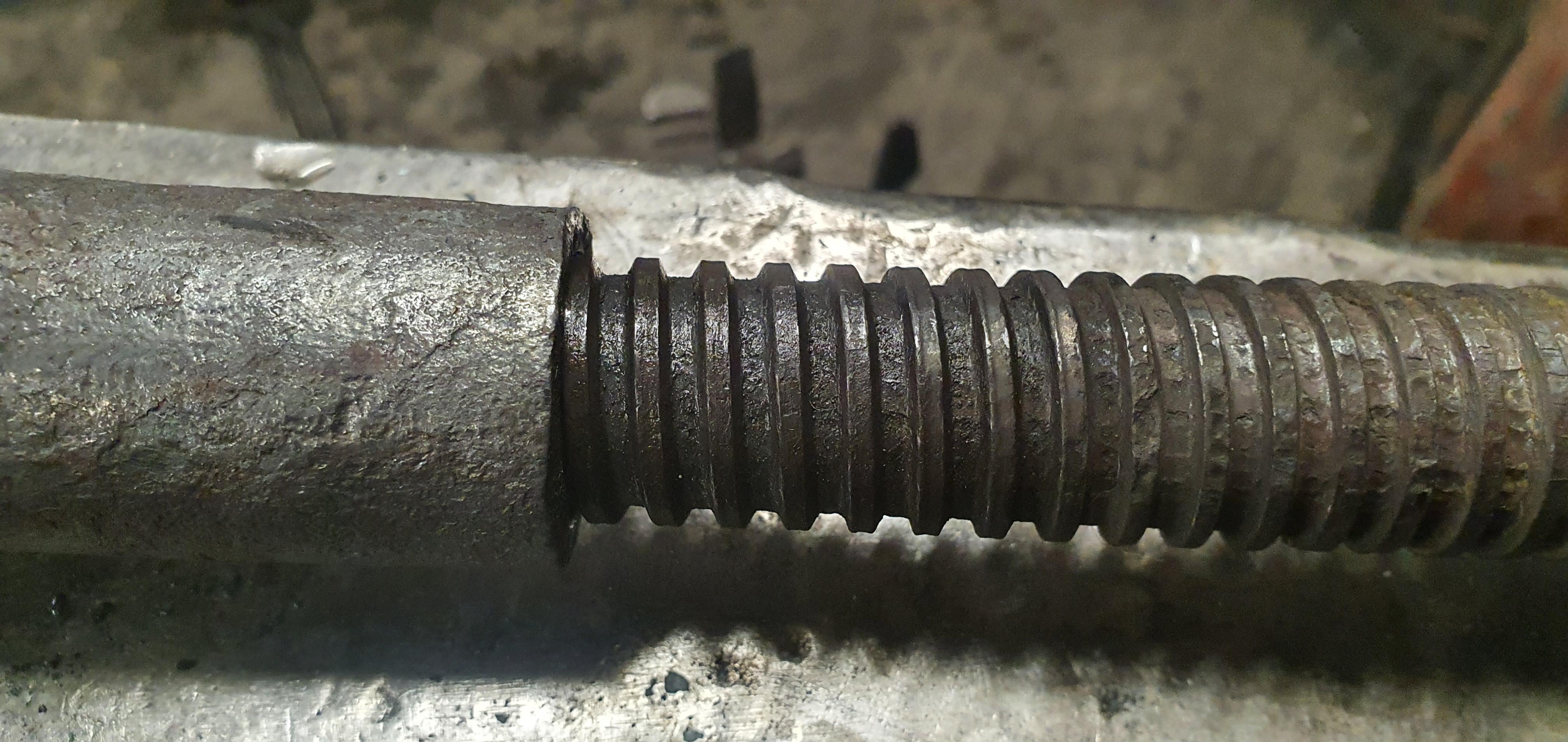

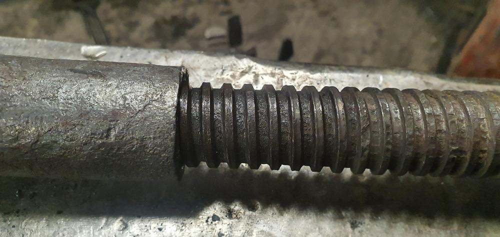

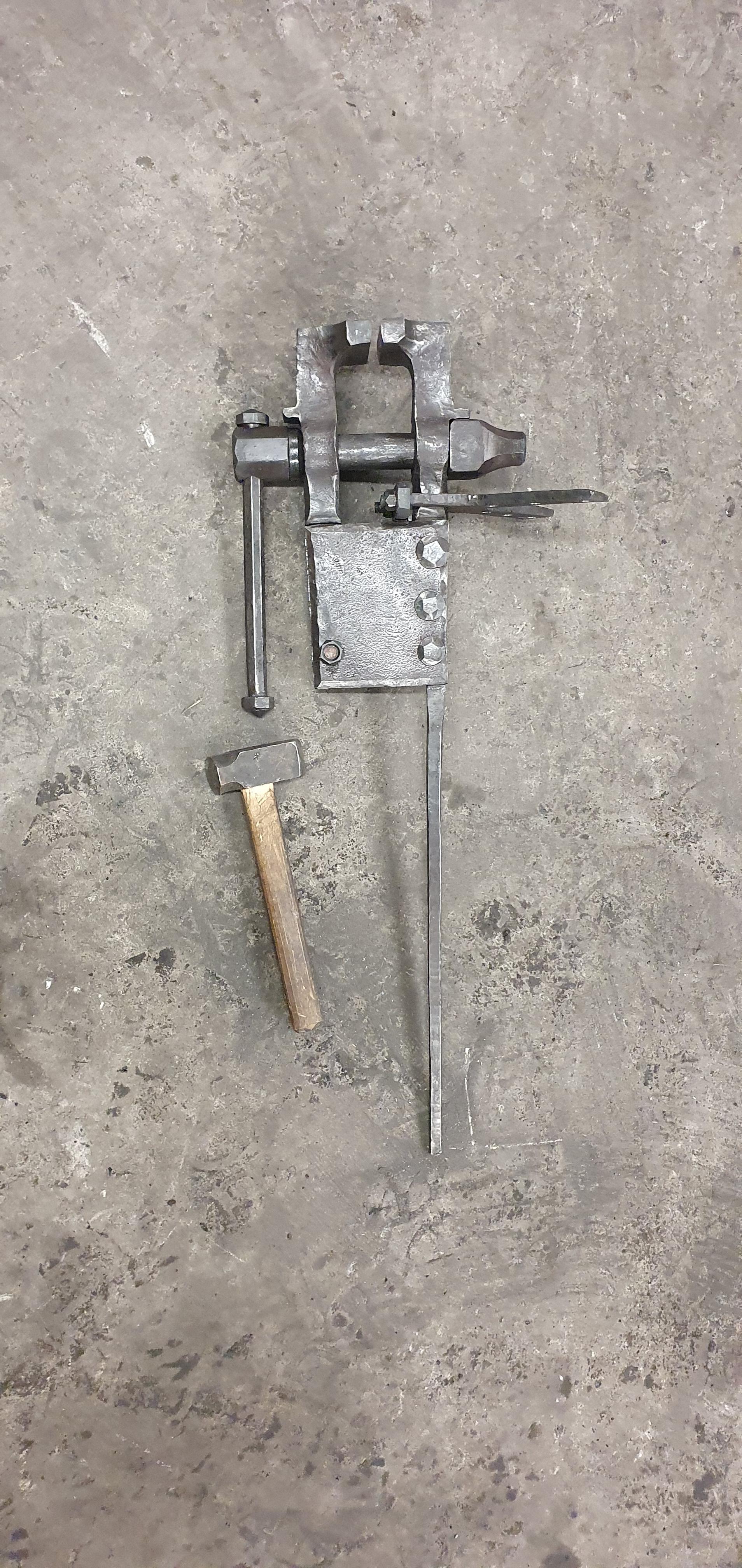

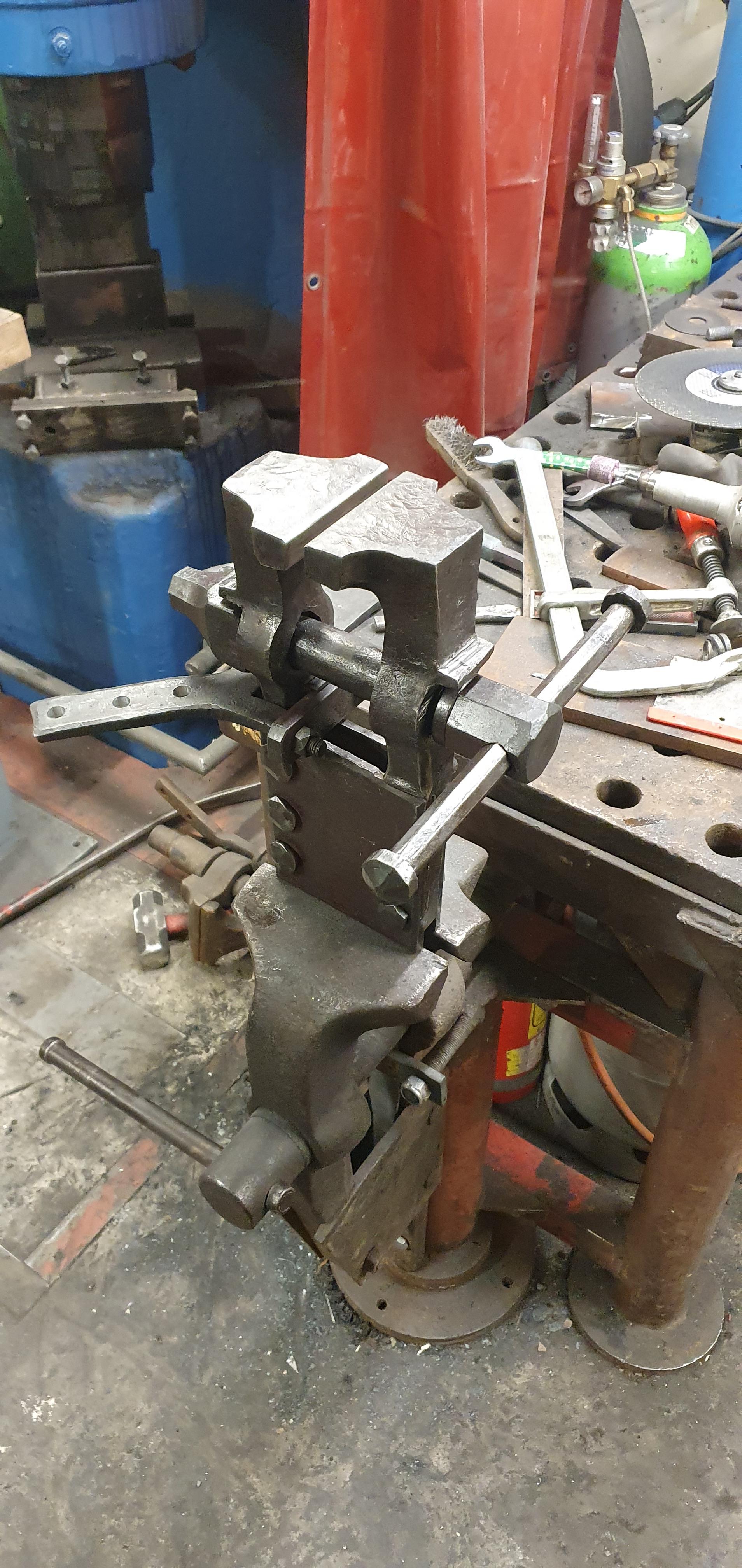

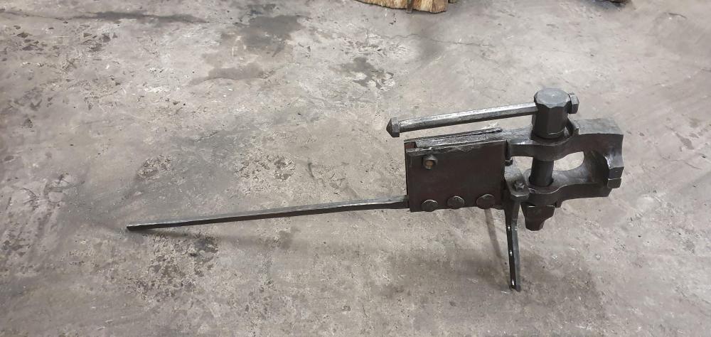

Domnu Posted February 4, 2022 Posted February 4, 2022 My master had to leave for a week and left me with the simple task to "make something nice" while he was gone, so I decided to try making a vise, again...This one is a little smaller than the last one. 4" jaws vs the 6" on the last one. I really wanted to try making this style with upset corners after I saw a similar shape on one of Tom Latané's vises. I forgewelded in 1070 steel into the jaws. Another fun thing with this vise is the threads. Instead of turning them on the lathe I forged them this time, both the inner and outer threads. Really went a lot quicker than making them on the lathe. The screw is made from an old car axle forged down and then forged in a swage to make the threads. All in all the whole build took 6 days. Quote
Jobtiel1 Posted February 4, 2022 Posted February 4, 2022 Indeed, very impressive! how did you forge the inside threads? ~Jobtiel Quote
Domnu Posted February 4, 2022 Author Posted February 4, 2022 I drilled out a hole in the nut matching the outer diameter of the screw, then i just put the screw inside the nut whilst the nut was hot and forged the nut around the screw in a swage. Made some really nice internal threads Quote
