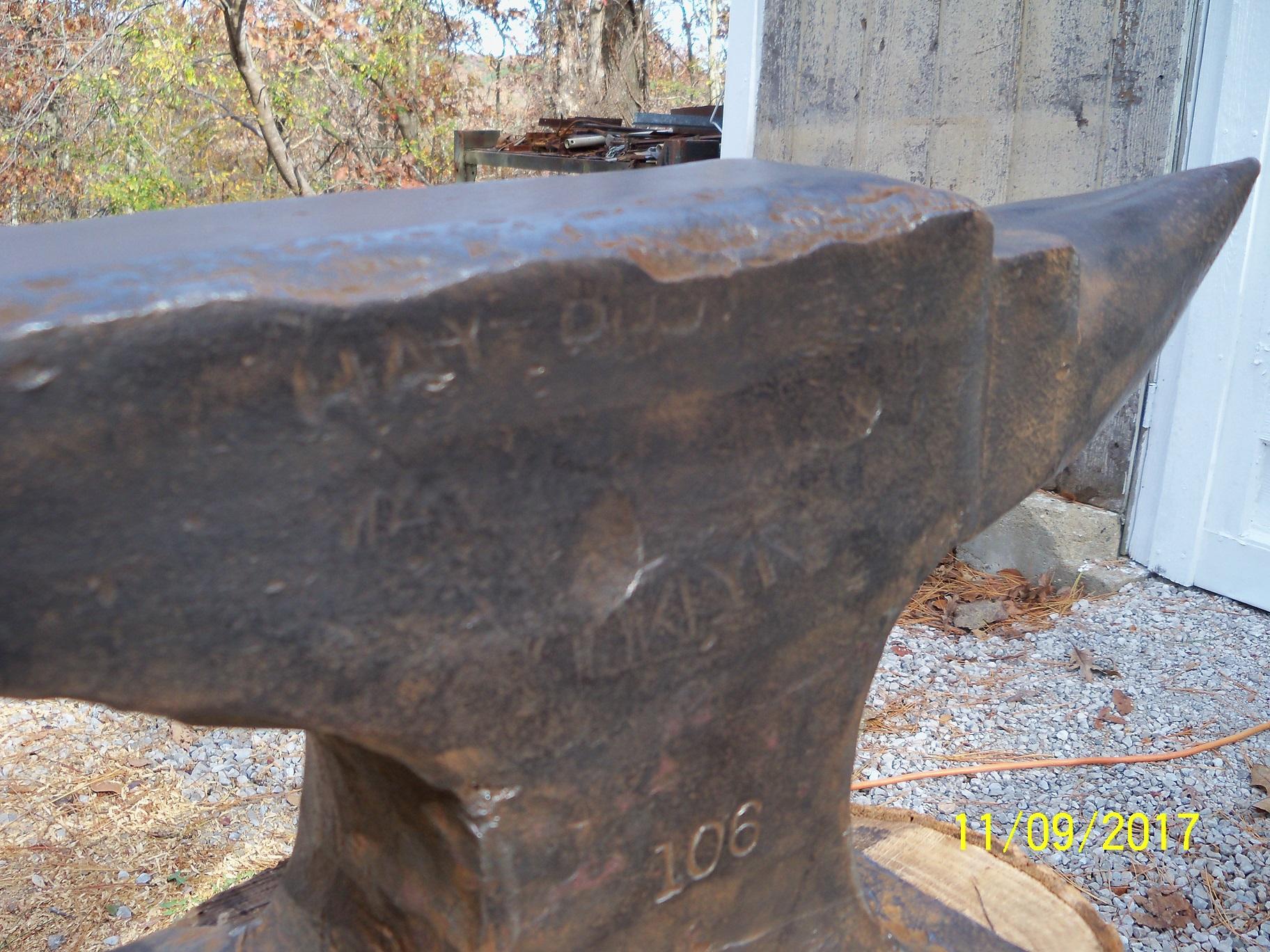

I picked up a 106 pound Hay Budden in 2017 that has rough edges. I thought of grinding them out a little but decided after advice obtained here to use it for a year before doing that. Glad I took the advice because I haven't had any trouble when using it so it remains as it was.
Those edges have been nicely rounded Iron Dragon. I wouldn't of touched it either.
