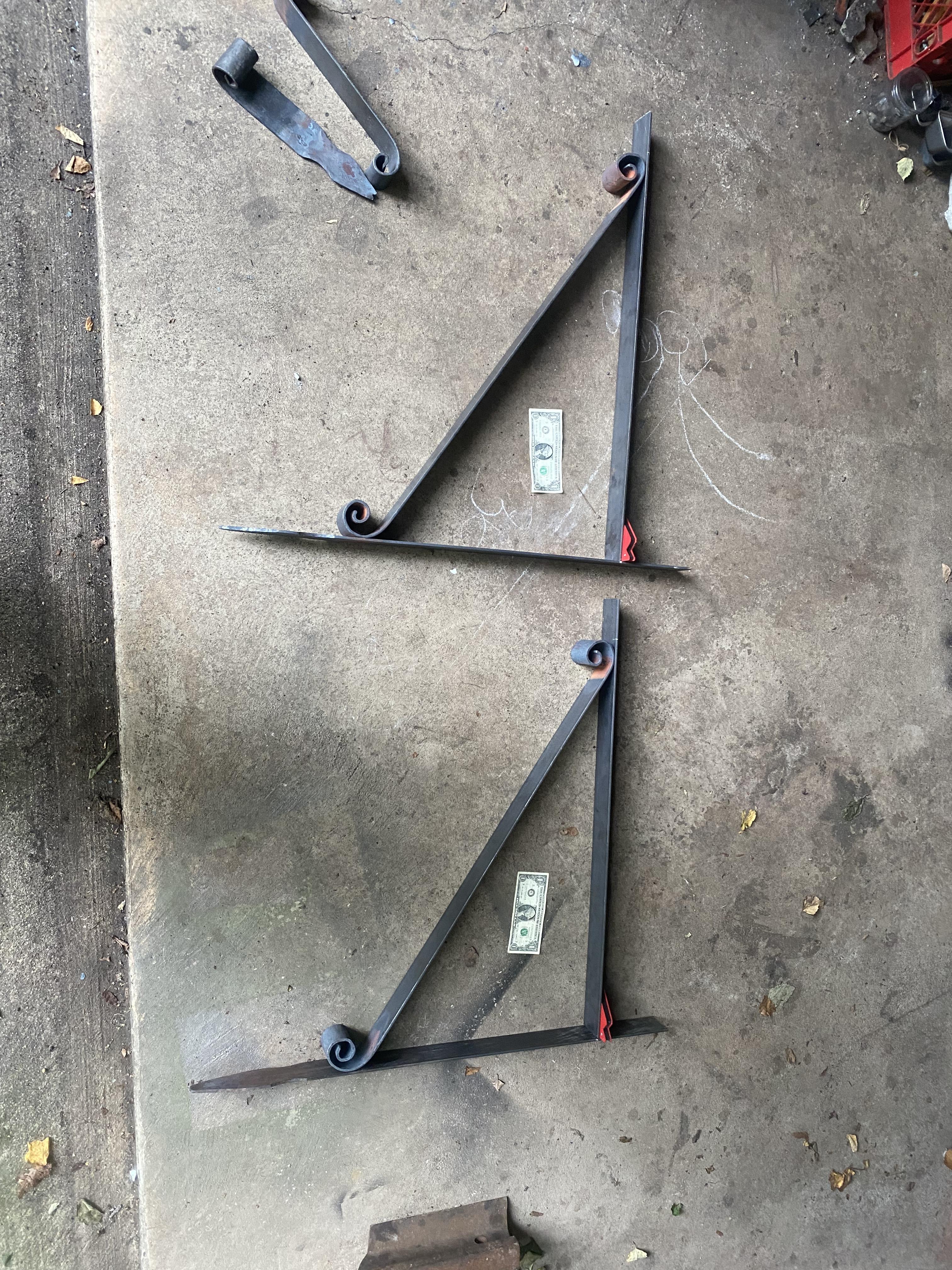

I am making a pair of roof brackets, 34”x 30”, of 2 1/2” x 3/16 flat bar.  The client wants a dimpled or ‘Peened’ texturing to multiple surfaces of the project. The flats are pretty easy/straight forward.
I am having difficulty with peening/dimpling/texturing the scrolled ends. I have tried texturing before scrolling but, this pulls most of the texture out.  I have tried texturing after scrolling but can’t get the entire surface textured and this process throws the scrolls out of proportion and distorts them to a point of near ruined.

Would it be possible to make a jig to fit just on the inside of the scroll to reinforce it while peening? Maybe that could help with the deforming?
Do it flat. To get the texture to show on the scrolled part, you need to texture the other side of the scroll. Its a transition thing. the texture you see on the flat disappears inside the scroll. The scroll surface you see is actually the reverse side of your material.

What Anvil is saying is the visible part of the scrolls is the back side of the component and is facing or against the wall and isn't visible UNTIL the scroll exposes the back side of the stock. Mark one side of a piece of paper and roll it to see what we're talking about It makes sense. Honest.
Texture it first THEN turn the scrolls. You do NOT need to hammer it to turn a scroll. Scrolling wrenches will do it with little damage to the texture.

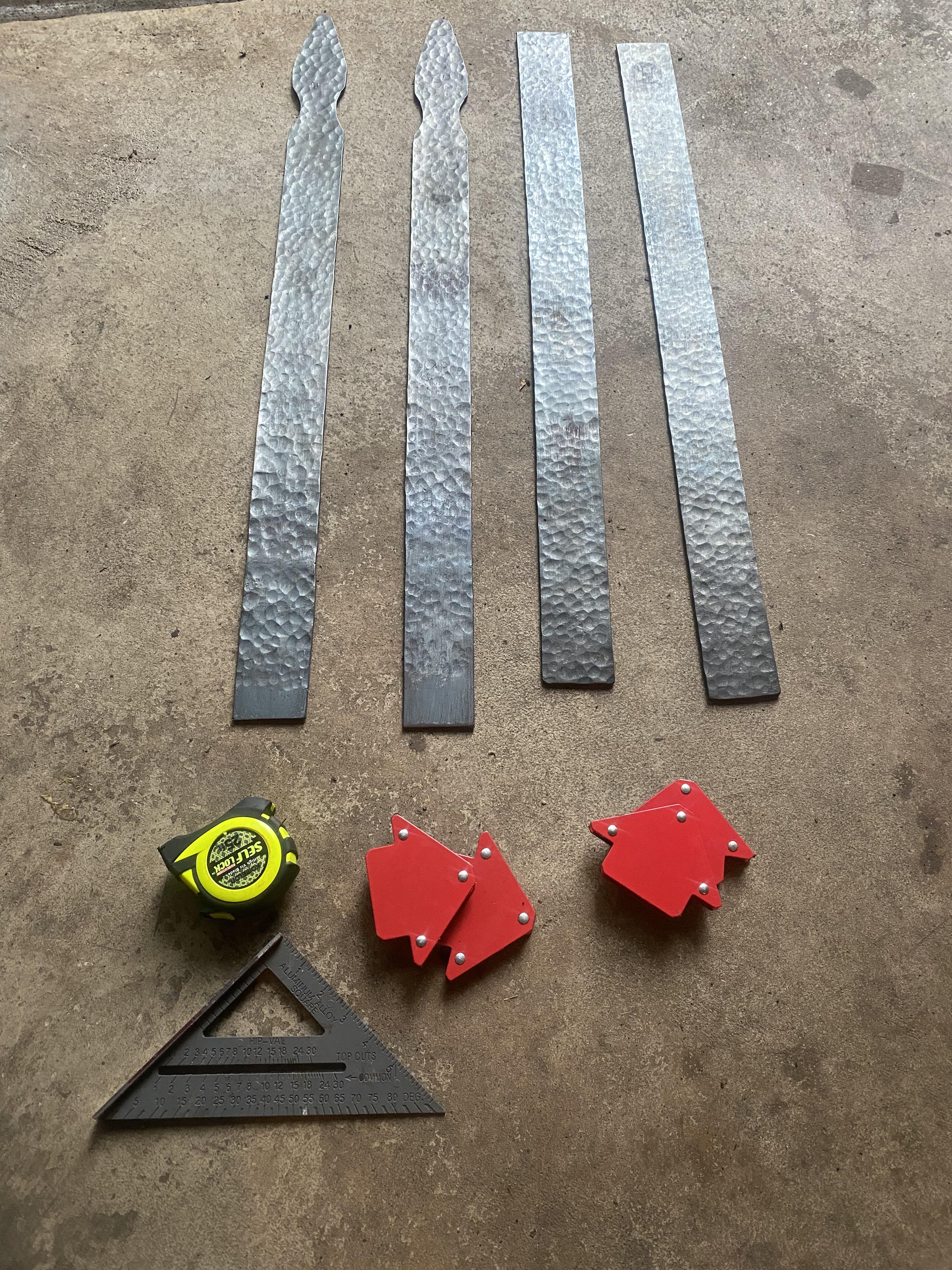

I did mark and leave the untextured portions with the mill finish for welding. I have a 5 burner gas forge that, theoretically, I could heat up a massive section but lo, I do not posses much power or air equipment, for the moment I’m abusing my body, 90% of it’s by hand and hammer.   Attached is a picture of the peened surfaces thus far.  Tomorrow is more measuring, marking, and hot punching the mounting holes.

If you're going with priming and paint, sanding is a waste of time. A knotted wire brush in an angle grinder (with all appropriate PPE and safety precautions!!!) is probably your best bet.
