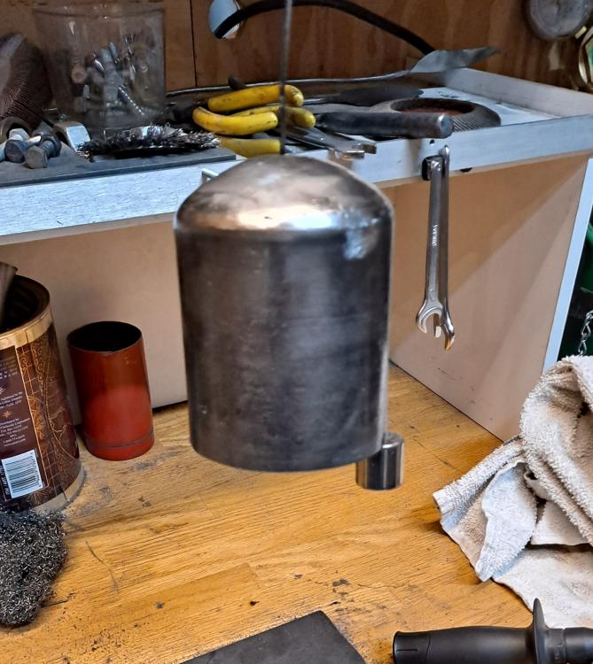

Ted Ewert Posted June 22, 2021 Share Posted June 22, 2021 I was curious how a small magnet could effect the resonance of a large anvil. I took a bell I made and stripped it of the handle and striker and hung it from a piece of wire. It rang quite nicely. I then stick a relatively large neodymium magnet to various spots on the bell to observe the results. You can see the progression of the magnet as I moved it down the bell Magnet on top, no effect on the ringing. Magnet in the middle, little change in volume, pitch and duration of ring. Magnet on lower edge, more reduction in volume, pitch changed and ringing duration shortened. Magnet on the end of the bell, almost completely attenuated the ringing. At that point the bell was a dead ringer. This experiment was far from thorough, but did reveal some interesting results. The ratio of the mass of the magnet to that of the bell is something to consider. The deadening effect also worked with smaller magnets on the edge, although it took two magnets to kill the ring. I'll let you guys draw your own conclusions. Quote Link to comment Share on other sites More sharing options...
Glenn Posted June 22, 2021 Share Posted June 22, 2021 Take into consideration the vibration nodes and magnet placement. If you hang the bell from natural fibers it rings better. Quote Link to comment Share on other sites More sharing options...
George N. M. Posted June 22, 2021 Share Posted June 22, 2021 I have to wonder about the effect of magnetism has, does it just cause the magnet to stick to the bell or does the magnetism itself have a dampening effect? I would want to compare the effect of the magnet with a similar sized piece of steel attached at the same positions by welding or epoxy or super glue. I suspect that it is the mass attached to the vibrating metal of the bell which unbalances the vibrations and dampens them, similar to an unbalanced wheel, rather than magnetism, particularly when attached to the rim. "By hammer and hand all arts do stand." Quote Link to comment Share on other sites More sharing options...
JHCC Posted June 22, 2021 Share Posted June 22, 2021 Good point, George N. M., and excellent suggestion for isolating the variables in the experiment. I would further suggest an additional experiment with the piece of steel at the same mass as the magnet rather than its size, as steel and neodymium do not have the same density. (If you really want to be picky, don't forget to include the mass of the glue.) 8 hours ago, Ted Ewert said: Magnet on the end of the bell, almost completely attenuated the ringing. This makes complete sense, as the vibrations of a bell have greater amplitude at the lip than they do in the body. With anvils, some smiths report better results from putting magnets under the heel and/or the horn, where the amplitude of the ring's vibrations is greater than in the mass over the waist. Quote Link to comment Share on other sites More sharing options...
ThomasPowers Posted June 22, 2021 Share Posted June 22, 2021 Yes there should be a node of zero vibration up at the top where the support is if the bell is perfectly proportioned and a zone of maximum vibration at the lip. For a simple experiment, fasten a C clamp at the lip and see what that does! Quote Link to comment Share on other sites More sharing options...
LeeJustice Posted June 22, 2021 Share Posted June 22, 2021 To test whether or not the magnetism has any effect it should suffice to have the magnet near to, but not in contact with the bell. One could vary the distance, up to almost touching to test that hypothesis. I suspect no change. the magnet touching is more or less the same as placing your hand on the bell. Similar to damping a guitar string. Quote Link to comment Share on other sites More sharing options...
ThomasPowers Posted June 22, 2021 Share Posted June 22, 2021 Now if the magnet is close but NOT touching the metal; then you can get eddy current braking. Quote Link to comment Share on other sites More sharing options...
JHCC Posted June 22, 2021 Share Posted June 22, 2021 Wouldn't work on non-metallic bells (e.g., ceramic or glass). Quote Link to comment Share on other sites More sharing options...
ThomasPowers Posted June 22, 2021 Share Posted June 22, 2021 Non Metallic bells and you posting on a blacksmithing forum! (Would depend if the ceramic or glass was conductive or not.) Quote Link to comment Share on other sites More sharing options...
Ted Ewert Posted June 22, 2021 Author Share Posted June 22, 2021 What surprised me was the dramatic difference between placing the magnet on the side of the bell, right at the edge, and placing it 90 degrees on the edge. The mass was in almost the same place yet made the biggest net change in damping. I have a small C clamp which I'll try out. Quote Link to comment Share on other sites More sharing options...

Ted Ewert Posted June 23, 2021 Author Share Posted June 23, 2021 Another interesting tidbit. I turned the bell upside-down and placed a piece of steel across it. That dampened it just like the magnet did. You'd have to get into the physics of how the resonant wave travels within the bell to really understand why things work the way they do. In this case the most efficient spot to remove energy from the resonating bell is at the opening. An anvil is a different beast. On another note, I'm partial to Led Zeppelin myself. Quote Link to comment Share on other sites More sharing options...
Irondragon Forge ClayWorks Posted June 23, 2021 Share Posted June 23, 2021 I would think a couple of wraps of duct tape or latex calk around the edge of the bell would dampen the ring as well. Quote Link to comment Share on other sites More sharing options...
JHCC Posted June 23, 2021 Share Posted June 23, 2021 Anything that inhibits the vibration of the lip, really. Quote Link to comment Share on other sites More sharing options...
