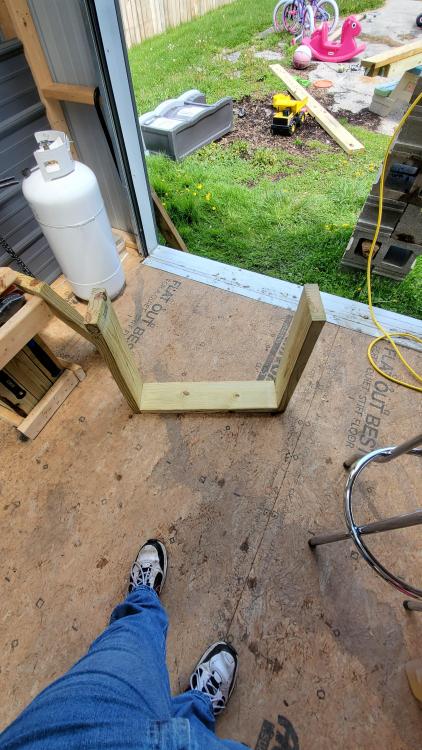

SinDoc Posted May 8, 2021 Share Posted May 8, 2021 Dont think I failed at it but who knows . Planning on using primarily charcoal. Used some fire bricks I had laying around for the pot. Got it all packed down and ready to try once I get an air pump. Quote Link to comment Share on other sites More sharing options...
Frosty Posted May 17, 2021 Share Posted May 17, 2021 How's it work? From here I might've tried hammering it harder but I can't feel the soil. You aren't thinking fail are you? You know the old saw about the proof of the pudding don't you? Light that puppy up and take her for a test run of ten. Frosty The Lucky. Quote Link to comment Share on other sites More sharing options...
SinDoc Posted May 17, 2021 Author Share Posted May 17, 2021 I messed with it a little last week and unfortunately the blower I got was a little too powerful and sends fleas everywhere. Need to downgrade it a bit. I used lump charcoal and got a piece of mild round stock up to a bright yellow in no time. Need to cut the pipe a bit shorter, put in a 90 and maybe a check valve for a bit more control on the air then mount a lower power blower to the side. The soil was quite wet when I did this so it has since turned into a nice solid mass of almost clay consistency. The fire pot has already hardened quite nicely as well. The only problem I foresee is the bottom got a little toasty to the touch after mild tinkering, so I may need to either remove the fire brick or make it deeper. I only had 2x6's laying around and probably should have gotten 2x8's. Quote Link to comment Share on other sites More sharing options...
Frosty Posted May 17, 2021 Share Posted May 17, 2021 1 hour ago, SinDoc said: should have gotten 2x8's. Nooooo, 1" x 8"s are plenty strong enough. Nothing wrong with using what you have of course but if you're buying new only get what you need. A piece of plywood with a 2 x 4 stiffener or two under it will hold the soil. Remember the beauty of a JABOD is NOT having to move all that dirt and the forge at once. You empty the soil into a couple buckets and reload it after you've moved it. Yes? If you have too much blower, don't use the whole blast. Make the connection between blower and tuyere pipe so you can misalign them and waste excess blast. It's just air aim it at your feet if it's a hot day. Hmmm? I use a 12v DC mattress inflator blower when I burn coal or charcoal and I NEVER build a fire THAT big so it's always only partly aimed at the tuyere pipe. More sand will lighten the soil if it's too heavy and will help prevent shrink checking. I'll ram up nicely when only moist. You're on the right track. I DO want to see pics of your fire and some steel making out in there next time though! Frosty The Lucky. Quote Link to comment Share on other sites More sharing options...
SinDoc Posted May 17, 2021 Author Share Posted May 17, 2021 I had thought about doing something with the angle as that is what I was doing during testing as if I pointed it directly at it, coals and ashes and everything else would go flying. I think I will mount it on the side of the box on a sort of swivel so I can rotate it up and down to change the amount of air going into the pipe. I still need to do some modifying on the pipe as it is currently WAY too long. Shortest piece the hardware store had was 4'. I plan on getting pictures because I know how much you guys love pictures. My intent with this is to give me the ability to make larger items that simply wont fit in my propane forge. Quote Link to comment Share on other sites More sharing options...
Frosty Posted May 18, 2021 Share Posted May 18, 2021 That sounds like a good way to mount the blower and control the draft. I like it. The pipe's too long? The steel tuyere pipe? Oh MY GOODNESS what to do? Let's give a shout out to the 56,000 members of Iforge and see if ANYBODY somewhere in the world knows the answer! Sorry, I couldn't help myself, I'm a weak person when handed a straight line like that. Have a hacksaw? 1" iron pipe of your desired length is a 15-20 second job. Remember the secret is Measure TWICE. No matter how many times you cut it'll still be too short! Want to know how I know? I saw it on Candid Camera. Talk about Old - School! How about this potential solution if you don't have a hack saw. Put the fire trench at the far side of the JABOD. Any reason you can't run the tuyere the full length of the box under the dirt? I'm pretty sure the dirt will get over the sensation of violation, it's pretty resilient that way you know. I'd better stop now, I'm having too much fun. Just remember a JABOD is just a hole in the dirt in a box. Over thinking it spoils the dirt, next thing you know it'll want an allowance and to borrow the car on weekends. Frosty The Lucky. Quote Link to comment Share on other sites More sharing options...

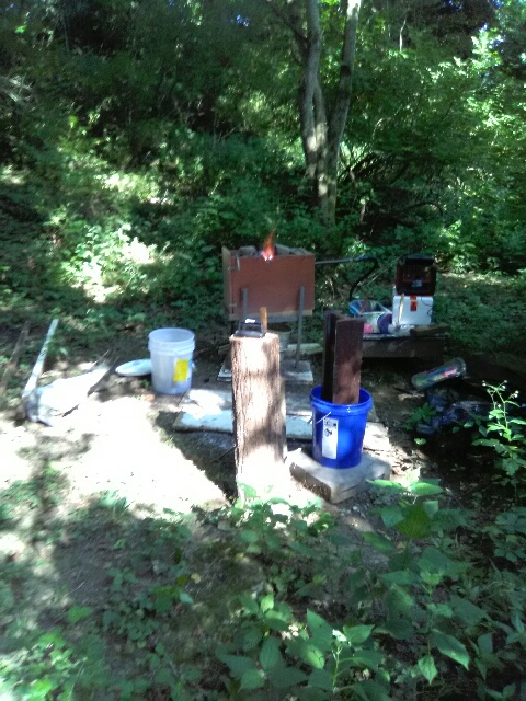

pnut Posted May 19, 2021 Share Posted May 19, 2021 You can see how long the pipe I used in my first jabod is in the picture. I've used it in every JABOD I've built and still use it. Less than an inch has burned off in a couple years. Pnut Quote Link to comment Share on other sites More sharing options...
SinDoc Posted May 19, 2021 Author Share Posted May 19, 2021 I like that. That looks like the pipe I am using with how far it sticks out. One other reason I want to cut it down is I just want the whole thing to be a bit more compact. Plus if I leave it sitting around with that long pipe sticking out, one of the kids is bound to run into it sooner or later . I am way over-engineering it, but having fun in the process. Quote Link to comment Share on other sites More sharing options...
pnut Posted May 19, 2021 Share Posted May 19, 2021 (edited) That was all made from garbage and freebies. I used a night stand from the hotel I work at as the box hahaha. For being made from cheap particle board it lasted about a year or so. There's a ball valve on the end of the pipe to choke the air off. I power the AC mattress pump with a portable jump starter. The pump is in the styrofoam cooler because it was annoyingly loud. I have a hand crank blower now. Jabods are deceivingly simple. I've since switched to a kettle grill that I fill with dry kitty litter and use bricks for the firepot a la MARKIII jabod style. Pnut P.S. Yeah I'd definitely cut it down if you have little folks running around. They have an uncanny ability to manage to run into anything hard or pointy. Edited May 19, 2021 by pnut Quote Link to comment Share on other sites More sharing options...
