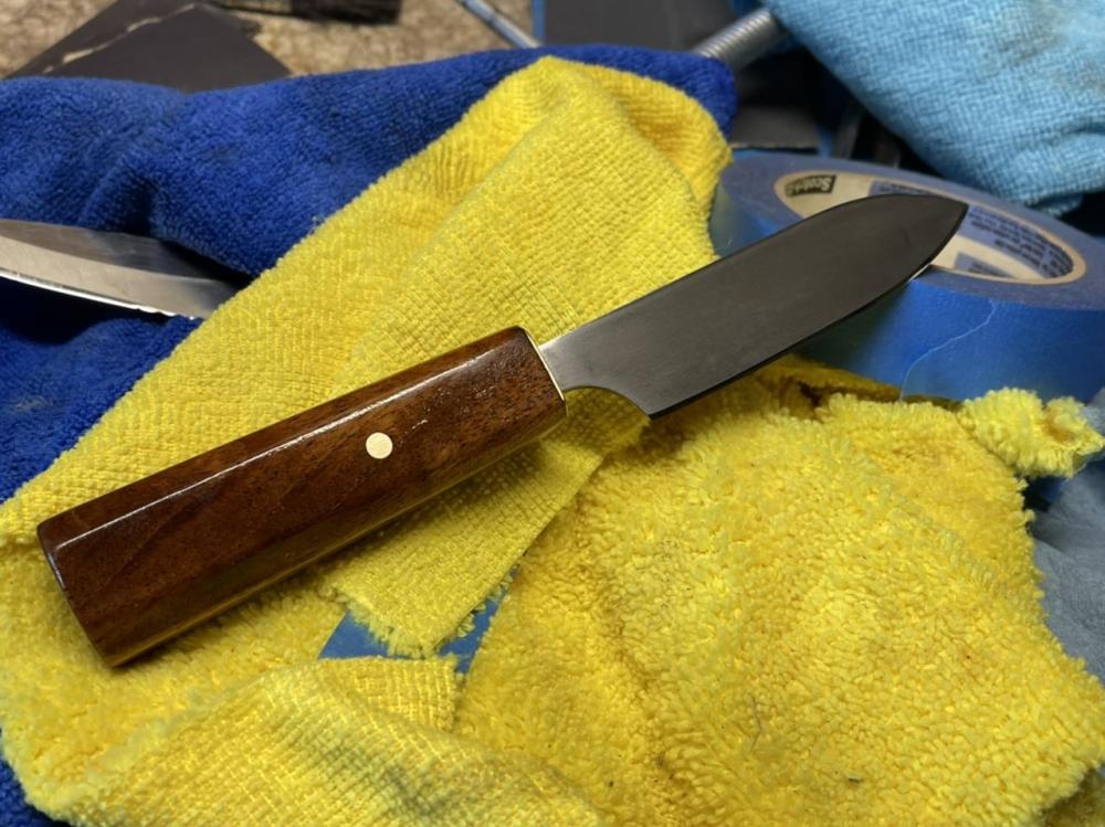

Juicemiser Posted June 24, 2021 Author Share Posted June 24, 2021 (edited) Thanks !!! I finished out my very first blade last night. A little early birthday gift for the lady I’m over the moon on how it turned out! The blade began as a 3”x2”x1/8” rectangle of O1. Rough shaped on my worksharp. Quenched in canola, tempered at 400f for an hour in the kitchen. Hammered a brass bolster out of a tool tag from a ship. Had sanded to 600, etched in ferric and wet sanded with 3000. Brass pin through a hidden tang in a superglued and buffed block of hard Brazilian Mahogany heartwood. Thanks for following along!!! J Edited June 24, 2021 by Mod30 Remove @name tag, resize large photos Link to comment Share on other sites More sharing options...
Trevor84 Posted June 26, 2021 Share Posted June 26, 2021 Hey J, 165 deg steak on those tongs they were my first projects as well, you can't do nothin if you can't hold that hot metal. 5hrs is just fine! When I forge tongs they are usually from 3/4 to get the meat in the boss buuuuut I haven't got to welding reins so I spend the most time drawing and symetrisizing the reins. Having the reins flex different than one another tends to torque out the nibs/jaws and you fight to keep things inline especially if you get them a bit warm. The knife speaks to me, at first glance it seems odd to have the tang come that far out but on second glance it is quite elegant and I bet that would fit nice when you choke up on it for slicing and dicing (in the kitchen) Maybe it's an Asian pattern..... I like it no matter what Link to comment Share on other sites More sharing options...

Juicemiser Posted June 27, 2021 Author Share Posted June 27, 2021 On 6/26/2021 at 10:36 AM, Trevor84 said: 165 deg steak on those tongs they were my first projects as well Hey Trevor, My next sets of tongs will be attempts at those bolt jaw/v-bit tongs, a stout pair of wolf-jaws and also a pair of scrolling tongs. Your step by step will definitely help get me through the v-bits so thank you for sharing! I was shooting for a Japanese “Petty” style paring knife when I started so I’m stoked that that’s the impression you got, thank you!!! Cheers! J Link to comment Share on other sites More sharing options...
