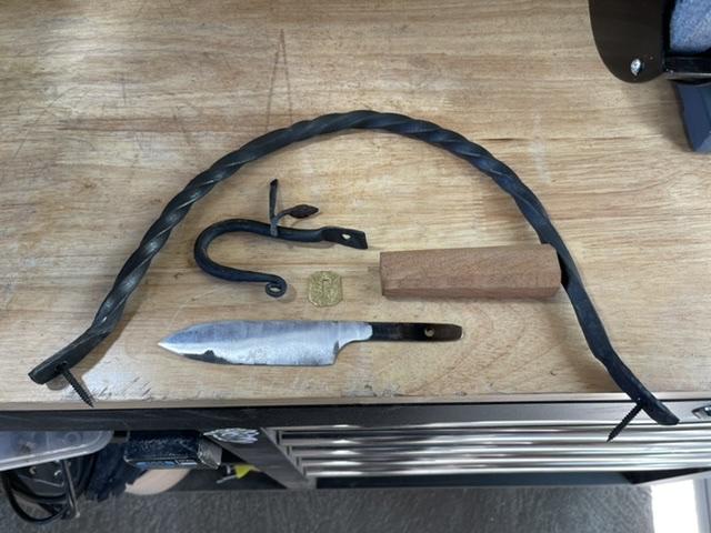

  3. Thanks !!! I finished out my very first blade last night. A little early birthday gift for the lady I’m over the moon on how it turned out! The blade began as a 3”x2”x1/8” rectangle of O1. Rough shaped on my worksharp. Quenched in canola, tempered at 400f for an hour in the kitchen. Hammered a brass bolster out of a tool tag from a ship. Had sanded to 600, etched in ferric and wet sanded with 3000. Brass pin through a hidden tang in a superglued and buffed block of hard Brazilian Mahogany heartwood. Thanks for following along!!! J
  4. Update. Gents I have to say that this repository and finding local smiths in my area has been extremely helpful in the first few steps of this journey! I’ve been able to find bits of time here and there to fire up a project. Here are a few: Second project; new tongs. A bookmark, my first blade, a tong rack and some other stuff!

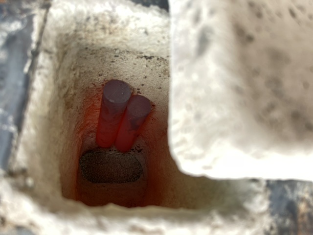

  5. Trevor, Update time: The uni-cast seems like pretty dang good stuff (not that I can compare it to anything else as I’m no expert, it’s the first yadda yadda yeah yeah I’m a noob). I’ve casted four 1.5” x 4.5” x 9” bricks so far and they’re pretty tough; I dropped one the other day onto a patio stone and it barely scraped the corner of the brick! The forge has had a couple of small chips flake off where the cement meets the opening of the can; this I expected so not fussing over it. The flame face looks virtually untouched also; no cracking, chipping, discolouration, melting... nothing. As far as the heat factor goes, despite it’s small size it still does take about 10 minutes to get everything nice and hot inside but I can attribute the sluggishness of the forge to my own sluggishness (I have yet to put a proper kiln wash). Once it’s hot, it stays hot! I can get a heat back into a worked piece of 1/2 square in about a minute or so. When I shut the thing off it takes hours to cool off; I tested this by heating up two pieces of hardened 1” round axle shaft to an orange and turning off the forge with doors closed. Almost an hour later I looked and both chunks of steel still had a slight red glow! The pieces would easily skate a file before this, afterwards the file bit in easily and I was able to get a hacksaw through them fairly quick. I’ve gotten the flame tuned in as good as I think I can. Upon lighting, it seems to be running a touch lean and the jet doesn’t form right away (blue flame spreading out on the floor of the forge) but once the forge heats up a little I just choke the airflow with my hand for a second, the jet forms and the air/fuel mix seems good. I’m not getting too much scale or anything so yeah, pretty happy with how it’s running. And yeah definitely try that inflate-a-form trick if you’re feeling frisky, it was kinda fun to do and it worked great! Hope this gives you some insight on what to expect out of that uni-cast. J

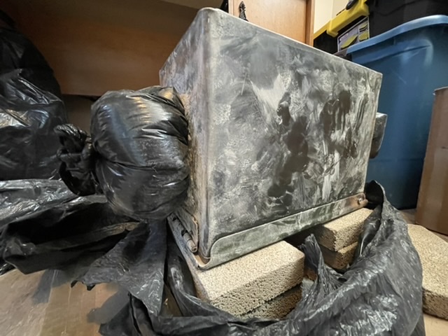

  9. A garbage bag was pulled through the chamber and inflated as a quick ’form’ at the end to keep the walls from caving in. The top of the chamber then cured, upside down tied in a garbage bag with a couple cups of water. I attached the burner, plugged the gaps with a bit of wadded up kaowool and let er rip; the flame seems to be having a hard time staying stable. Not sure if wind, back pressure or the burner needs further tuning. Next post I will take a few more pictures of it running.

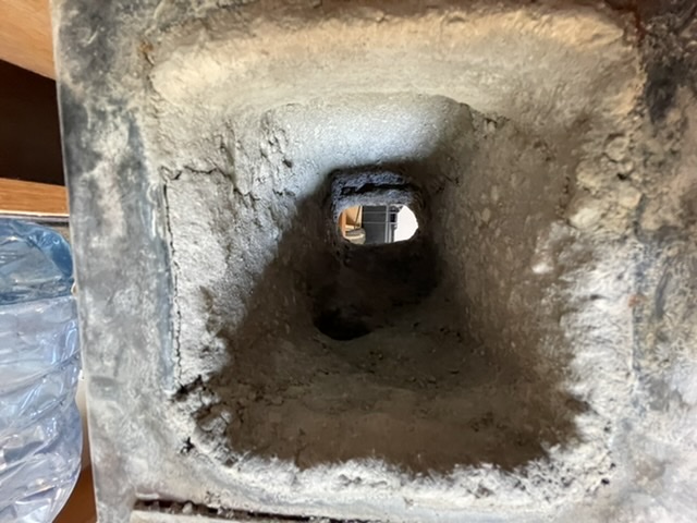

  10. The brick came out OK. Some little cavities on the bottom (more tamping required) and I should have made the top look nicer before leaving it to set. Also, petroleum jelly wins for this particular test. A very thin coat and the test piece fell right out of the cup after curing. Not that I know much about them but those ribbon burners look like they’re kickin butt. I waited till last night to do the roof, so as not to get that sagging. Buttered everything up and it went well. I checked just now and it’s looking alright; more pics later!

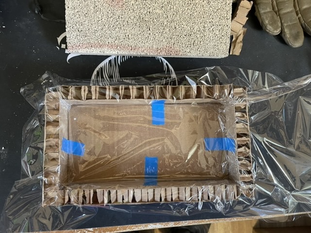

  12. For casting bricks, the plan was to use some readily available materials: thick cardboard form, duct taped together and then plastic wrap laid in/over to release/keep the moisture in. It’s what I’ve got on hand... Not sure what’s going to happen with the plastic wrap but I figured direct contact between the cardboard and the mix would yield negative results. As for lining the fire box, I wasn’t planning on using a form; I don't see any way of getting a form to fit/release effectively inside of that ammo can. Just going to hand bomb it in there; I’m sure there’s some trick I haven’t heard of as of yet hence the sharing! J
