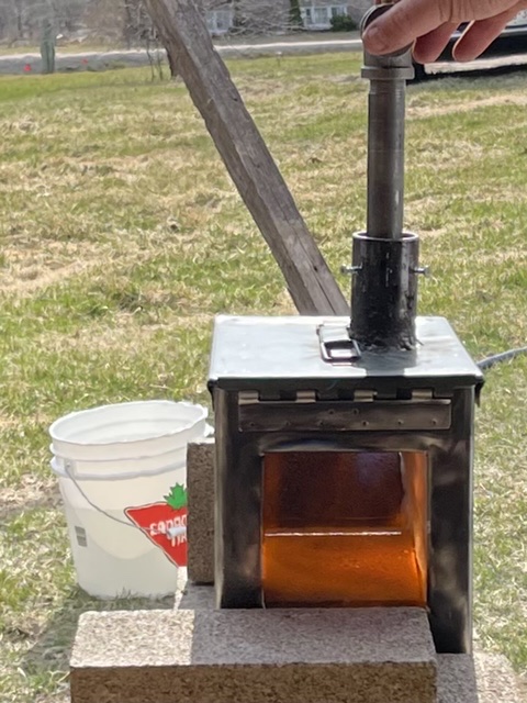

  1. Hey Trevor, My next sets of tongs will be attempts at those bolt jaw/v-bit tongs, a stout pair of wolf-jaws and also a pair of scrolling tongs. Your step by step will definitely help get me through the v-bits so thank you for sharing! I was shooting for a Japanese “Petty” style paring knife when I started so I’m stoked that that’s the impression you got, thank you!!! Cheers! J

  4. Update. Gents I have to say that this repository and finding local smiths in my area has been extremely helpful in the first few steps of this journey! I’ve been able to find bits of time here and there to fire up a project. Here are a few: Second project; new tongs. A bookmark, my first blade, a tong rack and some other stuff!
  5. Trevor, Update time: The uni-cast seems like pretty dang good stuff (not that I can compare it to anything else as I’m no expert, it’s the first yadda yadda yeah yeah I’m a noob). I’ve casted four 1.5” x 4.5” x 9” bricks so far and they’re pretty tough; I dropped one the other day onto a patio stone and it barely scraped the corner of the brick! The forge has had a couple of small chips flake off where the cement meets the opening of the can; this I expected so not fussing over it. The flame face looks virtually untouched also; no cracking, chipping, discolouration, melting... nothing. As far as the heat factor goes, despite it’s small size it still does take about 10 minutes to get everything nice and hot inside but I can attribute the sluggishness of the forge to my own sluggishness (I have yet to put a proper kiln wash). Once it’s hot, it stays hot! I can get a heat back into a worked piece of 1/2 square in about a minute or so. When I shut the thing off it takes hours to cool off; I tested this by heating up two pieces of hardened 1” round axle shaft to an orange and turning off the forge with doors closed. Almost an hour later I looked and both chunks of steel still had a slight red glow! The pieces would easily skate a file before this, afterwards the file bit in easily and I was able to get a hacksaw through them fairly quick. I’ve gotten the flame tuned in as good as I think I can. Upon lighting, it seems to be running a touch lean and the jet doesn’t form right away (blue flame spreading out on the floor of the forge) but once the forge heats up a little I just choke the airflow with my hand for a second, the jet forms and the air/fuel mix seems good. I’m not getting too much scale or anything so yeah, pretty happy with how it’s running. And yeah definitely try that inflate-a-form trick if you’re feeling frisky, it was kinda fun to do and it worked great! Hope this gives you some insight on what to expect out of that uni-cast. J

  8. So I slowly ramped up the temperature in the thing throughout the day yesterday. Here is what the burner looks like at ~3 psi currently. This was around 8-10 minutes after lighting it and it took another 5 or so to get a 1/2 round bar of mild steel to orange. Seems slow to heat up and it basically plateaued unless I cranked the gas up more but maybe it’s just me. The unit-cast stayed red for a looong while after shutting down though! My question is, could my flame be tuned better or is the kiln wash going to make this thing get that much hotter with less juice? IMG_7655.MOV
