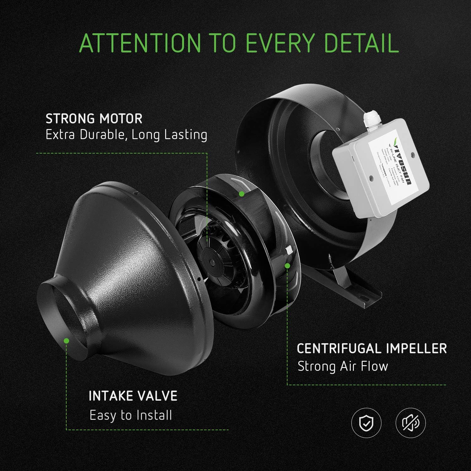

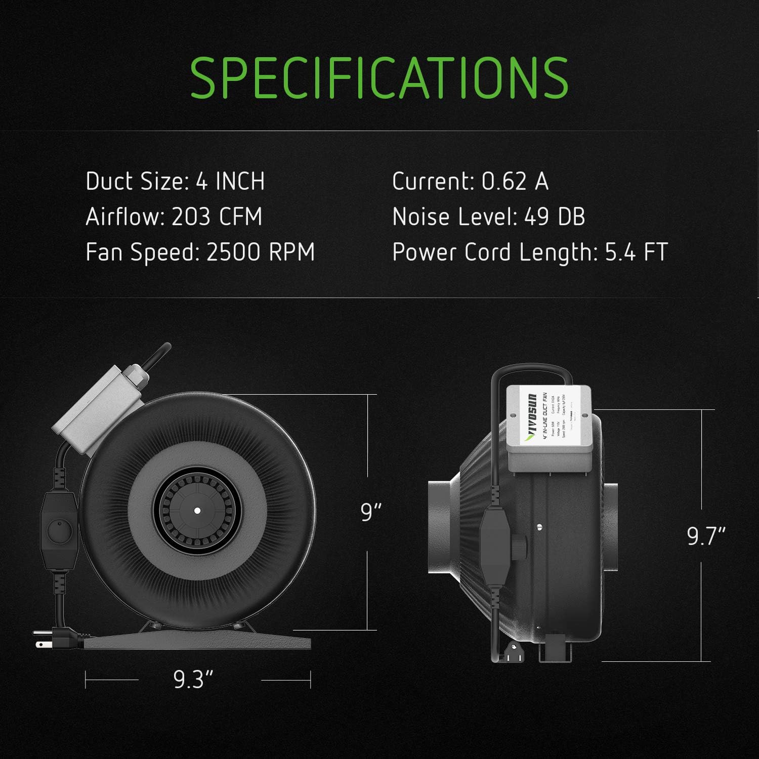

Will-I-am Posted March 17, 2021 Share Posted March 17, 2021 I ordered this vivosun 4" fan and it will arrive in the mail tomorrow. It is variable speed so dialing it in for multiple forge types should work. I was using a hvac booster fan with only 100cfm and it would not get the material color past bright orange. This new fan is twice the cfm and also is a larger 9" centrifugal like the hand cranks which has more push and less backpressure when ash, clinker and whatever tries to clog/block the tuyere. I cost $50. excited! Quote Link to comment Share on other sites More sharing options...
Frazer Posted March 17, 2021 Share Posted March 17, 2021 Interested to hear how it goes.. Not because I need a blower, but because I generally dissuade people from getting those sorts of in line duct fans. They are designed for, in this case, a 4" diameter duct that is essentially unobstructed. It all depends on the size of your tuyere and your particular forge, but if you try to neck that down to ~2" and fill up your grate with ash and coal, that type of fan just doesn't have the oomph to deliver the air you need. That, or the motor burns out quickly since it's working overtime trying to overcome that back pressure. Wil, I've seen your forge and it's very different from mine so YMMV. Quote Link to comment Share on other sites More sharing options...
Will-I-am Posted March 17, 2021 Share Posted March 17, 2021 Frazer, this is different from a regular booster fan. The old 100cfm fan which was regular 4" "almost" worked even after 2x 90degree bends and 10' 1" pipe, I got the material always bright orange and sometimes yellow. It was 15 watts the new one is around 60 watts. Yes, there was back pressure and yes there was ash buildup. This new fan is different, the larger centrifugal 9" flywheel combined with twice the cfm should overcome backpressure and certainly be a large gain from the old fan. I expect more yellow. Also the fan blades are spinning so that there is little friction which will also lead to less backpressure, see pic. Plus very quiet. Quote Link to comment Share on other sites More sharing options...
Frazer Posted March 17, 2021 Share Posted March 17, 2021 Ah, that picture makes more sense. I bet that'll work just fine. Sorry, I missed the centrifugal part of your previous post. Quiet is definitely a plus. Quote Link to comment Share on other sites More sharing options...

Dave F Posted March 24, 2021 Share Posted March 24, 2021 The David Gingery book on "How to Design & Build Centrifugal Fans for the Home Shop" is very interesting. It talks about the relation between CFM and pressure, how the rpm and diameter turn into surface speed and limits the max velocity and CFM through the outlet, how to shape the ducts with the same 12 degree taper limit Frosty talks about, how to measure the pressures and speeds, etc.. The whole Gingery series is great. Larger input watts driving a larger 9" wheel will get you more CFM out. The sharp bending in the flow from circumferential flow to axial might slow things a bit, but this is designed to be an in-line vent booster. If you need more air out of it, take a look at the Gingery book and consider modifying it to pick up the flow from the circumference. pnut: Regarding undersized blowers, I saw a pretty good picture of the range of the imported hand crank blowers. The 1# blower looks a heck of a lot wimpier than the 5# blower. Quote Link to comment Share on other sites More sharing options...
