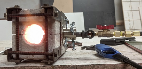

twigg Posted February 5, 2021 Share Posted February 5, 2021 Note to mods: I will be making a separate post about the forge seen in these pictures on another thread, and there will be a lot of overlap between the two posts. I decided to make this its own thread because there seems to be interest in small burners, and it's easier to search like this. Tonight I made my first crack at a 3/8" Frosty tee for my ~45 cu. in. two-brick forge. I think there's more gains to be had, but it performed really well off the bat. All pictures taken at 2 psi, with the orifice positioned as shown in the 2nd picture, almost poking into the mixing tube. Parts: 3/8 x 3/8 black iron tee 1/8 NPT x 1/4 flare fitting adapter 0.8mm 3D printer tip (surprisingly large!) 3/8" x 3" black iron pipe nipple I'm not including the stainless coupling on this list because it ended up being useless even once I tapered the ID. The methods used are identical to Frosty's T burner instructions, except the tap is an M6x1mm for the 3d printer nozzles and I tapped the hole for the printer nozzle in the flare side of the adapter, because I use NPT 1/8" for all my burner connections. I suspect this is a very non-optimized burner because a 0.8mm 3d printer nozzle is just as big as a 0.025" mig tip (same as you'd use on a 1/2" burner). I struggled right off the bat with this little troublemaker inducing too much air. That's why the orifice is jammed so far forward in the pictures. What I can say is it's screaming hot as is. At 2 psi it brought the hottest part of the forge to a mid yellow and seemed ok to forge with (mid orange). I didn't have time to see how hot it would've gotten at 5psi, but it was definitely toasty. As you can see in the 4th picture, I had to put the end of the flame nozzle about flush with the lining of the forge to get the flame to be stable. Once the forge got hot, I was able to back out the nozzle. Other thing I would say was that my fabrication tolerances were a mess tonight, but the burner was still pretty hot. On the first picture, you can see the flame is lobsided by the tempering colors on the nozzle. On the video, you can see it doesn't have a stable envelope. Still more work to be done! Edit: I live at 5500ft. That means air here is on average 80% of the density you'd get at sea level. I do all my testing in a heated workshop at 70degF, so there's no air density fluctuation with temperature. Link to comment Share on other sites More sharing options...

Mikey98118 Posted February 6, 2021 Share Posted February 6, 2021 To begin with, if I think you did it wrong, but "if it ends up right; then you wasn't wrong." Next, #D printer nozzles are going to rearrange small burner rules A LOT !!! Finally. what you may want to mess with is intenal sleeves (with internal bevels on the end that ends up within the fitting). Why? Because you can make your burner even hotter that way. And as Frosty keeps pointing out; make one change at a time. Link to comment Share on other sites More sharing options...
twigg Posted February 7, 2021 Author Share Posted February 7, 2021 Would center drilling a bevel in the inlet of the 3d printer nozzle do the same job as an internal sleeve? Link to comment Share on other sites More sharing options...
Mikey98118 Posted February 7, 2021 Share Posted February 7, 2021 Apples and oranges. The internal sleeve, with the bevel, is just a way to bring the burner inline with Frosty's instructions, since the middle opening in the ""fitting isn't the next size down from the two air entrances. I realize that you have to deal with the fittings you can get. Link to comment Share on other sites More sharing options...
twigg Posted February 7, 2021 Author Share Posted February 7, 2021 Ah sorry, by "fitting" I thought you meant the brass adapter. Now I understand you meant the tee itself. I'm still a little confused though. Does the sleeve go inside the mixing tube and extend just into the tee? Is it supposed to reduce the ID of the mixing tube? Thanks for bearing with me. I did start off with a 1/2 tee and a reducing hex bushing (because I didn't have a reducing 1/2" tee), but I went down to the 3/8 tee once I saw that it was inducing too much air. Link to comment Share on other sites More sharing options...
Mikey98118 Posted February 8, 2021 Share Posted February 8, 2021 It does go inside the mixing tube, and can extend just into the tee, or stop short of it; either way, so long as it is beveled. The point isn't reducing the ID of the mixing tube; that is just a fortunate side benefit in your case. The point is that the "T" fitting that Frosty designed his burner to be used with has a smaller center opening, and that difference creates a Funnel shape to be incorporated in that area of the casting. that funnel combines and interacts with the two air openings to create considerable swirl in the incoming air flow; this combines the air and propane together far more efficiently than would happen without it. How so is it convenient in your case? I truly believe your forge needs a 1/4" size burner to be happy, and this is a very easy way to turn your 3/8" burner into one; thats why! Of course its going to make Mikey even happier than you, to see a working 1/4" "T" Link to comment Share on other sites More sharing options...

twigg Posted February 11, 2021 Author Share Posted February 11, 2021 I made a nozzle and played around with some open-air testing, as well as testing different orifice sizes on the 3/8 burner. (I also made a kitchen-sink 1/4" burner, but I'm putting that in a separate thread for the sake of search-ability). Short version: yep, it's really friggin hot, even outside the forge with a crude step nozzle, and the turn down range goes below 0.5psi (measured at the tank, not at the accelerator!) So I found by happy convenience that I could take the stainless steel coupling I internally beveled and slide a length of 3/4" stainless pipe over it to make a very crude but effective step nozzle. The 3/4" pipe section was 1-1/2", and I put it 5/8" down the length of the stainless steel coupling (which was 1" long and had the same OD as a 1/2" pipe nipple). Took some tuning, but I was able to get the nozzle itself red hot. The placement of the 3/4" section relative to the fitting is critical. The other thing I noticed with this burner is that the turn down range extends crazy low. Below 0.5psi measured at the tank. The flame is most stable above 2psi, but it's still there. I have a feeling this is just a feature of 3D printer nozzles not having a long orifice like mig tips do (less length, lower friction, more flow per psi). https://youtu.be/nmbW6GNCQZQ Link to comment Share on other sites More sharing options...
Mikey98118 Posted March 13, 2021 Share Posted March 13, 2021 twigg, My apologies for missing this section until now. The flame in the video is too reducing, BUT the flame in the photo looks very promising Hope you keep at it. Your work is important. There are loads of people who want a forge this size, and yours is already the hottest I've seen. Being able to run your burner at 2.5 PSI is also very important, as it makes 1 lb. fuel canisters practical; all long steps in the right direction for jewelers and hobbyists. Link to comment Share on other sites More sharing options...
