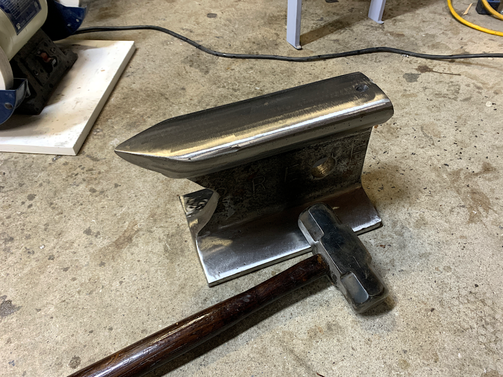

  3. So yeah... if someone had told me how tough rail road track is to cut/drill, i would have happily spent a small fortune on proper anvil. I found using a bit of paraffin wax on my portaband blade really sped up the cut rate to remove the large chunk but i've still got a long ways to go. I've found the top surface of the rail is especially hard and i've been having a hell of a time trying to get a 1/2" hole drilled in it. even my Viking m42 cobalt bit only makes so much progress before i gotta sharpen it again. ugh. What are these tracks made of? It's definitely not low carbon steel.

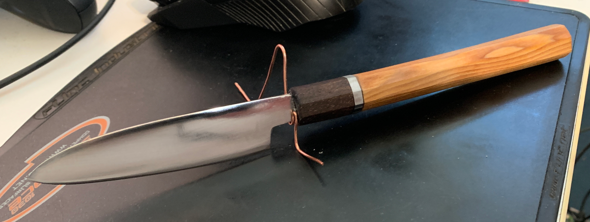

  8. Hmm... wasn't thinking when i started making this Sujihiki knife. My mini-forge isn't long enough to handle a 240mm blade. lol. It just needs a little more work and i can heat treat and temper it before final finishing. I'm starting to regret not turning this 5 gallon air tank i have into a forge. hmm.. Here is the knife in progress.
