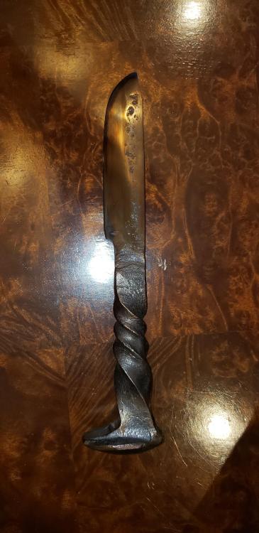

Good evening all I have a question about my next step. This is my second attempt at a knife and my first san mai so be gentle, I know it looks like a butter knife : )
I did a "traditional" san mai where I made a well in the spike and inserted a piece of high carbon then forge welded them together and drawn it out. If you look closely you can see where the high carbon is on the edge. At this point I've hand sanded it down to 600 grit and want to know whether I should temper it then etch or etch then temper?
Any comments, critiques or blasts are welcome.
Cheers!
Are you tempering in a vacuum furnace?  If not then the oxidation will occlude the etching.  Usually the finer grades of finishing is done AFTER heat treat.
We also do NOT suggest waiting to temper after hardening' I had a friend who hardened a blade late at night and decided to draw temper on it the next morning---it was in three pieces when he went down to the workbench in the morning.  Temper as soon as possible after hardening!
Also the blade should have been left at least at the thickness of a US dime before hardening and then tempering so a 600 grit finish is a total waste as it will get finish ground after hardening and tempering.
What you didn't mention was as Thomas kind of stated- is it quench hardened yet?
Thats going to preclude etching yet altogether. And I second Thomas on the tempering- as soon as possible... that high carbon is going to pretty brittle compared to the lower carbon steel in the spike.
Thanks Thomas I appreciate that. I'm tempering it now, hopefully it stays in one piece. I don't have a vacuum furnace, just a toaster oven so we'll see what happens there.

Good morning! So I finished tempering last night in my easy bake and it doesn't look too bad. I tempered at 425f for 2 hours. I'm a little concerned about the blue on the edge since it's pretty thin and really surprised about the straw on the spike. Can I assume the blue edge is from the spring steel insert? Interestingly enough the spike has an "H" on the head so I'm assuming it's high carbon.

From all the research I've seen, done, heard- even the "h" marked spikes are on the lower end of carbon content.
Doesn't matter now anyways if you forge welded in an edge. Lol...

"High carbon" rr spikes are still on the low end of carbon content for a good knife. Those are marked HC. Not sure what just the H stands for but not high carbon as far as I've ever heard. Certainly would expect it to be low carbon steel.

As for the tempering, the thinner parts will temper more and faster than the thicker parts. Or atleast in drawing color.
How is the hardness? Did it skate a file on the edge?

When they started using powered rr spike inserters they had to up the carbon content to make them resist bending with the power driving, so they brought them up to the border between low carbon and medium carbon steels.  You don't want high carbon in a spike as that also increases the brittleness. I live near a train track and I sure don't want brittle spikes failing and a train derailing and dumping ammonium nitrate, MEK, diesel, and chlorine out in a big mess!
Jason, heating the oil increases the quench rate. Cold oil can be viscous  and not circulate fast enough for a good quench. By heating the oil you lower the viscosity allowing the oil to circulate faster, thus pulling the heat out faster.
You could have lost some of the carbon in the insert to carbon migration. (Carbon diffusing from the high carbon to the lower carbon at welding temperatures.) That maybe why oil quench wasn’t fast enough, but it still hardened in water.

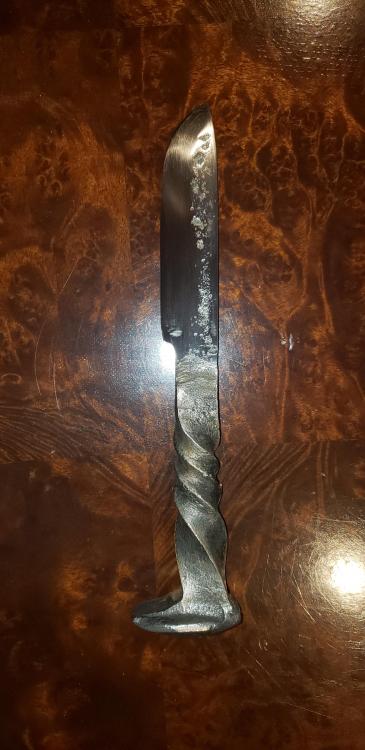

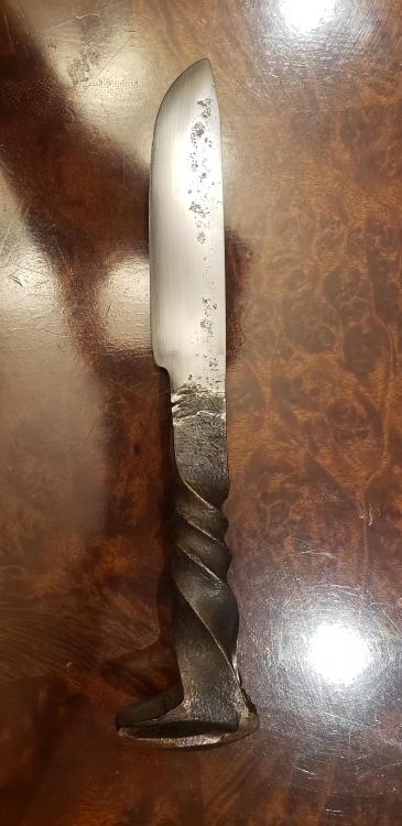

The ferric acid showed up today so I gave it a shot. It didn't turn out how I had hoped so hopefully you guys can give me some suggestions. I did a 3:1 ratio and dipped it a few times for 30 seconds then dipped it in water and cleaned it in between. I've also posted a picture of the spot where I need to improve next time when I'm making the well so the insert fits and welds better.
Unfortunately when I file tested it again is didn't skate so either I heat treat it again or start on the next one. Thoughts?20210112_181045.thumb.jpg.165de9dd80ce78f6ceaa059a432d0361.jpg
So it skated a file after hardening in water, now after tempering in who knows really what temp (close to what you think). it won't skate a file. I'm thinking it may not be hard enough to hold a good edge. Why not sharpen it up and use it a good bit to see how it holds up? It is a spike knife without added handle material, so if it performs poorly you could re heat treat later.
If you're looking for a good even darker color- leave it in for a couple minutes at least. 30 seconds might be enough to show you the steel differences, bring out a hamon line... but that depends on how good your dilution ratios were. Lol...
Like das said- I'd try sharpening it first and see how it holds an edge. If you don't like the results from there- then you have your decision to try and re heat treat, or start again.
