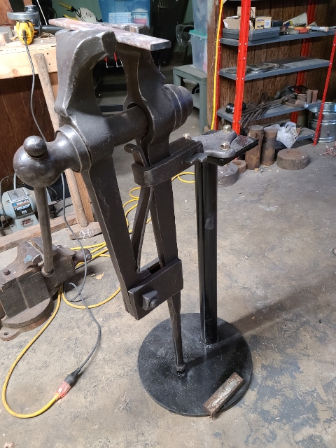

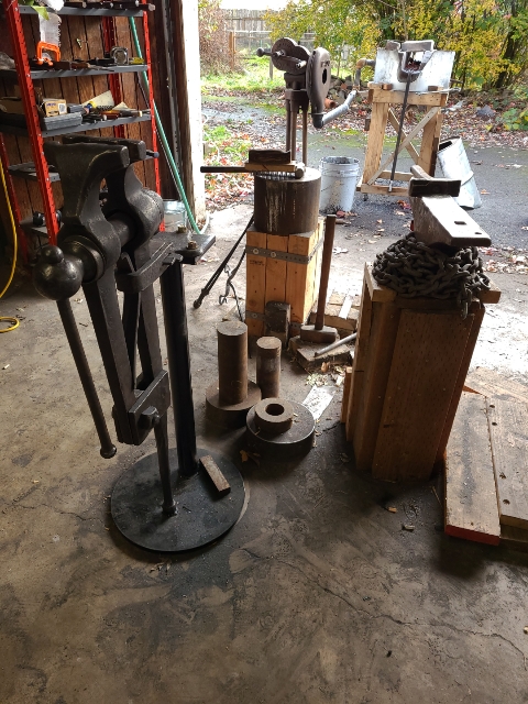

M.G. Posted December 10, 2020 Author Share Posted December 10, 2020 To all that have been following, I have finally gotten my vise stand put together and vice mounted. Here are some shots of the smithy and vice on its stand. It went straight to work! Quote Link to comment Share on other sites More sharing options...
ThomasPowers Posted December 10, 2020 Share Posted December 10, 2020 If the disk was large enough to stand on while using the vise it would act much more rigid. Quote Link to comment Share on other sites More sharing options...
M.G. Posted December 11, 2020 Author Share Posted December 11, 2020 Its true Thomas. I can usually get a foot on it to keep it from moving on me if I'm really torqueing on it. But as I sit here I realize that I may not always be able to do both stand on the base, and reach the end of my work piece. But looking around the shop I notice that I could just ratchet strap the stand to the leg of the wall anchored work benches if I really need it to stay put. I do like the mobility of it though. The whole set up is about 160 or 180lbs. So it weighs more than my anvil set up (as well as more than myself). When I eventually land my own workshop I will anchor to the floor. Or drive a post in to the dirt. But this is a borrowed space so im trying to be non invasive and mobile around the workspace. But over all, I am just super stoked that it is no longer laying down on the job, lazy sucker is finally holding its own weight. Hahahhaha Quote Link to comment Share on other sites More sharing options...
ThomasPowers Posted December 11, 2020 Share Posted December 11, 2020 There is much to be said for expediency. There is also much to be said for a vise that you can twist a RR spike in---cold; also for a vise you can access from 360 degrees---my next vise project, making a gozinta in the shop driveway for a spare 6" vise I have. Currently my most heavily anchored vise is attached to the utility pole that supports the middle truss in my "dirty shop". Quite stout, it was the one I twisted a RR spike cold in; but when you hammer heavily on stuff it "drives" the steel panel wall and lets the neighbors know you're working in the shop... Quote Link to comment Share on other sites More sharing options...
