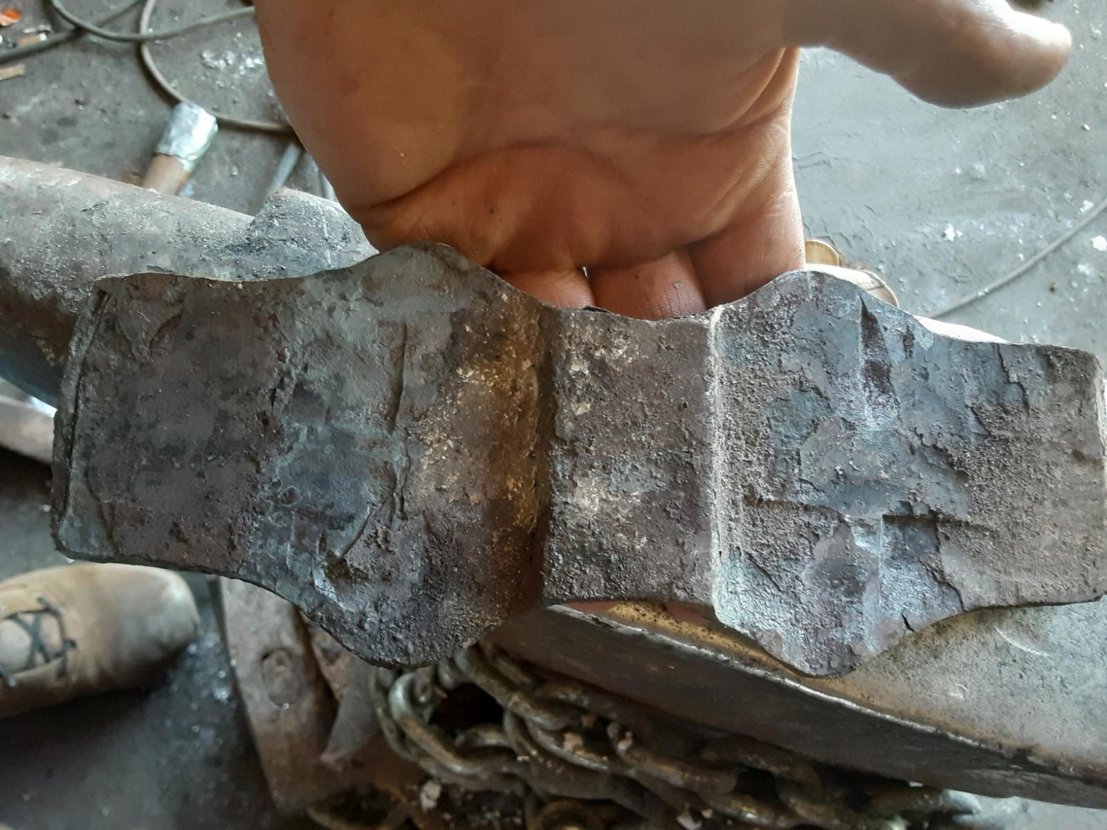

Small wrought iron steel faced hammer.
  • 2 months later...
This should not be taken to be a criticism on this hammer.  I’ve seen similar in pretty much every photo of a wrought iron hammer I have seen, including one by Jennifer and I don’t believe anyone would try to argue she is not skilled.
In a solid steel hammer the cracks and such would be concerns. What is a small crack now could spread and become a larger crack and eventually result in failure. Is this not a concern with wrought iron?

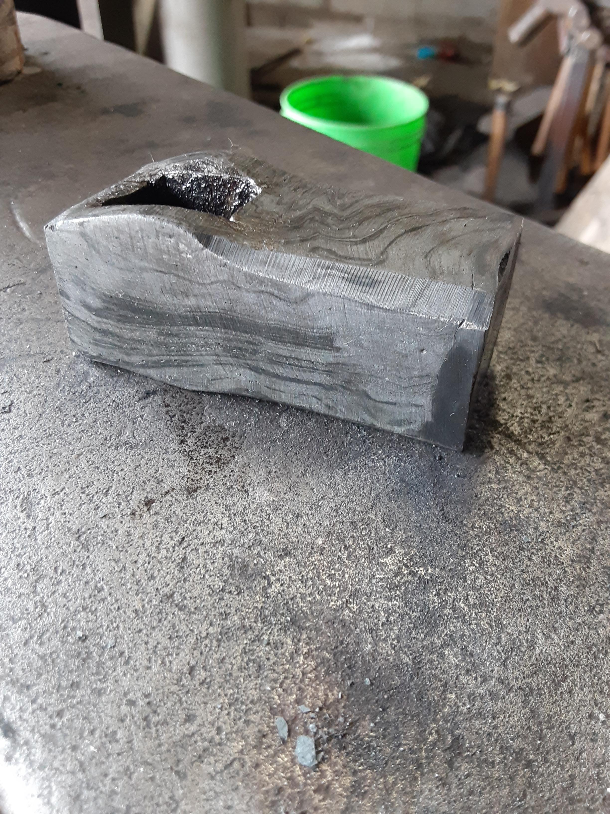

The 2.75lbs hammer build was upset from 1.125" sq wrought iron..   And currently have a dogs head hammer also upset from that same 1.125" sq wrought iron.
Technique and understanding of material plays in a lot..
Here is a shot of the wrought used on the hatchet.  You can see that the seams even in this bar are poorly welded.  You can see this very seem in the pole of the ax and where it wrapped around the sides..

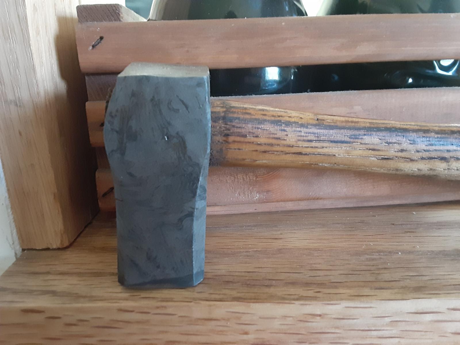

And some photos of the 4lbs hammer build which still is not finished as I can not decide what finial shape of want.  It started life as 1.125 sq with the bars notched folded over and welded.
then these do sections were then welded to each other to get the proper mass.
