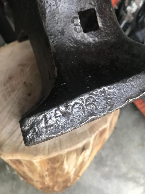

karcher.dc Posted February 16, 2020 Author Share Posted February 16, 2020 Haha... I may have put a 1 between the 5 and 0 that isn’t really there?... hard to tell, but if the number is 15067 then it puts it in the 1894 range if I’m not mistaken? Not that it matters, but it’s really interesting to me Quote Link to comment Share on other sites More sharing options...

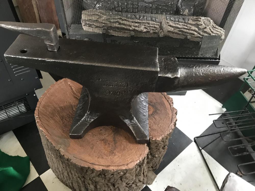

karcher.dc Posted February 18, 2020 Author Share Posted February 18, 2020 so in response to JLPSERVICESINC, I think mine may be a gen1 based on your description. See the attached images. First, it seems like there is a weld seam about 3/4” under the face, which would explain a hardened steel face on a wrought iron base. See the pics of me pointing that out. Second was I cleaned up the serial number, and it looks more like ‘4506’ now? You be the judge... there is also a 3 stamped on the front under the horn. Quote Link to comment Share on other sites More sharing options...
jlpservicesinc Posted February 18, 2020 Share Posted February 18, 2020 If you can take a photo so the anvil is in full frame.. Also is the anvil hollow in the bottom? Quote Link to comment Share on other sites More sharing options...
karcher.dc Posted February 18, 2020 Author Share Posted February 18, 2020 Quote Link to comment Share on other sites More sharing options...
jlpservicesinc Posted February 18, 2020 Share Posted February 18, 2020 Sorry, I meant a direct side view.. But that looks like a first Gen.. Quote Link to comment Share on other sites More sharing options...
karcher.dc Posted February 18, 2020 Author Share Posted February 18, 2020 i can get one after work. but I agree with you based on your initial post. I also believe it is pre 1900's. Quote Link to comment Share on other sites More sharing options...

Irondragon Forge ClayWorks Posted February 18, 2020 Share Posted February 18, 2020 Serial # 4506 would put it at 1893 according to AIA. Quote Link to comment Share on other sites More sharing options...
jlpservicesinc Posted February 18, 2020 Share Posted February 18, 2020 I love the evolution of the Hay Buddens.. really within a fairly short time you can kinda see the thought process take hold.. I often wonder which ploy they were after.. Again being a history nut, and speculations.. the early wrought anvils with steel faces all pretty much were the same.. Nearly the same thickness in face and personally have not seen any larger ones but up to about 200lbs or so. So, mainly made of of a lot of forged sections which wrought iron as we know welds really nice and easy. the face plate being slightly easier with wrought iron too. Huge labor factor.. then you move into the 2 piece design which I know a one piece of steel is more durable and longer lasting with no chance of faceplate separation.. but also the design change overall. The waist is now made thinner as is the tail section.. they also forged the bases from bars layered and cut on the anvil all stacked up and the base was "HOLLOW". Anyhow.. My point was were they simply trying to save on labor. (They had some labor disputes) or was it something to do with the welding of the crucible steel that lead to the narrower waist? If the waist is small enough and welding temp wrought iron bars are put on time and time and time again in quick succession the anvil would not have to go back in for another welding heat and can be applied pretty quickly.. the other thing that is pretty cool is they started with blocks of steel and forged out most features while using a butcher tool.. At least on all the ones I have seen.. Anyhow.. Its just cool.. Quote Link to comment Share on other sites More sharing options...
karcher.dc Posted February 18, 2020 Author Share Posted February 18, 2020 I am very happy in this purchase, and like you i think the history with them is awesome! I cant believe the shape it is in for being 120+ years old.. Quote Link to comment Share on other sites More sharing options...

karcher.dc Posted February 22, 2020 Author Share Posted February 22, 2020 Update- got the anvil setup this morning, got it sitting on a solid red oak stump and leveled it, removed bark and oiled up.. face of the anvil sits exactly 30” from the ground and is super solid.. Quote Link to comment Share on other sites More sharing options...
