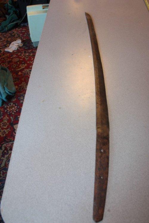

Steve Shimanek Posted December 21, 2019 Share Posted December 21, 2019 I recently bought this from another blade smith, who took it in trade for some blade work. He said it had been used for brush cutting by the person he got it from (not the best use obviously.) The photos show a lot of problem areas, not the least of which was the amateur grinding to "sharpen" it; 2 major delaminations near the sharp edge, 6 or 7 major bends, reduced point area, etc. The shape pointed to a potentially old sword, so i took a gamble on it, though i didn't pay much for it. After a couple of sessions with the roughest traditional water stone, I believe it to be an older traditionally made blade. The first photos are from the seller, as it arrived; i will post additional photos as the work progresses. Nihonto are a specialized area; i do not recommend just anyone to try their hand at restoration. Link to comment Share on other sites More sharing options...

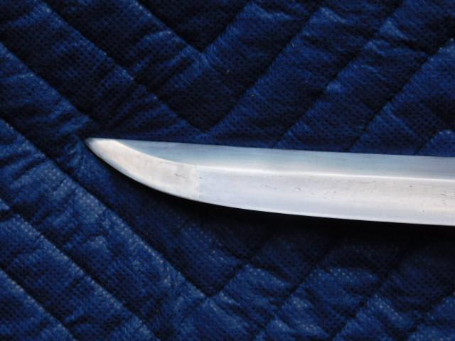

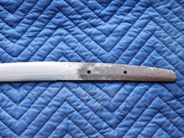

Steve Shimanek Posted January 5, 2020 Author Share Posted January 5, 2020 Lots of challenges on this blade due to condition and abuse....blade was straightened, proper geometry restored, and brought to the best condition possible. Rescued from the fate of being turned into a tanto or cut up and restacked by the previous owner, and being used to cut brush by the owner before that. Seems to be a Sue Bizen kazuuchimono mass produced blade from the mid 1500s. Last 2 photos.... Link to comment Share on other sites More sharing options...
tanglediver Posted January 5, 2020 Share Posted January 5, 2020 That is a big improvement! "Watcha gonna do with that 400 year old sword?" "Mmmmm, cut the hedge back some, maybe clear some weeds." Link to comment Share on other sites More sharing options...
Steve Shimanek Posted January 5, 2020 Author Share Posted January 5, 2020 It is a bit tired and beat up, but deserving of being treated with some dignity and respect; this is the second blade i have I have bought /rescued with the help of the same bladesmith. The other one has turned out much better as the starting condition was not as bad. Being in the Pacific Northwest, he comes across these blades and i am in the right place to acquire them on occasion. Link to comment Share on other sites More sharing options...
pnut Posted January 5, 2020 Share Posted January 5, 2020 The maker was what I was curious about. Could you please post a picture of the characters? Pnut Link to comment Share on other sites More sharing options...
Steve Shimanek Posted January 5, 2020 Author Share Posted January 5, 2020 I do not think it is signed by a maker; either it is obscured by rust, signature was cut off when shortened, or it was never signed... when more rust is removed i will be able to see if there is a signature, but it is doubtful. My guess as to manufacture is posted above and is the best i can do currently. Link to comment Share on other sites More sharing options...
Bo T Posted January 6, 2020 Share Posted January 6, 2020 I might be imagining it, but there seems to be a slight 'quench line' above the edge? Especially towards the tip? Link to comment Share on other sites More sharing options...

Steve Shimanek Posted January 6, 2020 Author Share Posted January 6, 2020 14 hours ago, Bo T said: I might be imagining it, but there seems to be a slight 'quench line' above the edge? Especially towards the tip? Bo T; there is a hamon and boshi (hardened tip and edge) on the sword, but it is difficult to see unless you know what to look for.....most hamon are more obvious, but this one may have faded from excess heat when it was abused by grinding, or never had much visual pop from the beginning when it was made...it is hard to say which. As to the lack of signature: is is possible that this sword was longer when it was made, and the signature was lost when it was shortened; or, it was never signed at all and was issued out of an armory for the cannon fodder troops; or, there may be a signature hiding under all of the rust. Thanks for the comments. Link to comment Share on other sites More sharing options...

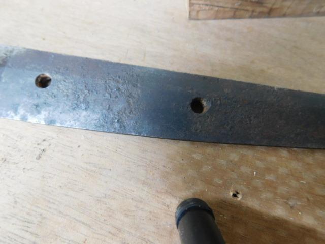

Steve Shimanek Posted January 16, 2020 Author Share Posted January 16, 2020 The rust on the nakago (tang) was excessive, so i used a couple hours of electrolysis to reduce and stabilize it with a decent result: Link to comment Share on other sites More sharing options...
Irondragon Forge ClayWorks Posted January 17, 2020 Share Posted January 17, 2020 Looks good to me, too bad no sign of signature. Link to comment Share on other sites More sharing options...
Steve Shimanek Posted January 18, 2020 Author Share Posted January 18, 2020 Indeed; if it ever had one, it was lost when it was shortened (o suriage). Thanks very much. Link to comment Share on other sites More sharing options...
