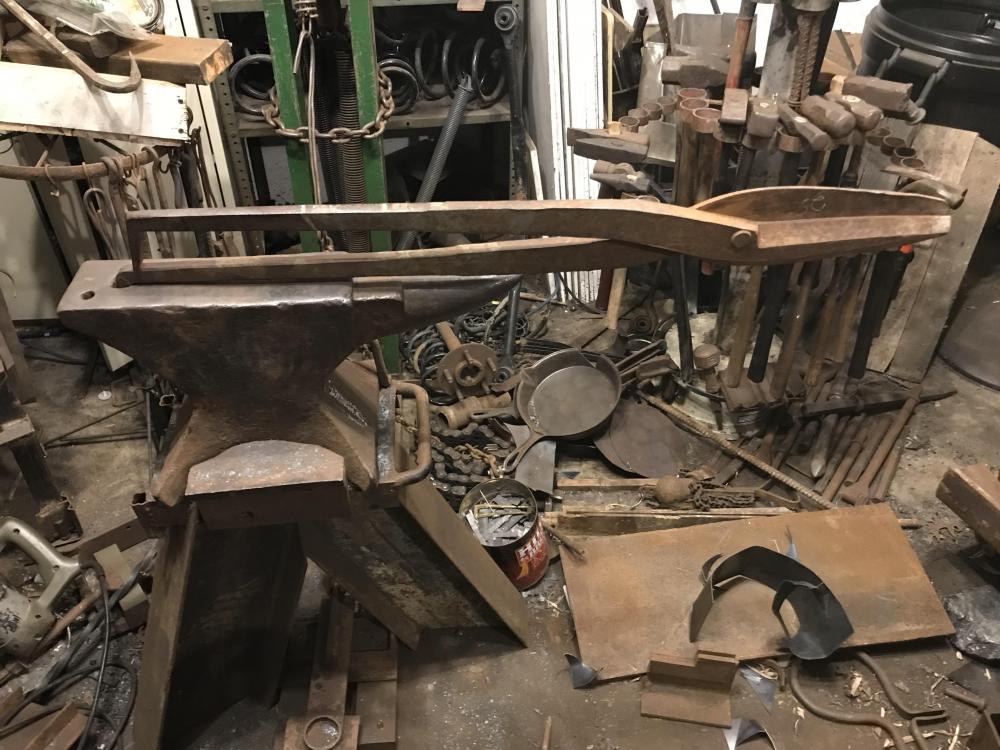

MC Hammer Posted October 10, 2019 Share Posted October 10, 2019 I was given a pretty heavy and long pair of those tinsmith shears that have the ends that will fit in your anvil hardy hole. I know they are used for sheet metal, but would using them to hot cut thinner metals remove the temper of the shear blades and ruin them for their original purpose. Has anyone here used them for hot cutting? I can see them being useful for cutting thinner stock for ornamental work instead of using a chisel. Just thought I'd ask since most people mistake them for a blacksmith tool. Quote Link to comment Share on other sites More sharing options...

Frosty Posted October 10, 2019 Share Posted October 10, 2019 You sure they're they tin snips MC? Have a pic? Frosty The Lucky. Quote Link to comment Share on other sites More sharing options...
MC Hammer Posted October 10, 2019 Author Share Posted October 10, 2019 Frosty: I'll take a picture tonight, but these things are dang heavy and over 3 feet long. Pretty heavy duty. No doubt I could probably cut cold stock up to something like 1/16 of an inch. I guessed they were tin cutting shears based on what I found on the internet, but I think they could cut steel as well. Quote Link to comment Share on other sites More sharing options...
JHCC Posted October 10, 2019 Share Posted October 10, 2019 Like this pair? I use mine for sheet up to about 16 gauge. While I'd prefer a Beverly shear, these are plenty good for their designed purpose. I'd keep them as-is. Quote Link to comment Share on other sites More sharing options...
Latticino Posted October 10, 2019 Share Posted October 10, 2019 12 hours ago, MC Hammer said: Has anyone here used them for hot cutting? I expect the shear edge on these snips is high carbon steel that has been heat treated. If used for hot shearing you would most likely ruin the heat treatment, softening the edge and making them less useful for their intended purpose. Quote Link to comment Share on other sites More sharing options...

MC Hammer Posted October 10, 2019 Author Share Posted October 10, 2019 JHCC, yes those are the exact shears that were given to me. Look to be the same size too. Heavy as heck. Nice to know I can cut up to 16 Ga sheet metal with them. I won't use them to hot cut anything. I feared exactly what Latticino said above and figured I'd ask around and see if anyone used them for hot cutting. Sometimes you can get away with things and usually others will know. I still like them and the price was right Quote Link to comment Share on other sites More sharing options...
Charles R. Stevens Posted October 10, 2019 Share Posted October 10, 2019 A hot shear cam be built from an old grader blade. Cut a hunk that fits on your anvil, weld it to a hardy shank, cut a matching hunk and punch both peases for a pivot and instal a handle on the upper. So you can give it a good smak with your hammer. Quote Link to comment Share on other sites More sharing options...
ThomasPowers Posted October 10, 2019 Share Posted October 10, 2019 I remember that shear was in one of the blacksmithing books I have. (Country Blacksmithing? I'll have to check this weekend.) John; I feel a much greater affinity for you after seeing that picture of your shop. To misquote Vespasian: "Scrap doesn't stink!" Quote Link to comment Share on other sites More sharing options...
