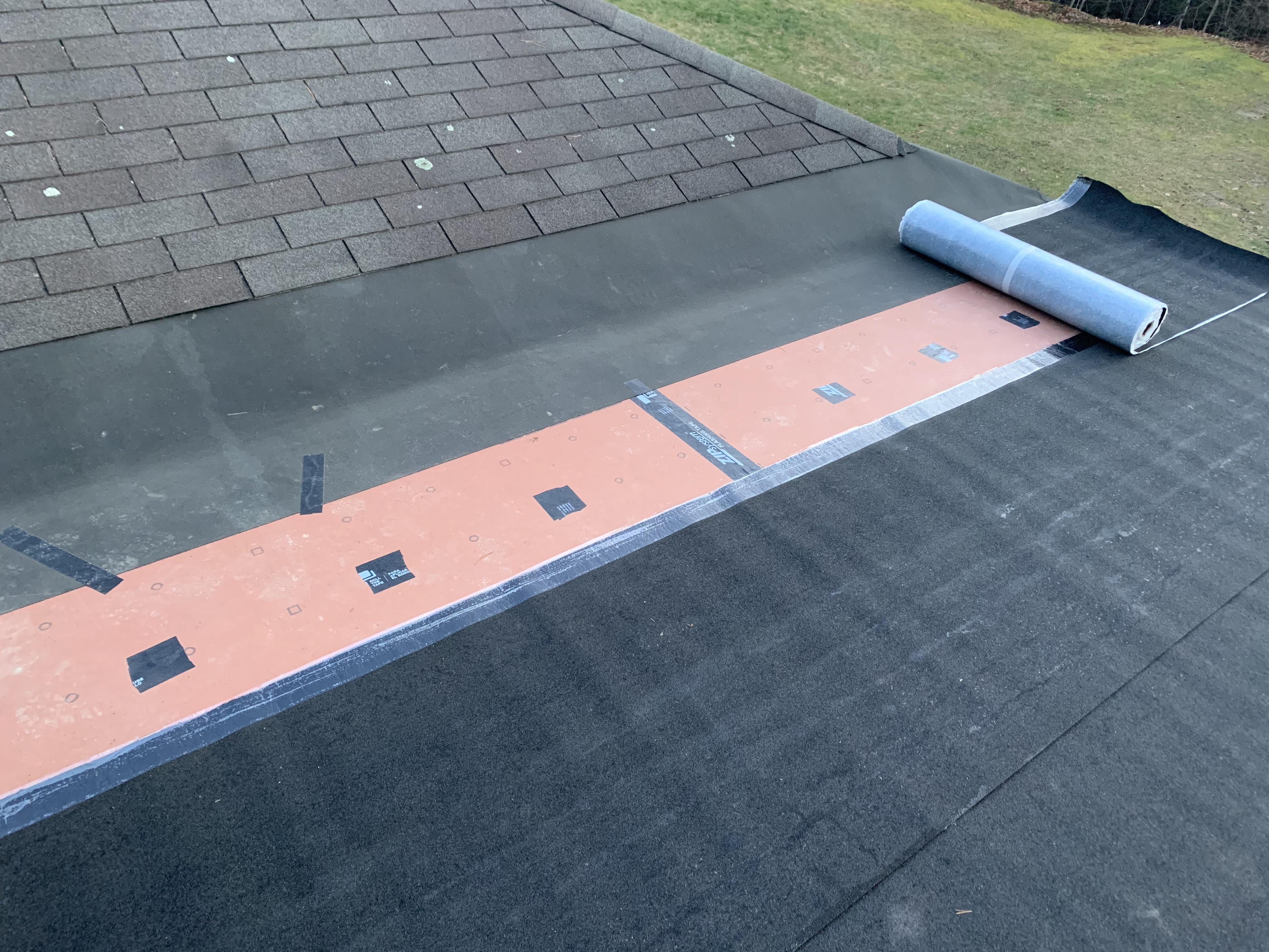

It’s almost flat with 2x10 rafters and sealed plywood. Possibly asphalt shingles, maybe a tin roof
  • Replies 64
  • Views 11.3k
Looks like you should have plenty of structure under it. When I hear Maine I think feet of snow!....:D. A state I have always wanted to visit, it sure sounds lovely up there.
I will mention shingles and flat don't do well together. If I recall correctly they like to see a 4/12 pitch or more for them.
Good news and bad news. Good news, the rafters and zip boards are all up. The bad news is the hack who built the garage did nothing properly, from stapling on the overhanging drip edge the not having rafters and studs (none of them) 16” on center, which means that we had to space the rafters all funny.
From the land of the desert sun, flat roofs and LEAKS ABOUNDING!  Please put a pitch on it!
Ah yes "vernacular architecture"!  When I was looking for a house to buy I toured several old adobes that didn't have any 90 degree corners in them---not floor to wall, wall to ceiling, not door frames. So non euclidean I started watching for the Innsmouth look.
Asphalt shingles is not an option I would recommend. Most manufactures require a 4/12 pitch, but may reduce that to 3/12 if you use ice guard and reduce the shingle exposure.
Your roof looks to be a 1/12 pitch or less. If it is that flat screw down metal roofing is also not recommended. A concealed fastener standing seam roof may be ok if installed and flashed properly. Standing seam will probably require a layer of underlayment (synthetic felt is the best) of a slip surface over the Zip panels to maintain warranty.
With how flat it looks, I would think a rubber roof (fully adhered) would be your best bet. Removing the shingles on the existing and extend your rubber at 24-30 inches would be best.
As Marcusb mentioned snow load would be a concern of mine. Almost more so ice loading could be a big problem depending on how you insulate the roof.
snow load isn't a problem due to the rough cut 2x10 rafters, which should hold the snow we get each year just fine. I'll talk to my dad about just using rubber, but he wants to do shingles. The pitch definitely isn't changing now!

Matching up with a shingle roof snow load isn't up to the rafters to deal with. Freeze thaw will cause water to flow under the uphill shingles then freeze and peal them off the roof. This is a B A D thing. I'd seriously consider pealing up the bottom several feet of shingle and laying Grace water shielding starting on the existing roof and extending to cover the entire new one. And that's JUST the water proofing under the roofing.
I suppose it's getting too late in the season to take the existing shingle roof off completely and extending the new roof to the old peak?
  • 3 weeks later...
That’s exactly what we did Frosty. There’s 5/8 ZIP board screwed down covered at every opening with ZIP tape. Then proper flashing and drip edge and then Grace with asphalt (not shingles) on top.
Nice, aught to be snug and dry. It's funny, I haven't put a roof on since the early '70s. and it came back pretty well. Close enough I'd know where to look up the details anyway. When I said shingles I meant asphalt. I've never done a shake roof I don't think the guy I roofed with back then had done one either.

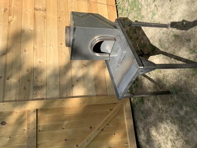

Well, I got my forge yesterday. My thanks to Bob Lavoie of the NEB for building me this forge. I’ve got a couple hundred pounds of anthracite coal sitting in the shop, so now I’m just waiting for my electric blower to get here so I can start forging. Any tips on using anthracite?
Really nice looking forge.
Thanks Irondragon. Also, my forge walls are made of 1” thick dry pine shiplap. I want to run a 10” pipe out through the walls for my forge chimney. Do I have to insulate around the pipe or do anything special to prevent a fire?
Take a look online for stove pipe and fittings. We used to call wall penetration fire spacing, "Wall Jacks" but I don't think we knew the real name back when. The outside will be called flashing and is designed for a water tight wall penetration.
Everything you'll need is available I just hope the prices don't make you choke too badly. No need to buy fancy stuff a forge won't need double or triple wall pipe. The wall jack should take care of that safety issue.

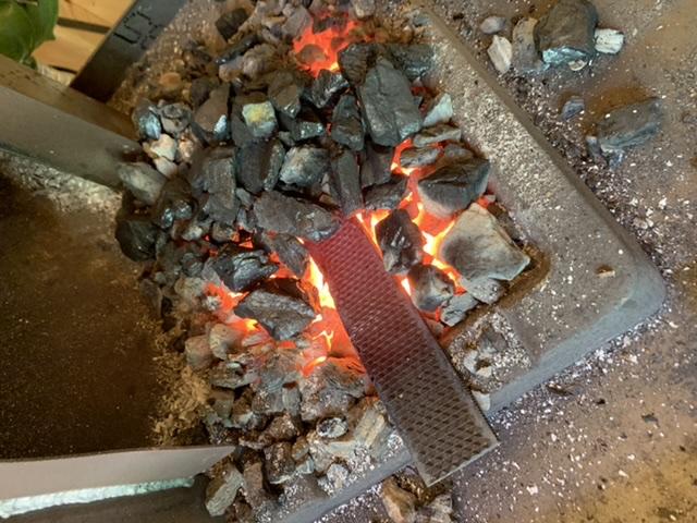

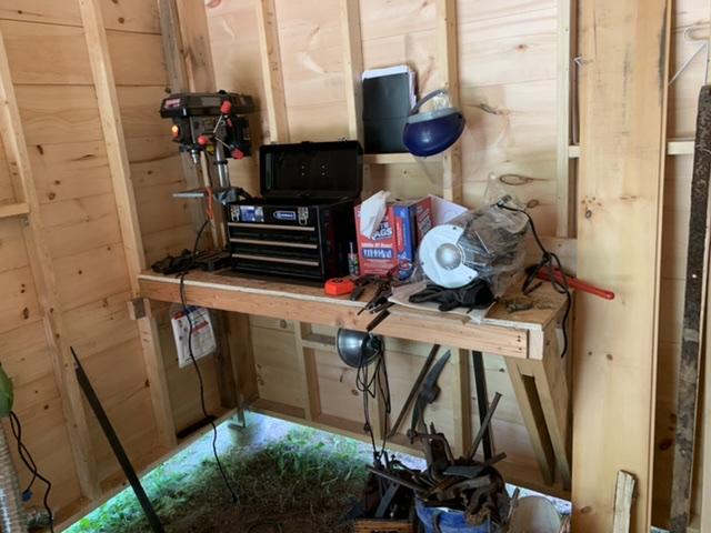

The forge has been working very well over the past couple weeks. I’ve learned to light the anthracite with just paper and wood, which is good. I even made a nail! Not a very good nail, but still. My dad and I also got a bench built and another couple in the works.
Also, what do you do with clinker? I have a 3 gallon bucket full of it, and I’m gonna need to dump it soon.
Do you have a gravel driveway, icy walks in winter? It's pretty non-toxic on any scale a landfill shouldn't have a problem, less than with dumping burn barrels.
