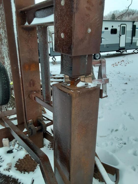

Ted Ewert Posted November 6, 2019 Author Share Posted November 6, 2019 Got a little more work done on the hammer. I built the hammer guide and attached it. I also go the hammer finished, as you can see. I built it out of 1" solid square stock which I cut to 12", with the middle piece being used as the attachment rod. I welded a pre-drilled and tapped face plate on the end. This was made from 3/4" plate. I also added two 1/8" sheet metal pieces to the sides of the hammer for the primary wear surface. I made the roller assembly with a couple of nylon rollers. They seem to work pretty good. I have a piece of 4140 coming to make the dies out of. It's 1" thick by 2" wide by 12". I should get a few good dies out of that. I just have the foot control for the clutch to finish, and a few other odds and ends, and it will be ready to test. Quote Link to comment Share on other sites More sharing options...

Ted Ewert Posted November 22, 2019 Author Share Posted November 22, 2019 Well, I got it running. It smashes hot steel as expected, although a few changes are in order. You guys were right in saying it's a little slow and I'm going to remedy that with new pulleys. The belt and pulleys I have on it now are undersized anyway. The belt gets pretty hot after only a few minutes of use. Any suggestions? I also need a stronger spring to hold the foot petal up. All I could find locally was a screen door spring and it aint cutting it. Nevertheless, the hammer hits good and hard. I made a couple of flat dies for it out of 4140, which I hardened and tempered. They don't make a pretty mark in the metal but they do give me some idea of how it's working. I'll build some fuller dies next. Here's a few pics. Sorry for the clutter in the background, I had to move a lot of stuff around to shoehorn this in a corner next to the forge. Got it all bolted to the slab Quote Link to comment Share on other sites More sharing options...

Frosty Posted November 22, 2019 Share Posted November 22, 2019 A real hardware store might have usable springs, a big box is unlikely to. Check in the auto supply for "belt dressing" we used to get it in sticks with a texture like a bar of soap, then later in a spray can. A slipping fan belt glazes and gets slipperier the dressing takes the slick off. In a pinch a bar of soap works for a while just touch the moving belt, don't press just a touch. If you put too much of any dressing on them they slip worse riding on a layer of dressing. Rosin works too. Frosty The Lucky. Quote Link to comment Share on other sites More sharing options...
ThomasPowers Posted November 22, 2019 Share Posted November 22, 2019 Ahh it's using a slipping belt clutch---do you want to make it stickier????? If one screen door spring doesn't work; what about several? Easy to adjust by adding/subtracting them. Too stiff an action and it's a pain to use. Quote Link to comment Share on other sites More sharing options...
Ted Ewert Posted November 22, 2019 Author Share Posted November 22, 2019 TP: Yes, it's a slip belt clutch and I started smelling burnt rubber. I'm going to order new pulleys to speed up the BPM anyway, so I was also going to get a thicker belt size. I'm using a 4L currently and the clutch is anything but smooth. Maybe it's not sticking well enough or it's just undersized. The belt was too hot to touch. I don't have enough experience with this type of clutch to really know what's best. Maybe belt dressing, as Frosty suggests, is the answer. My gut just tells me it's too small. I did think of adding another spring and that may be the easiest option. I may also have a trampoline spring or two around. It's not a big issue anyway. Thanks all for the suggestions! Quote Link to comment Share on other sites More sharing options...

Ted Ewert Posted November 24, 2019 Author Share Posted November 24, 2019 2 hours ago, Steve Shimanek said: Please do. The reason I hesitate is because I don't have it running the way I would like it to run. I can show you how it's running currently if you like. It smashes metal well enough, but it isn't smooth and efficient yet. The problem with a crank in this application is that it has widely varying loads throughout the cycle. This results in uneven clutch loads, which is why my clutch doesn't work well and possibly why the belt heats up. A flywheel is the most practical solution, which I plan to install on the crankshaft. My belt is also stretching, so I am going to make an adjustable motor mount. This will also be handy if I decide to change pulleys. Quote Link to comment Share on other sites More sharing options...
Ted Ewert Posted November 24, 2019 Author Share Posted November 24, 2019 My belt is so stretched that the hammer barely worked, but you can see the basic operation. This is why I was a little reluctant to post a video. The hammer needs some more work. MVI_2560.MP4 Quote Link to comment Share on other sites More sharing options...
Frosty Posted November 24, 2019 Share Posted November 24, 2019 On 11/22/2019 at 6:58 AM, ThomasPowers said: Ahh it's using a slipping belt clutch---do you want to make it stickier????? Dressing is not to make belts sticky it's to prevent glazing from excessive slipping. The problem with this type slip clutch is the idler pully is pushing into the space between the master and slave pullys. You can mount the clutch idler inside the belt so it pulls outwards. This lets you include a turn buckle in the clutch linkage so you can adjust for stretching and it has considerably MORE adjustment room. The belt surface area is smaller and rubs less as the clutch tightens so there is less glaze and heat stretch. You do need to use another V belt pully for the clutch idler or it'll roll the belt over and off. Yeah, that belt's shot Ted, it's meeting in the middle. I don't think single V belt are going to be very long lived but darn are double V pully's expensive. The motor's jumping a little too. Looks like she hits pretty hard, just needs some refining is all. Ain't tweaking a machine fun? Frosty The Lucky. Quote Link to comment Share on other sites More sharing options...
