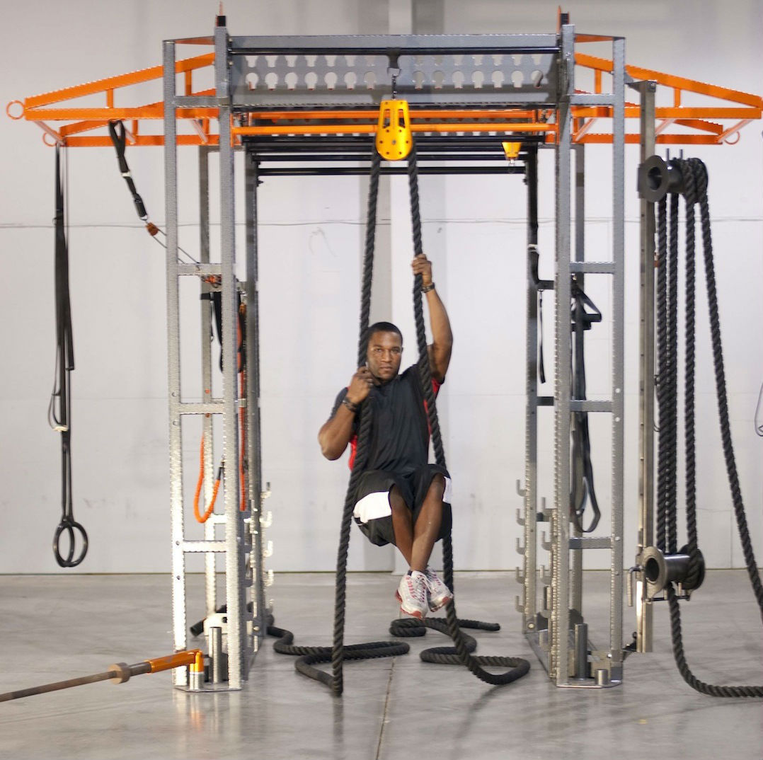

on the net I have seen some examples seemed scaffolding for construction site, of those homemade were almost all in wood, obviously it is not a structure for public gym but for an acquaintance of mine who has the hobby to train at home, I do not find the right design with the right reference measurements, if I make the hooks too far apart, I risk that when I hook the bar in the trimming phase, it does not grip and therefore you fall ruinously, I would like to know the right distance between the hook and the hook and the right distance between the hooks right proportions, we would like to do it in metal maybe tubular what do you think?I saw one that was attached to a structure called a power rack

thank you for the valuable advice and clarifications, I evaluated everything and will try to take the right solution, my friend told me that he wanted to find an old scaffolding type scaffolding on which to build the power rack structure and fix the salmon ladder on it and others tools, like the pulley and also use it as a support for the barbell to lift weights on bench thanks, even if you had other ideas to draw inspiration from, I invite you to write thanks again

The salmon ladder could serve more than one purpose, it could also hold bar bells. The clevis on the top cross member of the salmon ladder that holds the safety line is perfect to hold a safety line on the barbell so it can't fall and hit the lifter. Make sense?
How many work out stations does your friend want? If he wants you to build a salmon ladder that attaches to one he plans of buying you'll need to be able to take measurements and find out how to attach it.
On the other hand if he wants you to build a salmon ladder as a stand alone station there are other issues and lastly if he wants you to build a large frame so he can attach other work stations it's a whole different multiple part problem.
