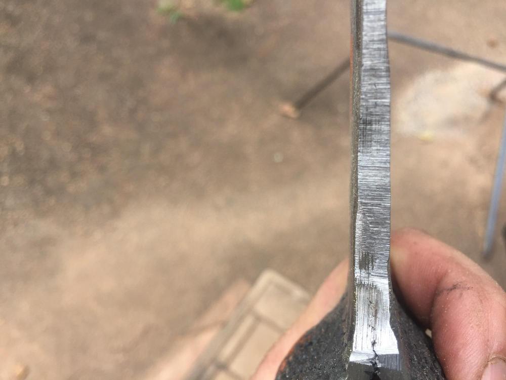

Gleen it is mild steel started 1/2 thick making an ax and putting a bit into it but can't get get mild to weld. I started but grinding everything nice and clean got it red hot brushed fluxed and put it back in until it was a bright orange took it out and gave it a few taps, brush flux and back in. I did this 3 more times and nothing so stopped opened it back up and am going to grind it clean again.

Yes propane that is correct, it is a Devil 2 burner I am using Borax as a flux and did more taps than blows to try and set the weld. As for the temp I couldn't tell you how hot it is I don't have anything to measure the temp. I think I will put a mild steel bar into the forge with it when I think it is close try and bump them together to see if they stick so I can get an idea of the temp. Thanks for the welcome and I will take a look at the link.
Try precleaning your surfaces to remove mill scale.  You need to get up to yellow/almost white to forge weld mild steel.  Was your flux boiling on the surface?  Do you have doors for your forge?

Thank you and JHCC for the response. As for the forge I did put refractory over the blanket and am getting ready to add more do to it starting to flake. I do have a door on one side and have fire bricks blocking the other to get it to heat quicker, about a one inch gap at the top of the forge. It is a mild to mild steel weld with a 5160 bit but haven't got to try and put it in yet! LOL I will give it a try aging next week think I need to step back for a few days from it for now. Going to the local fab shop and check and see if they have any tool steel large enough for me to drift and draw out. Any suggestions on what would be a good steel for it would be appreciated.

When I first started out and before I got some good hands-on guidance, I really struggled with forge welding in my propane forge. Turned out I simply wasn't getting the steel hot enough. As soon as an experienced smith had showed me the lemon yellow I should have been aiming for, I cranked up the forge, blocked the doors and did it first time. No problems after that so persevere and you'll get it.

When getting started take a piece of 1/4" mild rod and point it and heat it in the forge.  When it wants to stick to workpiece when you prod it, then the workpiece, (and rod),  is up to welding temps.
Thank all for the response I am going to try the 1/4 then I will know the color. As for learning from someone that would be outstanding and am going to a Guild on their next meeting distance is my problem but might find someone who lives closer to me at at the guild.
Very happy to report that I was very successful at a forge weld today! Made my first rasp Tomahawk and the weld is fantastic! Thank all of you for the advice, I just wasn't getting it hot enough. Again thank all for the help!
