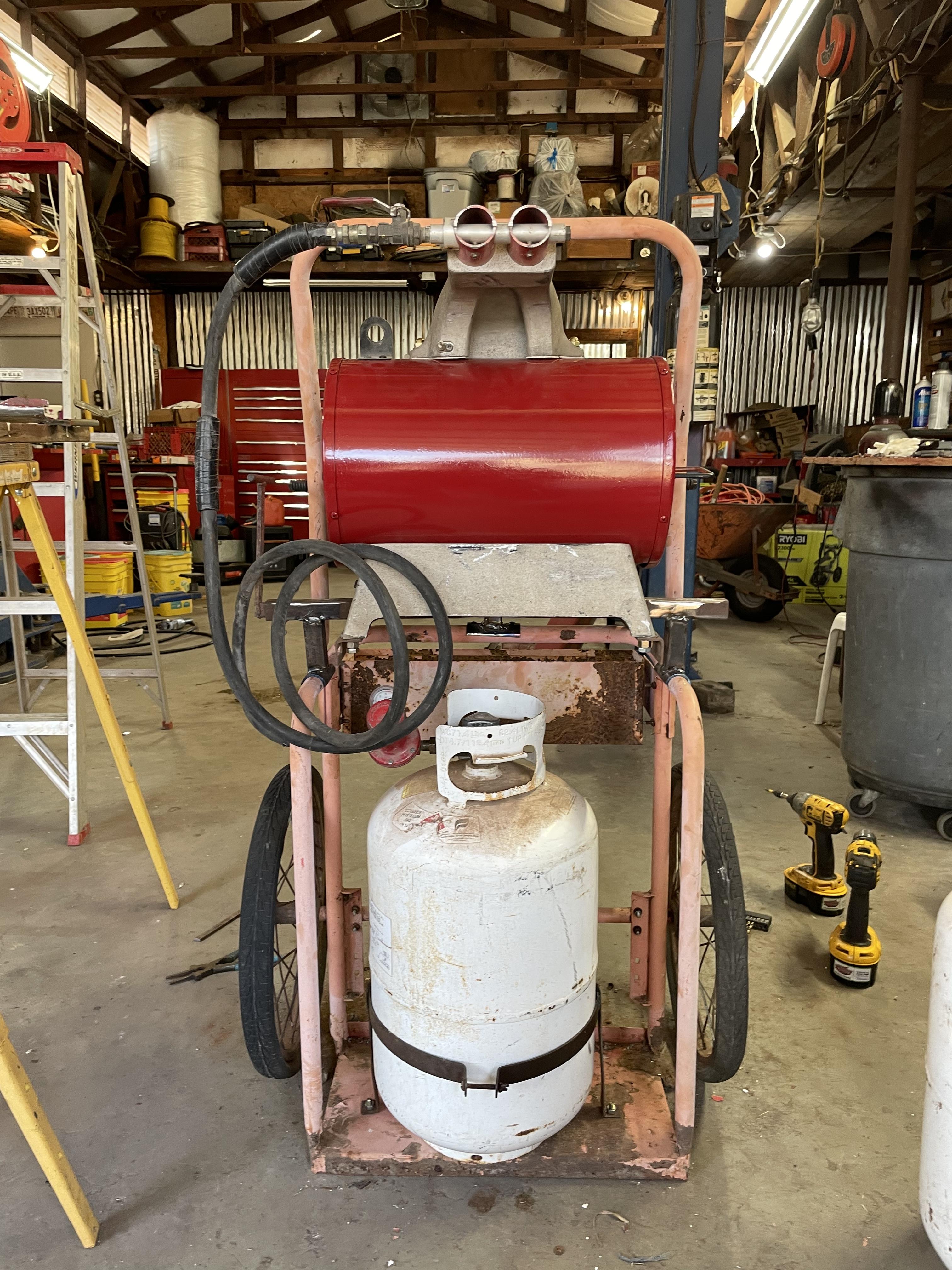

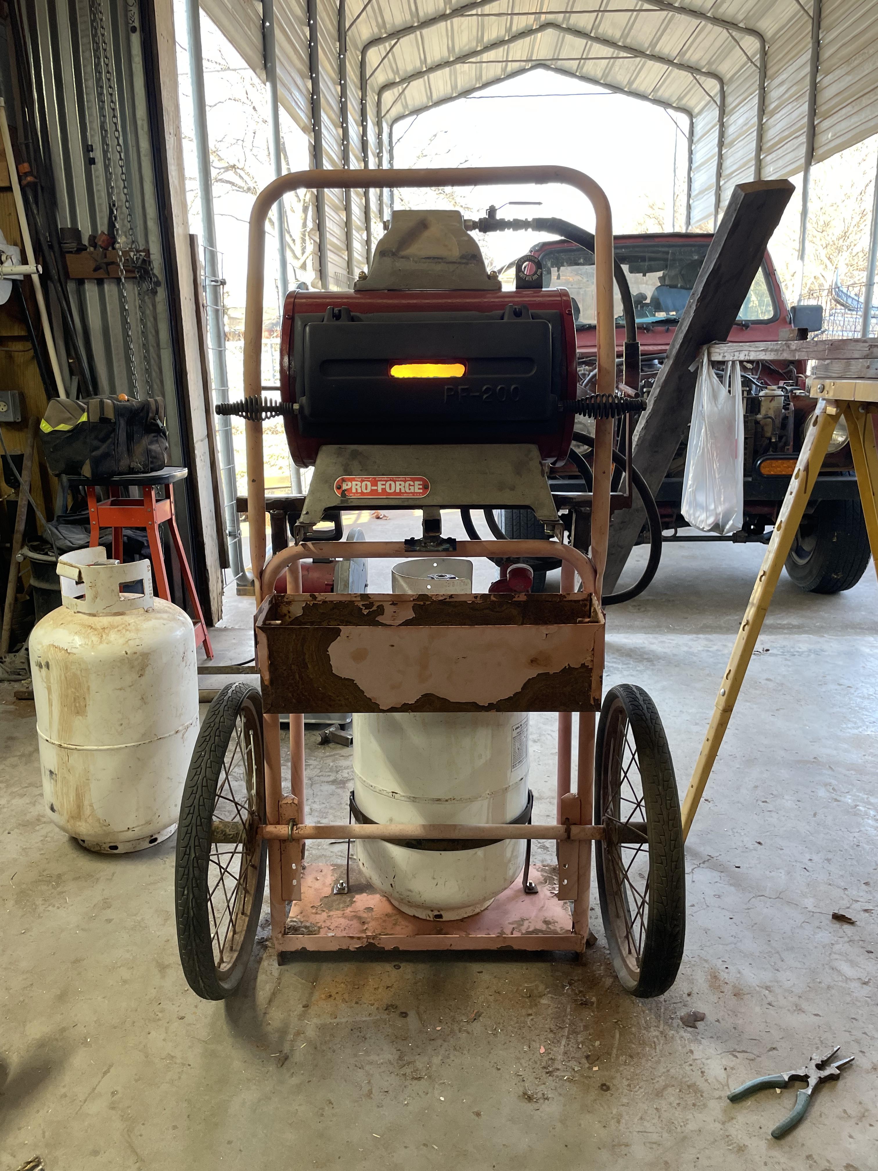

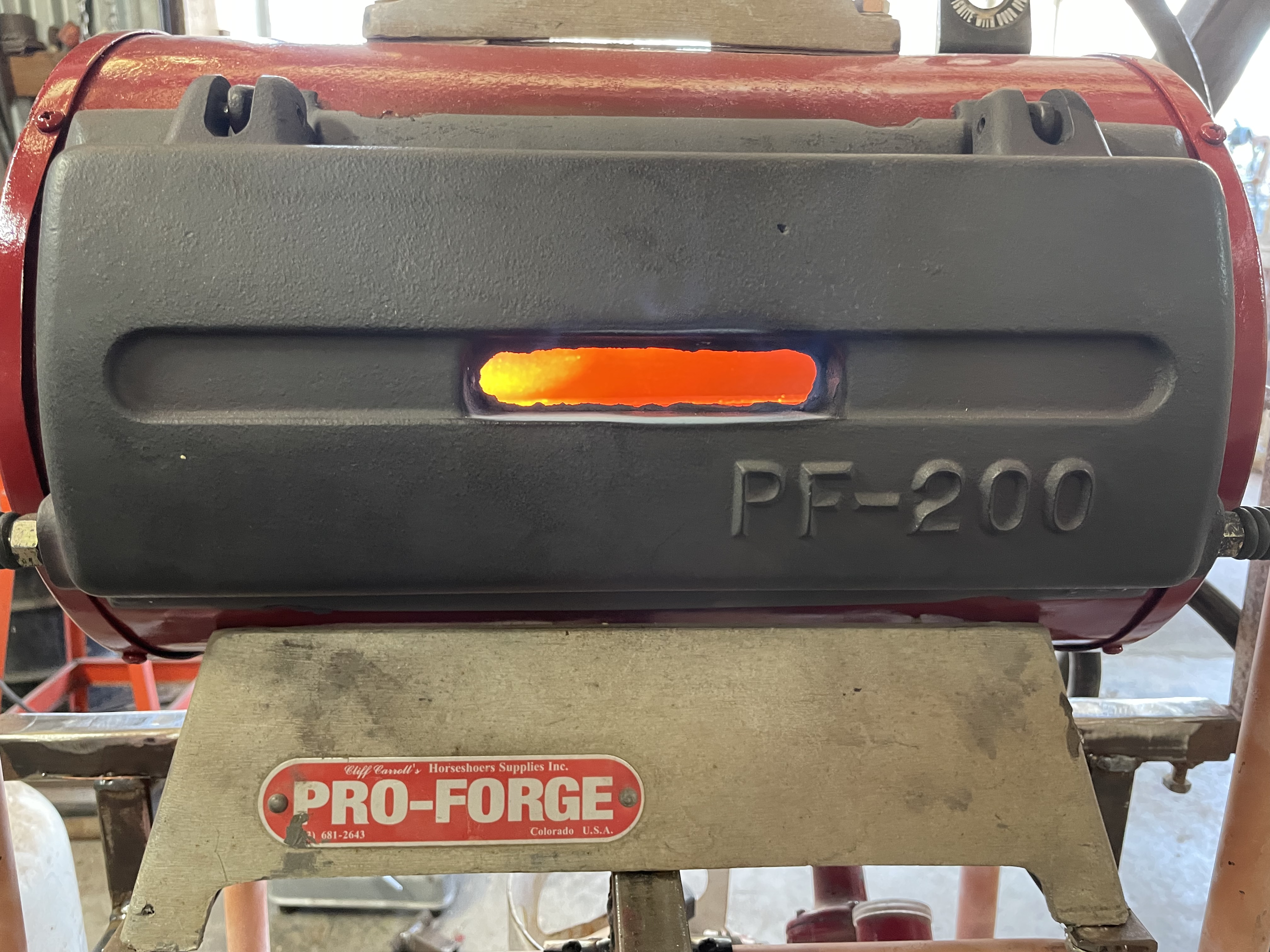

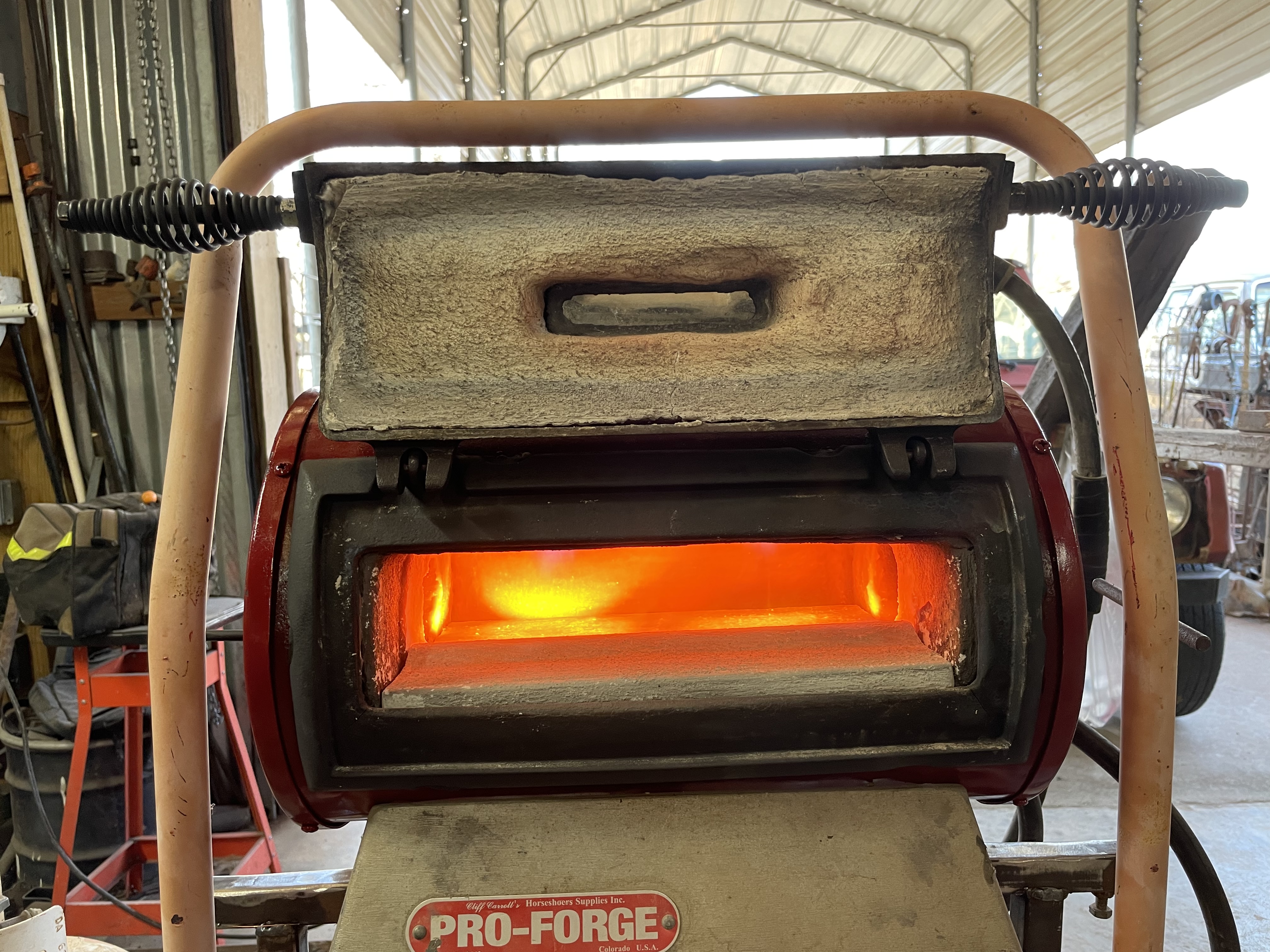

Charles R. Stevens Posted January 14, 2023 Author Share Posted January 14, 2023 It lives…. Wife has been sick, house siting for the kids, sub zero weather and biting a deer has kept me from finishing her up till today. Quote Link to comment Share on other sites More sharing options...
Irondragon Forge ClayWorks Posted January 14, 2023 Share Posted January 14, 2023 Looks really good and ready to work for another decade or so. Quote Link to comment Share on other sites More sharing options...

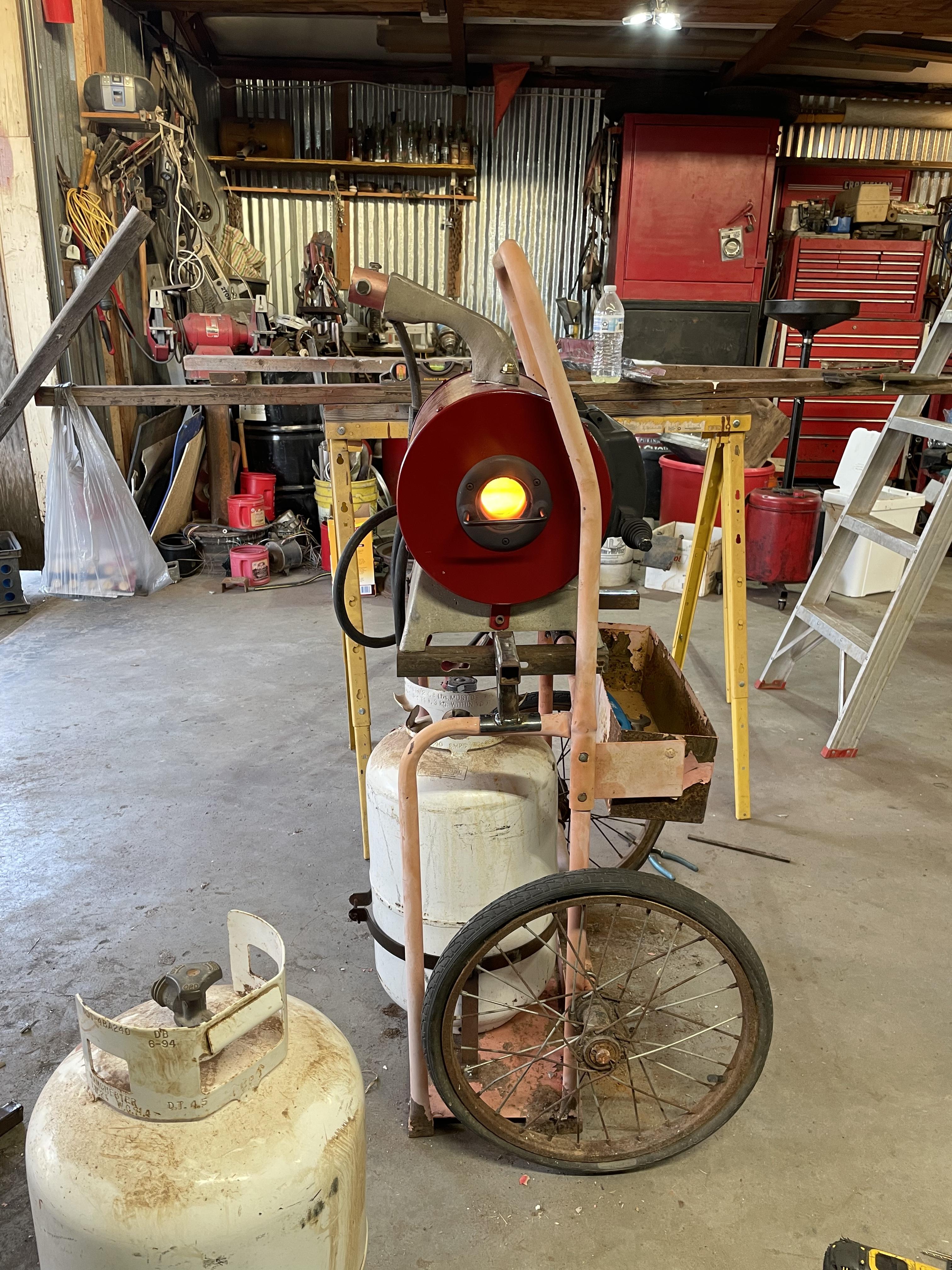

Charles R. Stevens Posted January 15, 2023 Author Share Posted January 15, 2023 One hopes, lol. Now to put wheels on the shop anvil… Quote Link to comment Share on other sites More sharing options...

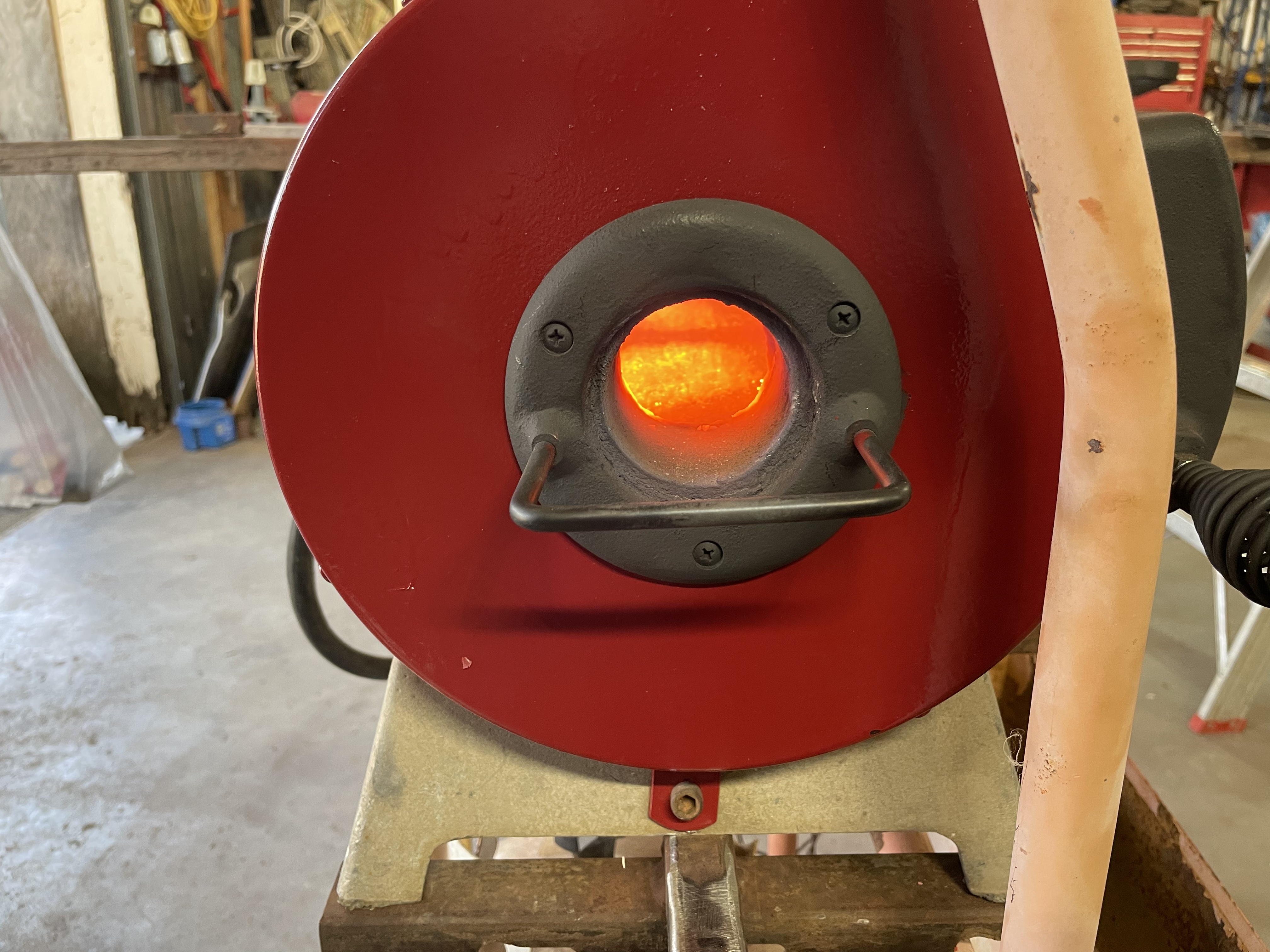

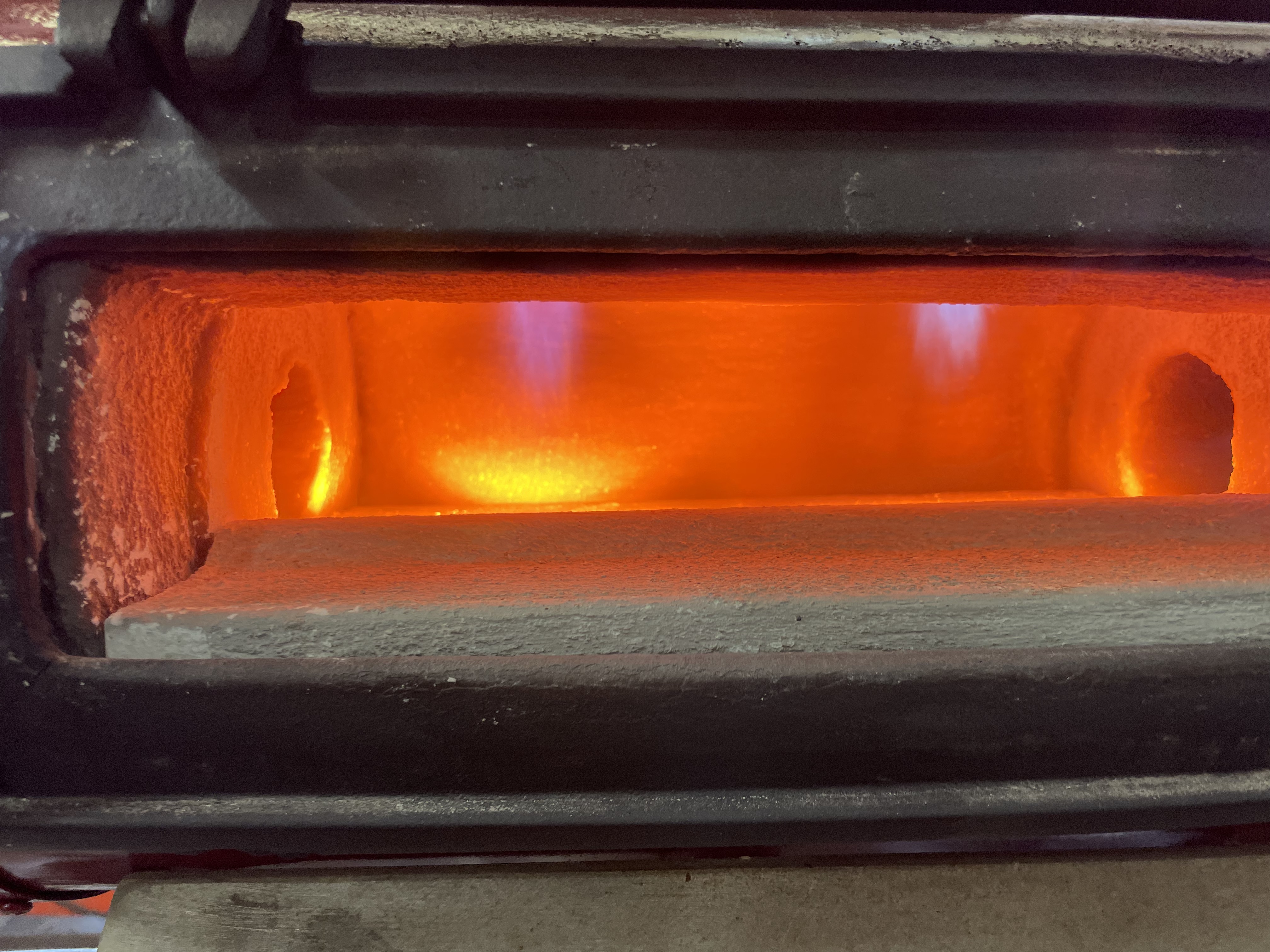

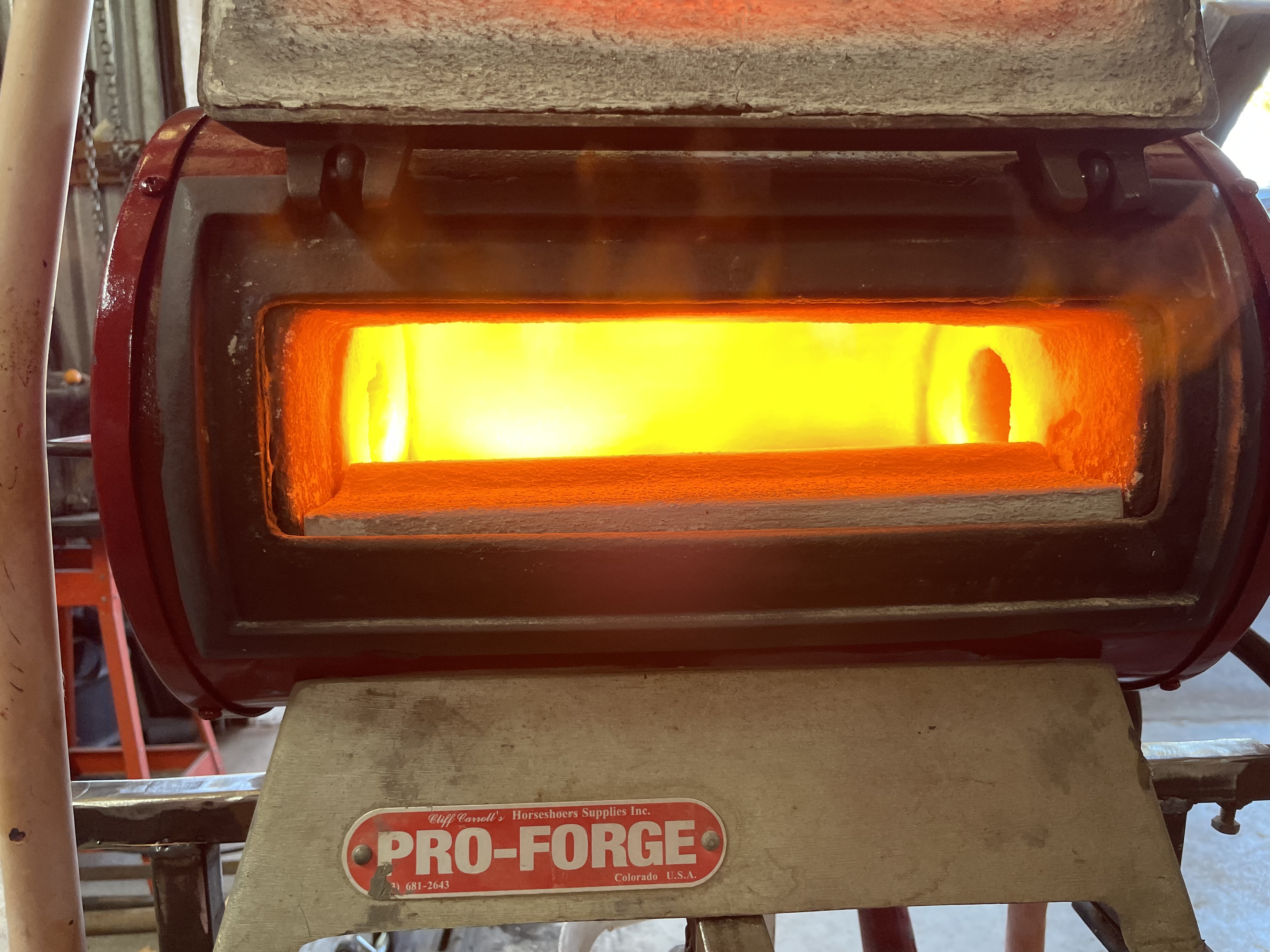

Charles R. Stevens Posted March 6, 2023 Author Share Posted March 6, 2023 The new material is certainly a better choice for a farriers forge. As we generally work out of a trailer work truck and not a stationery shop the fragile material used before was vibration sensitive. as to cost, the cost I got mine at was very reasonable but I think the MSRP is over the top. Kiln shelf, rigidizer and kook wool (now that you can find it in small lots) would have cost 1/2 as much as I payed and a 1/4 what MSRP is. Cost and the raw ceramic wool used to seal the door and under the floor are always a concern so I did buy some. I am very satisfied with the hard facing and kiln wash upgrade as well. being able to run the forge at 2.5 psi as opposed to 5 for general forging and 5 for welding (still a neutral flame) saves fuel and frustration. I need to order a bit of wool and build a single burner both to use up the rigidizer, hard facing and kiln wash. the pro forge has handled 2” rounds heating them over a foot, but frankly for most work it is overkill. A stack of 4 keg shoes is what it is optimized for and will go from cold to ready to shape in less time than it takes to trim the feet. but it will handle a Bowie or a largish scroll with equal aplomb Quote Link to comment Share on other sites More sharing options...
