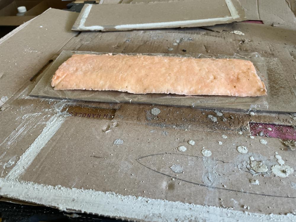

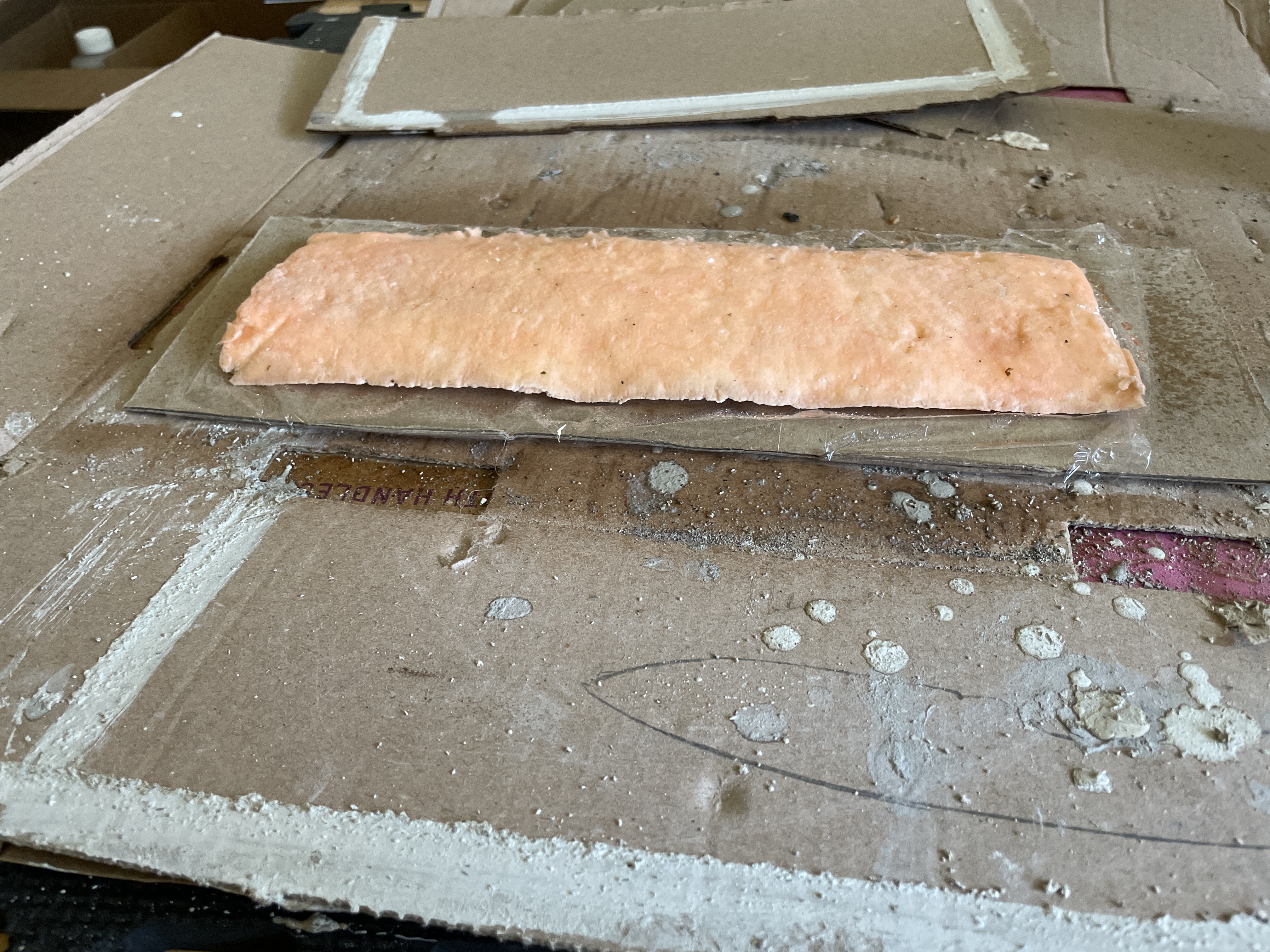

Charles R. Stevens Posted December 17, 2022 Author Share Posted December 17, 2022 Mike, how well dose ITC-100 hood up as a flame face? In the pro forge the floor plate takes the abuse from the burners. I coated it with ITC-100 in hopes that it would help with borax erosion. Quote Link to comment Share on other sites More sharing options...
Frosty Posted December 17, 2022 Share Posted December 17, 2022 After reading a little on the ITC site IC-100 may set up hard, it sure didn't when I bought some but that was more than 25 years ago. If it doesn't fire hard maybe put a layer of kiln wash over it? I'm no fan of Satanite, even the maker, "HWI" says it doesn't work for flame contact, it's for cementing things together. But if it's what you have it MIGHT work to protect ITC-100 iderneath it. Frosty The Lucky. Quote Link to comment Share on other sites More sharing options...

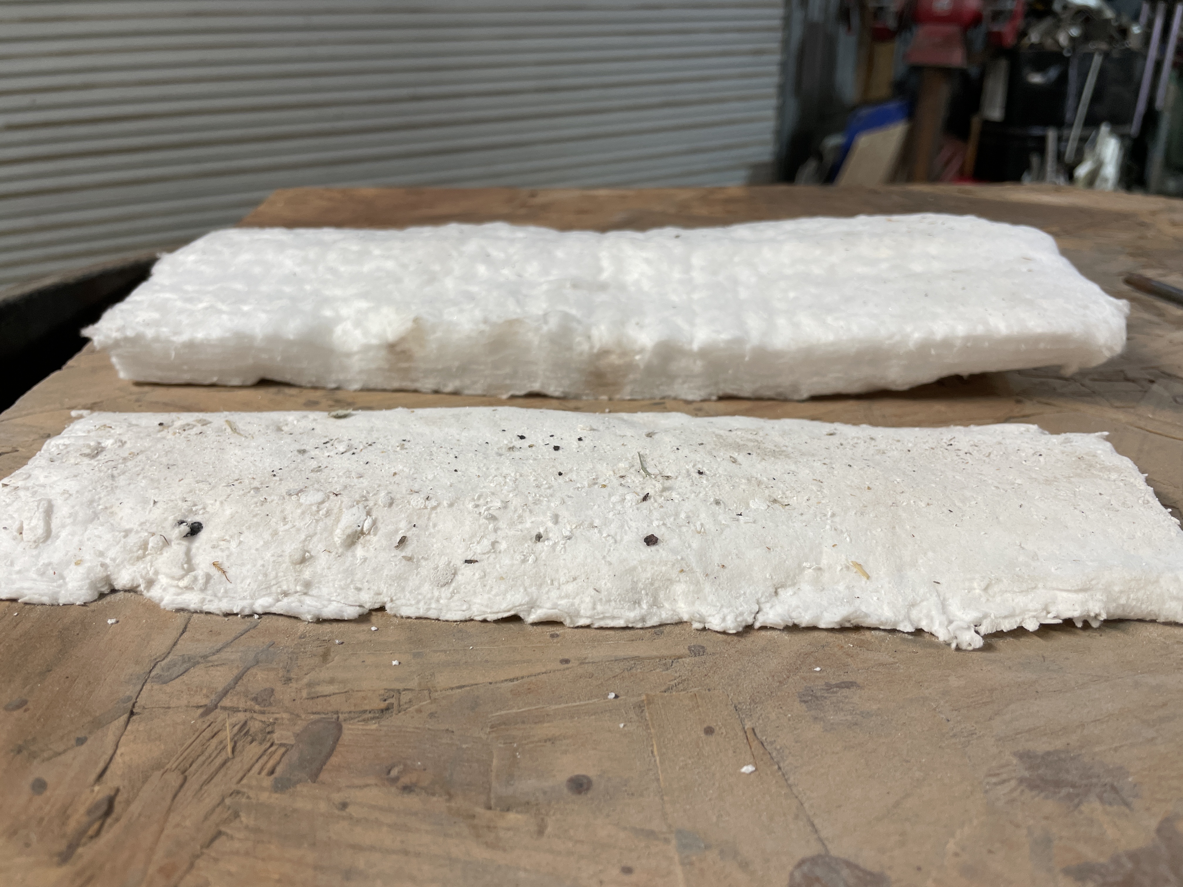

Charles R. Stevens Posted December 17, 2022 Author Share Posted December 17, 2022 Well the satanite is providing mechanical protection for the liner and the ITC is coating the whole thing, floor plate included. The burners are directly overhead so the floor plate or the work .takes the flame. the ITC came the consistency of corse grogged clay, with directions to cut with 1 part water to two parts ITC. the directions for the Satanite made a thick pancake batter wash. at this point everything is green ware hard baked at 550f. After I clean up and remount the burners (mud dobbers) I will fire it up for an hour or two to try and vitrify the coatings. Then we will see if I wasted my money. Quote Link to comment Share on other sites More sharing options...
Mikey98118 Posted December 18, 2022 Share Posted December 18, 2022 3 hours ago, Charles R. Stevens said: Mike, how well dose ITC-100 hood up as a flame face? In the pro forge the floor plate takes the abuse from the burners. To begin with, I'm not sure that the present owners of this product, are still using the same formula. But, the original formula held up just fine against my hot burner flames, and only needed repair when internal surfaces were gouged or scraped by parts being heated in the forge. Since additional coating goes just fine over the original coating, this should be no bother. Others have complained over the years that their ITC-100 coating left off or pealed away in places. I think I can safely put that down to sloppy insulation work. Considering what you plan to paint it on, I don't expect any problems of that kind. Why? Because the original formula has an acid for a binder. This acid creates a sticky surface until it polymerizes at heat (around 900 F, if I remember correctly); this makes a permanent change in the binder, so that it is tar-like at room temperature, and turns glassy at heat, going through this change endlessly without wearing out. You couldn't ask for a better plan, so far as keeping the zirconia particles in place is concerned. Furthermore, the original product lived up to their brags, once I started placing a little bit of it at a time, in a glass partially filled with water. What happened then, was that the coarse zirconia particles fell out of the solution, and settled to the bottom of the glass. The remaining particles, which were most of them, were by definition colloidal. What is important about that is that, only tiny particles of heavy metal oxides (like zirconia) are colloidal. You can paint the thin solution on the forges internal surfaces with much less effort than the thicker paste calls for. Zirconia particles can rang from 70% to over 90% "heat reflective"; the difference is in how small the particles sizes are. By sacrificing a small amount of crude particles, you will greatly increase efficiency, and greatly lower heat stress on the forge. What a nice exchange Hope this helps you Charles, Mikey Quote Link to comment Share on other sites More sharing options...

Frosty Posted December 19, 2022 Share Posted December 19, 2022 The first ITC-100 I bought remained chalky for years and the forge got hot enough to melt steel. Jump forward 30 years and today ITC says ITC-100 overlain with ITC-690 is the ideal but either fires ceramic hard. My only conclusion has to be that my experience is too dated to be good. Frosty The Lucky. Quote Link to comment Share on other sites More sharing options...
Mikey98118 Posted December 19, 2022 Share Posted December 19, 2022 I get the feeling that the ITC-100 you are describing is a completely different formula than the product I used nineteen years ago. Quote Link to comment Share on other sites More sharing options...
Frosty Posted December 19, 2022 Share Posted December 19, 2022 WAY different. A fellow I don't regret not hearing from or about in 30+ years discovered doing something like you describe. He did a hydraulically fractioned ITC-100 in a 2,000ml graduated cylinder. When it all settled out he had approx 70% kaolin clay and 30% zirconium from fine sand to passing a 200 seive. I have part of the 50lbs of kaolin clay I bought to do some experimenting and I do not know why it won't fire in my forge. It gets more than hot enough but kaolin remains chalky, just like the ITC-100 I applied according to the package directions. My thought for buying the kaolin was to wash the rest of my forge and protect it from flux erosion. The ITC-100 is still clinging to the roof on the forge because it doesn't get rubbed on very often. So yes, it was a very different formula maybe a short term failed line, I don't know. Frosty The Lucky. Quote Link to comment Share on other sites More sharing options...
