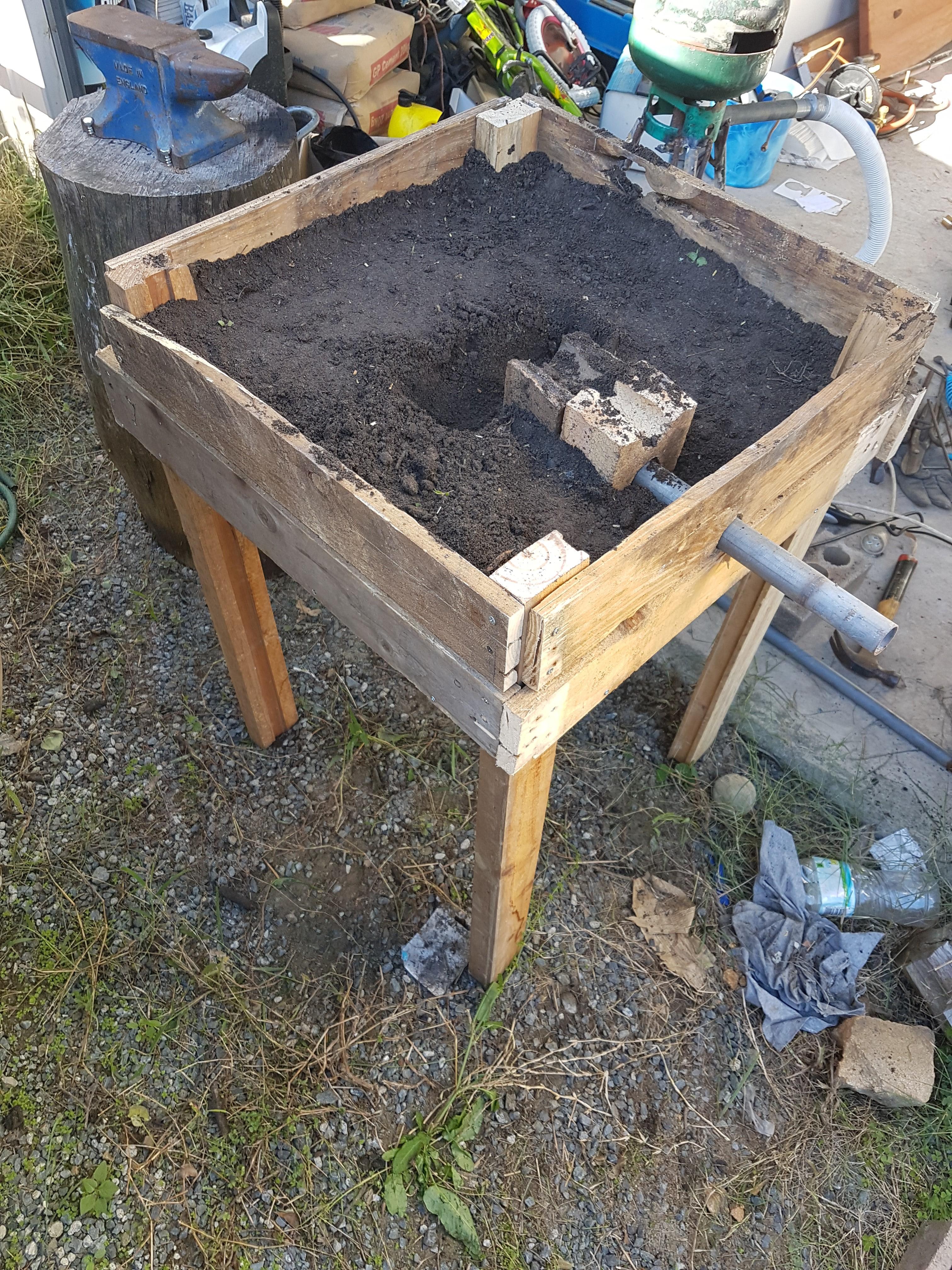

I started with a dodgy bottom blast made from half of an old gas bottle
But a little reading on here made me think this was not a great design (I may re-purpose the outer bottle section as a fire pot for something bigger in the future) so I started my JABODDU. It's cut up pallet timber and the legs are 4 pieces of packing timber from a delivery to the school where I work as a Design Technology teacher. Here it is half filled. The tuyere is 22mm ID (7/8") held in place by the holes in two half bricks. I drilled the hole in the box frame slightly higher than the holes in the bricks which gives the tuyere a slight down-angle. It is galvanised but I stood 3" of the hot end in vinegar (it was as deep as I could cover. I hope it's enough!) overnight and scrubbed it off. What you can't see is that I put 10-15mm (about 1/2") of dirt in, then put a square of fibre cement sheet that I had from an old project in then added another 10-15mm of dirt before the bottom of the fire bowl/trench, which I moulded around a brick. The tuyere comes in about 25mm (1") above the bottom of the trench. (You can also see my little Record Anvil in the corner of the pic)

Hi all, just reporting back. I've had some successes and some struggles with the JABODDU.
I've got a bit more of a handle on charcoal size and amount of air and I've been able to make a decent set of flat jaw tongs (instead of the rebar monstrosities I started in the earlier pics) and a longer fire rake so I can stop burning my knuckles.
My struggles at the moment are to do with sand. Clearly there's not as much clay in my local dirt as I thought and during a longer session, I'm finding that the edges of my rammed earth fire bowl are crumbling and mixing through the fire when I need to rebuild it. Obviously I'm trying not to dig up the edges too much but it is still happening. This is leading to clinker-like lumps of sand building up in the bottom of the fire. Then, when I try to carefully rake them out, the edges crumble more and the whole situation spirals.
My thought is to go to refractory splits like they use in wood stove fireboxes and line them up in a similar pattern to the way Charles has with the JABOD mkIII but with my existing dirt surrounding them, instead of kitty litter. I know a place that is semi-local where I can get them for a good price.
Does this sound like a suitable solution or are there other options that might be better?
Yes to both. Using split bricks as described works just fine. In fact you can see slate and sandstone being used in some of the 3rd world blacksmithing videos.

What you're describing is a brick pile forge. They're very versatile as you say and a good way to experiment with size shape, burner# and arrangement before building a more permanent version. I have a couple boxes of fire brick, maybe 20-25 split 3,000f hard, a full case of K-26 IFB and I don't know how many of the older more expensive lower temp IFB from before Morgan K-26 IFB became available. Darn if they aren't less than 1/2 the price of the old ones to boot.

You could use red clay bricks. Dry them in an oven at about three hundred degrees Fahrenheit to make sure there's no residual moisture and you should be in business. Revisit the MARKIII jabod thread. It shows a red brick firepot. You said you'd have to pay for the splts but you can probably find red clay bricks for free.
Pnut
The bricks in the mark III are realy for continence. The 4 forming the back wall are the most useful, the floor is the next useful. I have a broken pizza stone that would work or a piece of steel would work as well.
