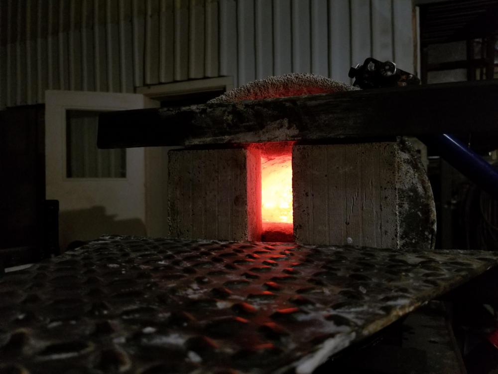

Thank yall for the sagely advise. I will just go with a square/ruler, and make a rack for tongs and hammers on the bottom. Virgin firing was tonight, and for the life of me I couldn't understand why the flame would not stay lit when the burner was in the forge. It turned out that opening the gate some kept her going. I was displeased initially with how big the flamelets were, as I was expecting some cutesy little ones. I got over the robustness for long enough to get some heat in the forge. I had the max line pressure down at 2psi, and the needle valve about half way open (maybe, I was being very cautious). All the pictures will be at this setting. Cameras at night make flames brighter than they are to my eye, which saw the inside as a high orange. I put a 1inch round stock bar in for exactly 4 minutes, and the picture of it seems more accurate as far as color is concerned. The picture of the round stock inside the forge is after shutdown. Any further correction or advise is greatly appreciated and impatiently anticipated. I have short videos if there is any interest.
  • 3 weeks later...
Well, this is going to be my last update for the forge build thread. The table has a 28x28 inch square/ruler scored into it, and I will brush some bright orange paint in the lines once it's warm enough for paint. There is a handle/rack for hammers and tongs with wheels on the other side so that when you tilt it, it can be easily moved. I used some nice foam between the forge feet and the table to soak up some vibration. The bottom shelf will be done once I find some scrap expanded metal.
I used the forge today for the first time at length. The plenum stays cool for quite a while, but once the forge is at a low yellow, it heats up. It isn't hot enough to burn from a touch, not even close in fact, so I dont think I am having any back-burning issues. The forge heats up fairly quickly, and will get plenty hot at 2-3 psi. I haven't had more propane in it than that so far, and it achieves low yellow. I stretched out the belly/tip of a large kukri today, and hammered in the bevels a good bit (rest will be on the grinder). The stock was .250 and heats between hammering were very fast. All in all, I am EXTREMELY happy with the end result, and I am thankful for all the help and encouragement. If anyone contemplating building a forge reads this, I would strongly advise the following:

Les L I am using leftover propane from my bbq grill(20lb). I would guess 1/3 of a bottle was worth 4 hours before my pressure started to drop. I won't get a real bottle for a month or so and I will be able to give a better estimate for a 40lb bottle. This is all at orange heat, 1ish psi.. maybe 2psi max. Knife stock heats up lightning fast.
