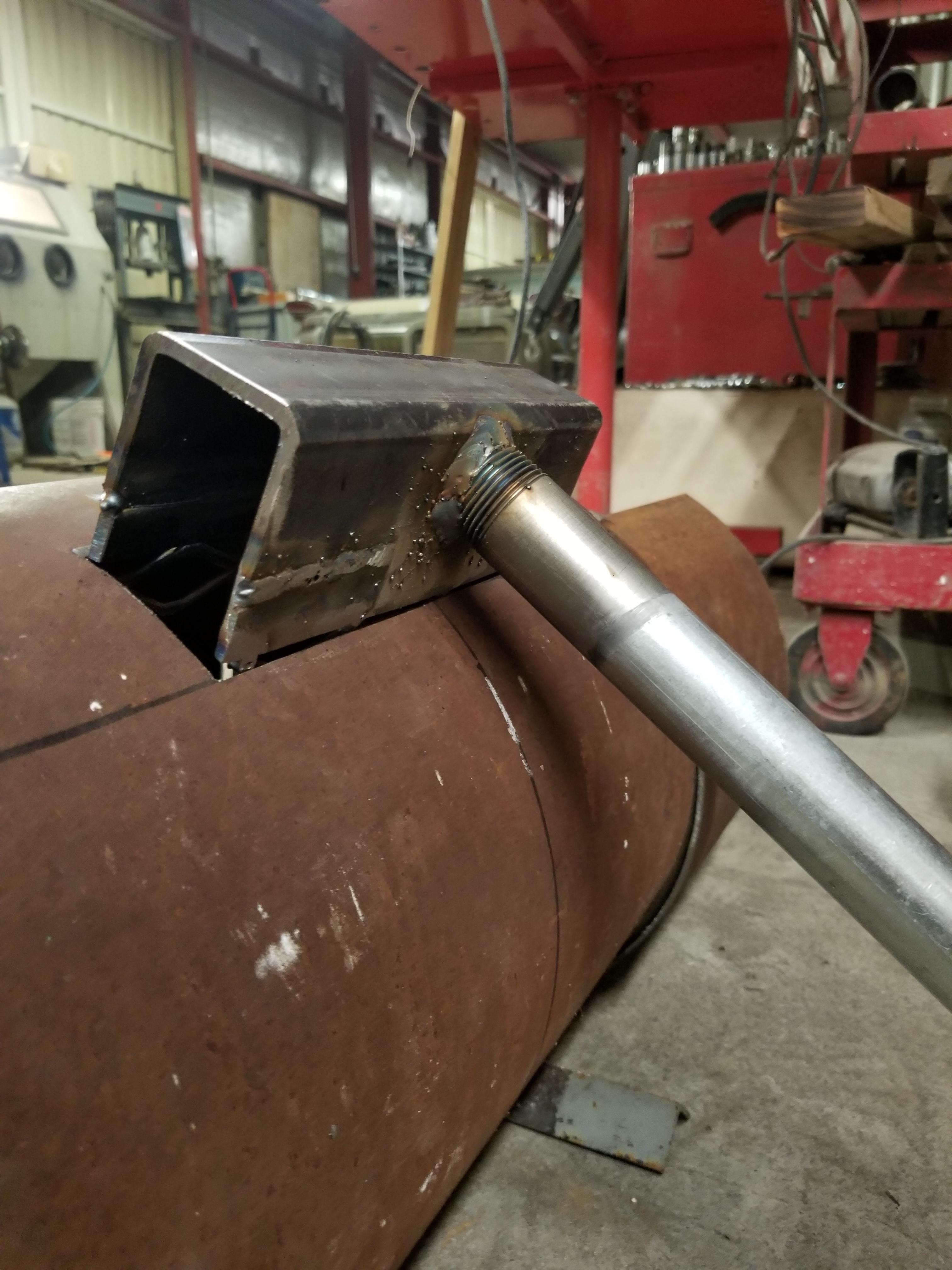

Thank you for the replies. I will use a vault design with an 8in burner. I would like to copy your NARB design regarding the plenum's fuel/air inlet orientating from the side. If I need to include a baffle, it stands to reason that it could be much smaller using the NARB design.
My thoughts are a 2in by 2in by 8in plenum with a 2in thick refractory section protruding 1in out of the assembly. This would make the metal section 2in by 3in by 8in. I will probably keep the same location and angle as previously proposed because it sounds more fun to build than a 90° angle. Does this sound workable?

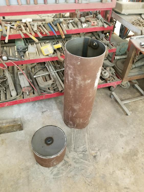

I found a tank that I was happy with. I am getting it sectioned currently. Progress is a bit slow right now as I have many irons in the fire, but it's progress none the less.
Progress. next will be casting and testing the burner.

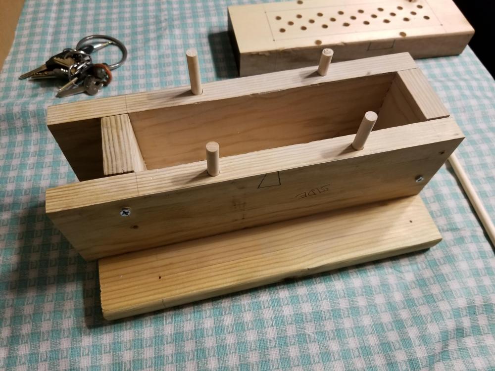

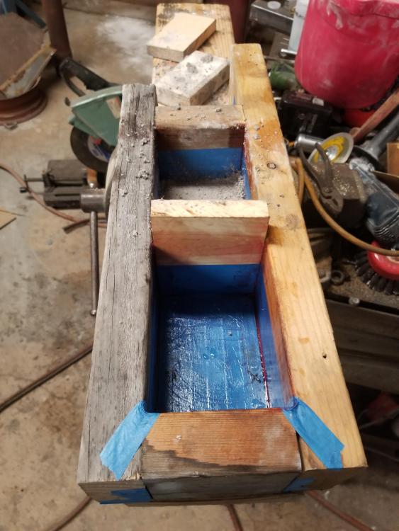

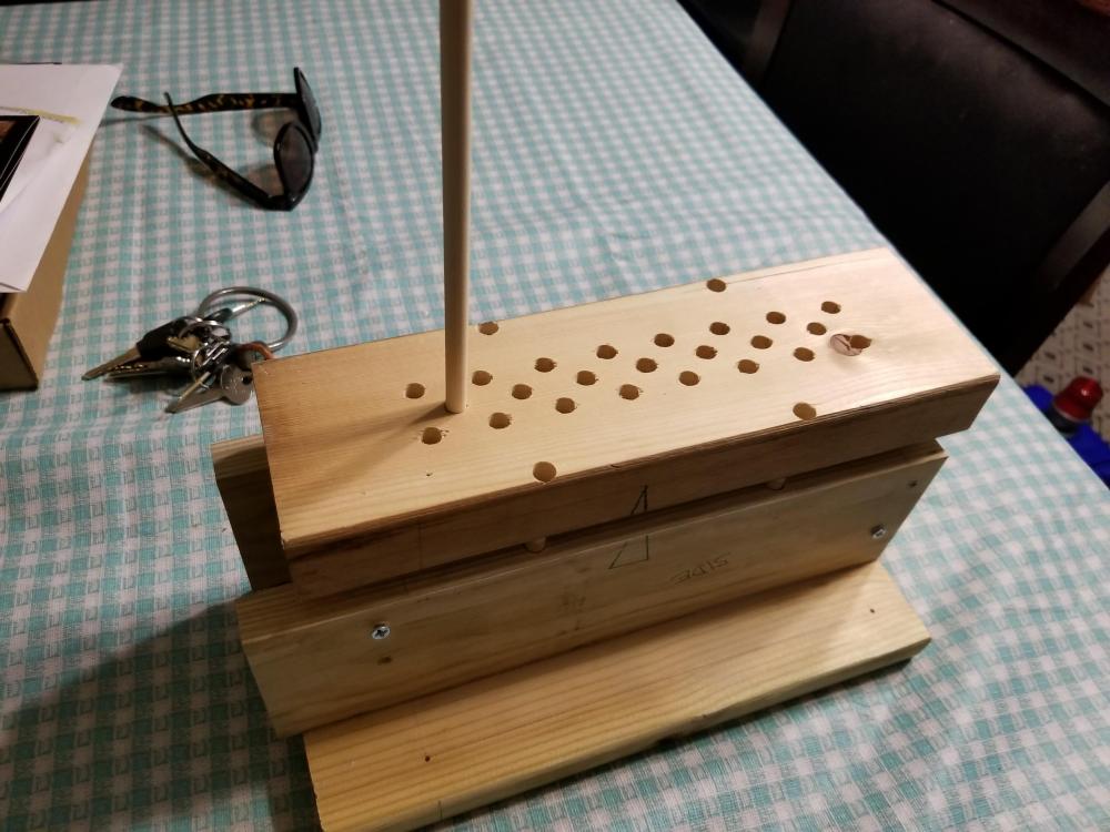

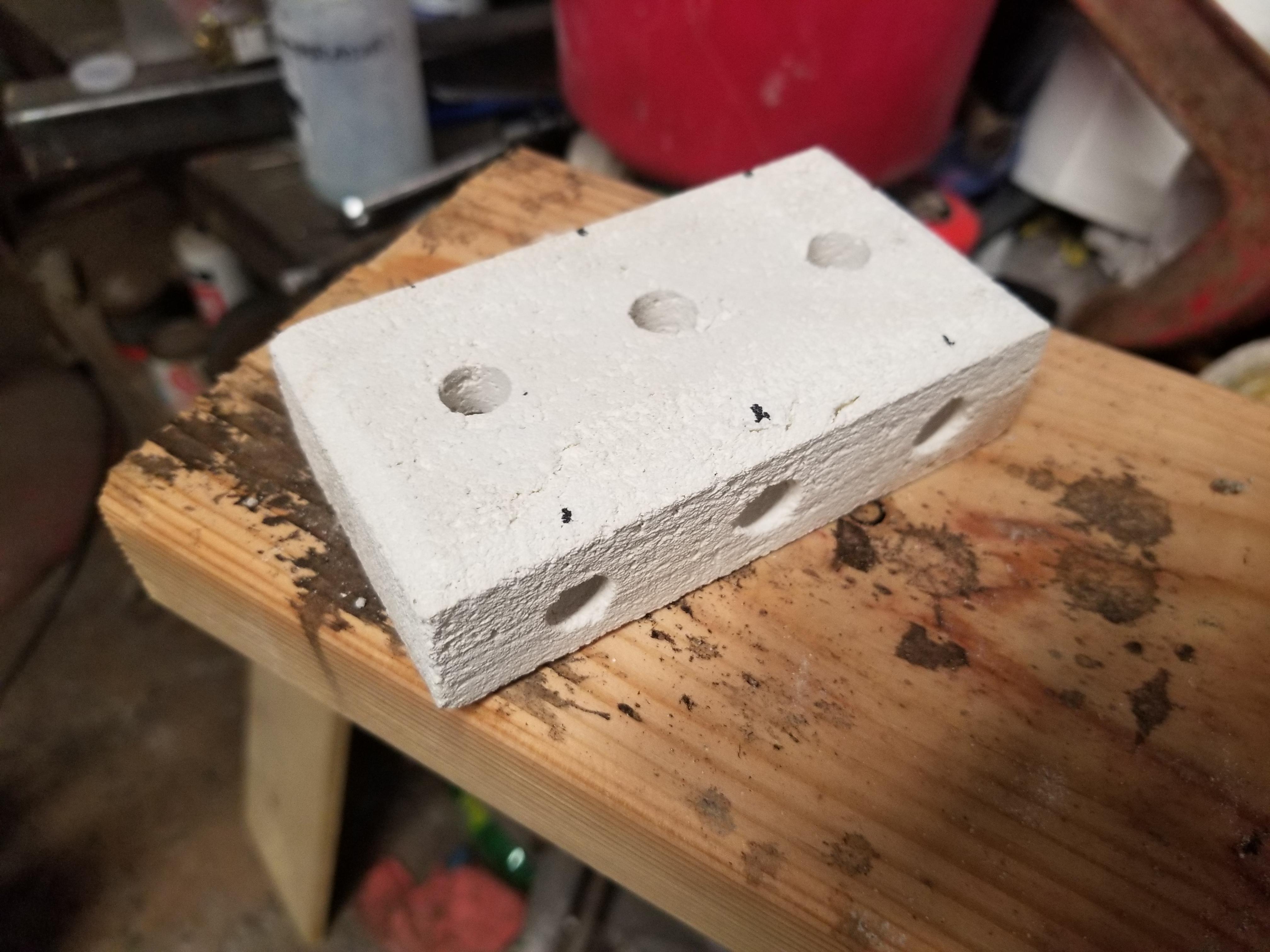

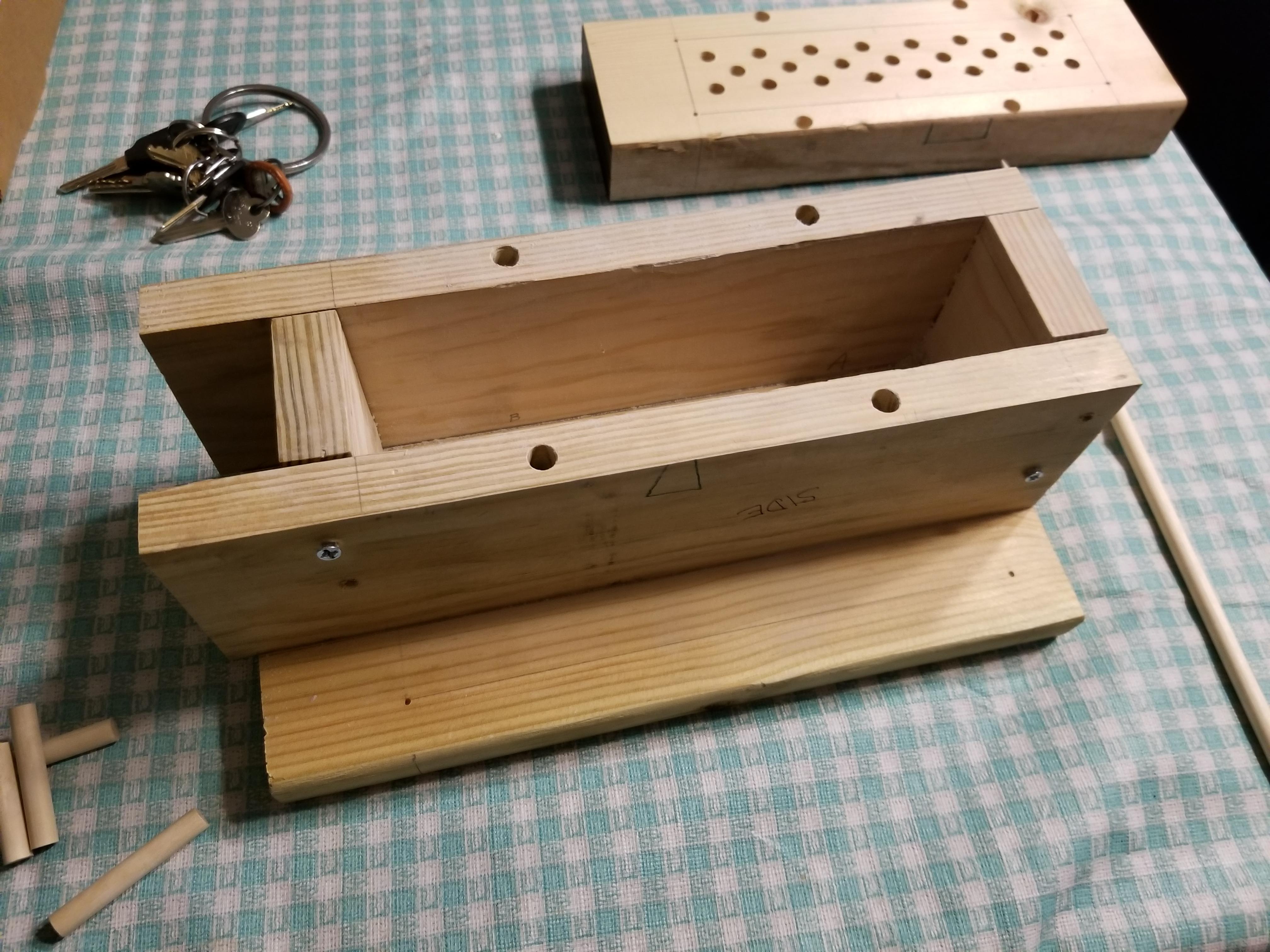

Another progress update - The door and exhaust guides are on, nuts to hold the ribbon burner are on, and the ribbon burner is cast. I let the burner sit in a bag for 24 hours, then in open atmosphere for five days. I cast it a little different. I cast the refractory a little long, made a guide setup on some dowels, preset the voids for the crayons with a tapered rod of less angle than the crayons, then set the crayons tapered end down. This worked fairly well, but when setting the burner plenum in, a couple of crayons settled a little lower than the rest. The crayons were tapered, and when the bottom 3/4 of an inch was cut off, the smaller holes were exposed. The crayons were then melted out. I am hoping to slightly increase the air fuel mix velocity exiting the outlets. If it works, I came up with a precise way to do it next time so that the outlets will be very uniform.

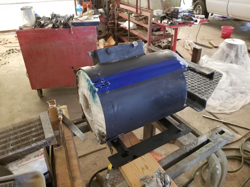

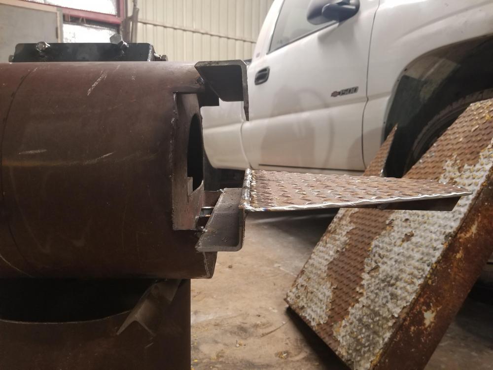

Progress has been slow till tonight. I got my shell finished (I think). I did run into some trouble though.. Two of the bolts warped in their nuts while welding. I have had good success with the method to hold the nuts while welding, but in the past I had used a TIG. I think the MIG had way too much heat transfer. I should have switched but didn't think about it at the time. Everything turned out ok though. I'm pretty happy with the shell, and if the next four days go well at work, I will be cutting and rigidizing refractory blanket. If the setting of the guts goes as planned, the forge volume will be somewhere between 302 and 318 cubic inches.
As a side note, you may see these pictures and observe popping/high wire speed on the shell's welds/beads. This was due to an issue with the spool, and I had to turn her speed up to make it work.
  • 1 month later...

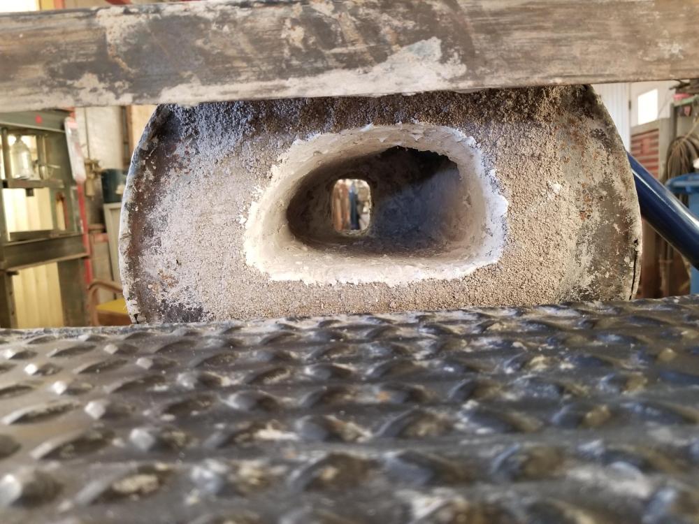

Overdue update: Except for casting of some refractory doors, the forge is finished. I am on to working out the burner. The interior is 1/2 in. bubble alumina for the floor and 1/2 in. COL30 for the walls.. light coat of matricoat90. I wish it was about an inch wider, but overall I am happy so far.
I got my forge doors cast finally. Being that the doors are consumable items, I made a mold that I can zip together to cast more as needed, and leave in a corner in the mean time. These particular doors are cast-o-lite with soft brick cores. The soft brick had passages drilled and packed with cast-o-lite to tie the faces together and increase strength. I am impressed with cast-o-lite as it is very strong after it is cured. My hope is to have doors with reasonable toughness that will aid in insulating the forge to a degree.

Long overdue. The burner creates some level of heat, at least. When I get my table built this weekend (Monday-ish), I will fire it in the forge.
