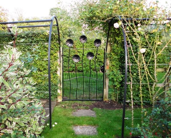

     Could someone suggest where to look or a book to use in making a small garden gate/fence. Basically, I'd like to learn how they where done before welders where around. I can't figure out how the vertical rails where fastened to the horizontal ones. Trying to learn how things where done old school.

Depends largely on the design. Can you show us an example of what you had in mind?
A very basic gate since my skill is very limited/new. I'd like to have stems for the vertical rail and daisy for the flower. Something like this gate.
Since welding started with the smelting and working of iron you will need to look into wooden fences and gates to be predating welding.
Mortise and tenon, riveting, twisting, collaring, heat shrinking, lots of ways of fastening stuff together without welding it.
However the COSIRA books (available in pdf form free online) covers a lot of this.  In particular may I commend to your attention: "Decorative Ironwork"  which has 7 designs for grillwork/gates with step by step instructions on how to make them.

These are some notes from an intensive basic Blacksmithing course I host. They are intended as a reminder of what can be used in various projects and situations that have been dicussed in class.
Joining methods used in metalworking
Welding;                Forge welding, oxy acetylene, arc, Mig, Tig, spot
Riveting;   Round or square shank, different heads and riveting allowances for different types of head
Studs; Threaded rod, double ended, need a tapped hole or/and nuts
 Ball nuts; Round, domed, and other profiles
Collars; Shaped, riveted (Multi parts), cast, need for use of mandrel
Wrapping; Like collars, but from wire/round rod
 Brazing; Use of brass, copper, fluxes, cleaning after
 Silver soldering; Different grades of solder, use of flux, cleaning after
 Threading; Use of taps and dies thread, chasers, tap and die holders, drilling for core diameter/tapping size, clearance sizes, cutting fluids
 Nuts and Bolts; Types and uses of threads, different pitches, Identification on heads
 Tong with a Slot and Wedge; Leg vice type fitting, can be easily dismantled, use table legs, frames etc
 Cotter pins; Like old bicycle pedal fixings, go solid but can be dismantled. Tapered flat on one side to fit against flat on a shaft, secured in place by nut with washer
 Split Cotter pins; Made of thin sheet, ( C=== ) fit through a slot and legs bent out to retain glass sheet etc ie lanterns
 Taper Pins; Used to secure rings on shafts eg on Blacker hammers, that move, but not rotate or similar situations. (They need a taper ream to form the hole after drilling, pins can be removed if required)
 Roll pins and dowels; Used to locate items, and are removable.
 Halving joints,
 Pass throughs; used to position bars but not necessarily a secured fixing
For sheet metal working other methods are also used, the most common being
 Lapped,  Spot weld,   Seamed,   Soft solder,   Wired,  Hemmed,  Flanged
I hope this may be of some use as to what may be available when assembling projects. Enjoy
