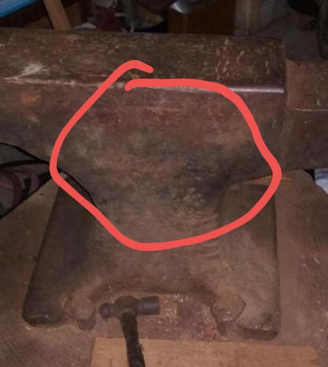

Let me know if this is not the right place. Trying to identify this anvil that was my wifes grandpa's
Thanks,
Peter

From the looks of the numbers on the foot (weight & partial serial number), my guess would be a Trenton. In the picture with the horn to the right it might be the Trenton diamond (very faint). You might be able to bring it out better with the wire wheel and a close up picture.
Like Irondragon said. Wire wheel and look in this area for any logo stamping. Also a picture of the bottom of the anvil may be helpful.
Some of the markings shown look suspect to possibly not being from the manufacturer.

Please show a picture of the bottom of the anvil.
They symbol is most likely added by a previous owner and may have been their trademark/stamp.
