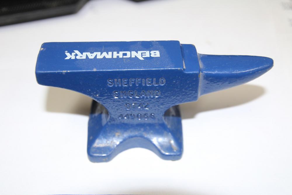

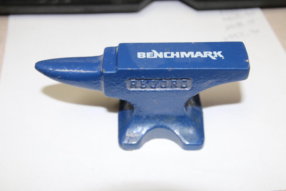

Thanks guys, my only real anvil right now is a record anvil that is about 4-3/4 inches long  and really more of a paper weight.  I remember that in 1973, we were getting ready to move and my dad decided to try a flotation test on the anvil that we had rather than move it with us.   Unfortunately, it did not float and I have wished ever since that he had not done that, but I was only a young pup then.  Ever since I have kept my eyes open for a used anvil, but one has never come up.

The Record Anvil is 620 Grams, or about 1-3/8 lbs.
I purchased two of them when I worked at Home Hardware, so that would have been about 30 years ago, I gave dad one and kept the other.  I know that mom still has dad's proudly displayed with her tape measure collection, he passed away in '97.
These were a promotional item promoting BenchMark Tools, which was a Home Hardware House Brand.  I have never used it as an anvil as I have a better chunks of RR Iron and countless blocks of steel that I can bounce a hammer off of.

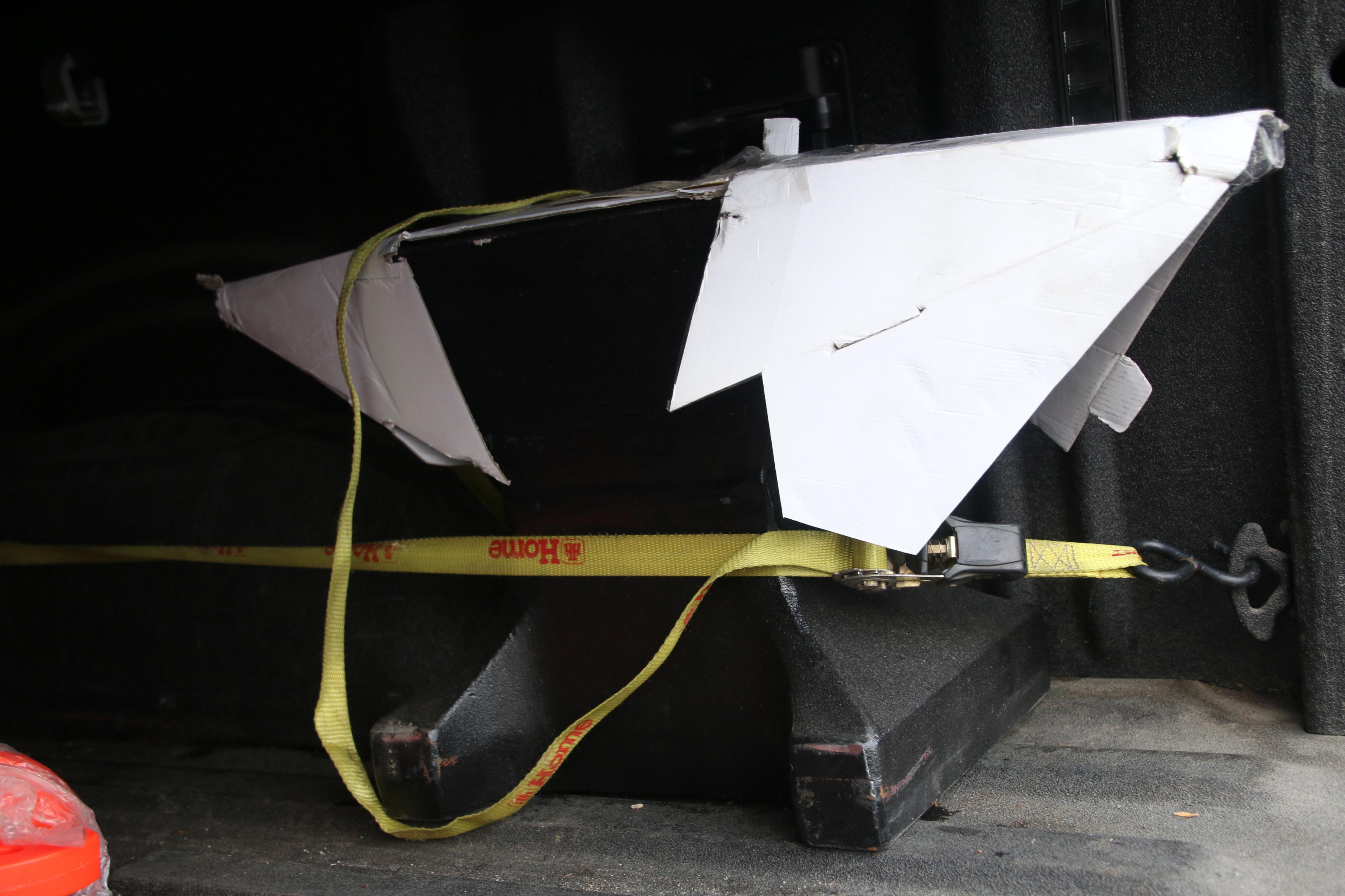

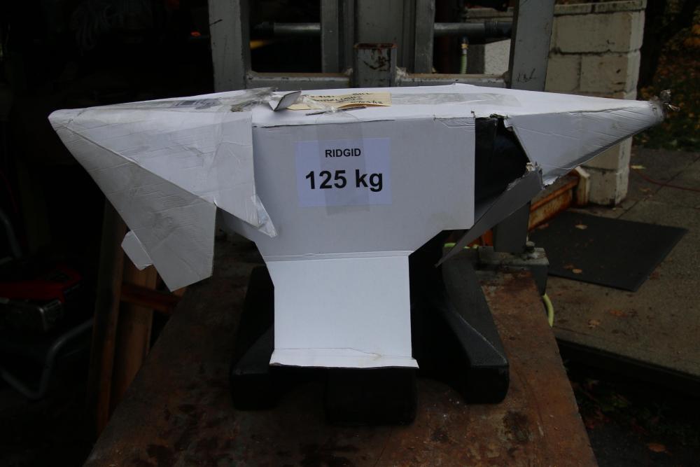

So I had a little puppy follow me home today.  Hoping it will attract more, LOL
Went with the Peddinghaus 275 Lbs Double Horn Anvil.
Walter
Good choice.

Thanks Gang, it was narrowed down to two choices, the Holland Anvil or the Peddinghaus.  The Peddinghaus was considerably less expensive after freight and import expenses were taken into concern.  Ordered Oct 9, and it was delivered Oct 27.  Which considering one inquiry I had made said they were on B/O in Canada until early spring caught me off guard with how fast it actually arrived.
JLP,  yup the Hardie and Pritchel holes both line up with the base of the anvil so it is not possible to pass long stock through them,  so I will have to see if it is worth the effort to modify the base or not.
