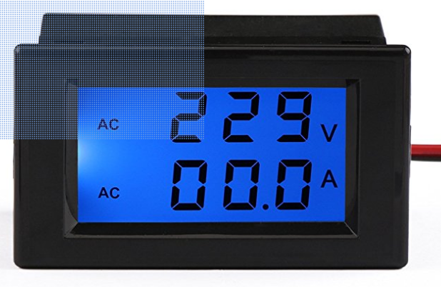

i use one of these on my DIY heat treat oven, will be putting one on the power input for the induction forge as soon as it arrives. Will be able to keep an eye on the amp usage. Great little gizmos.

Mounting of the load meter.
