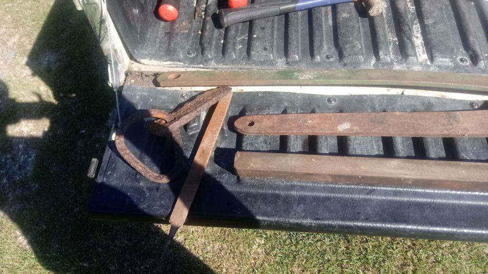

Lucky find now what are these made of
So i found theses the other day and was hoping to hear ideas about what they are made of and also what good uses they have(other that the use they were made for lol)

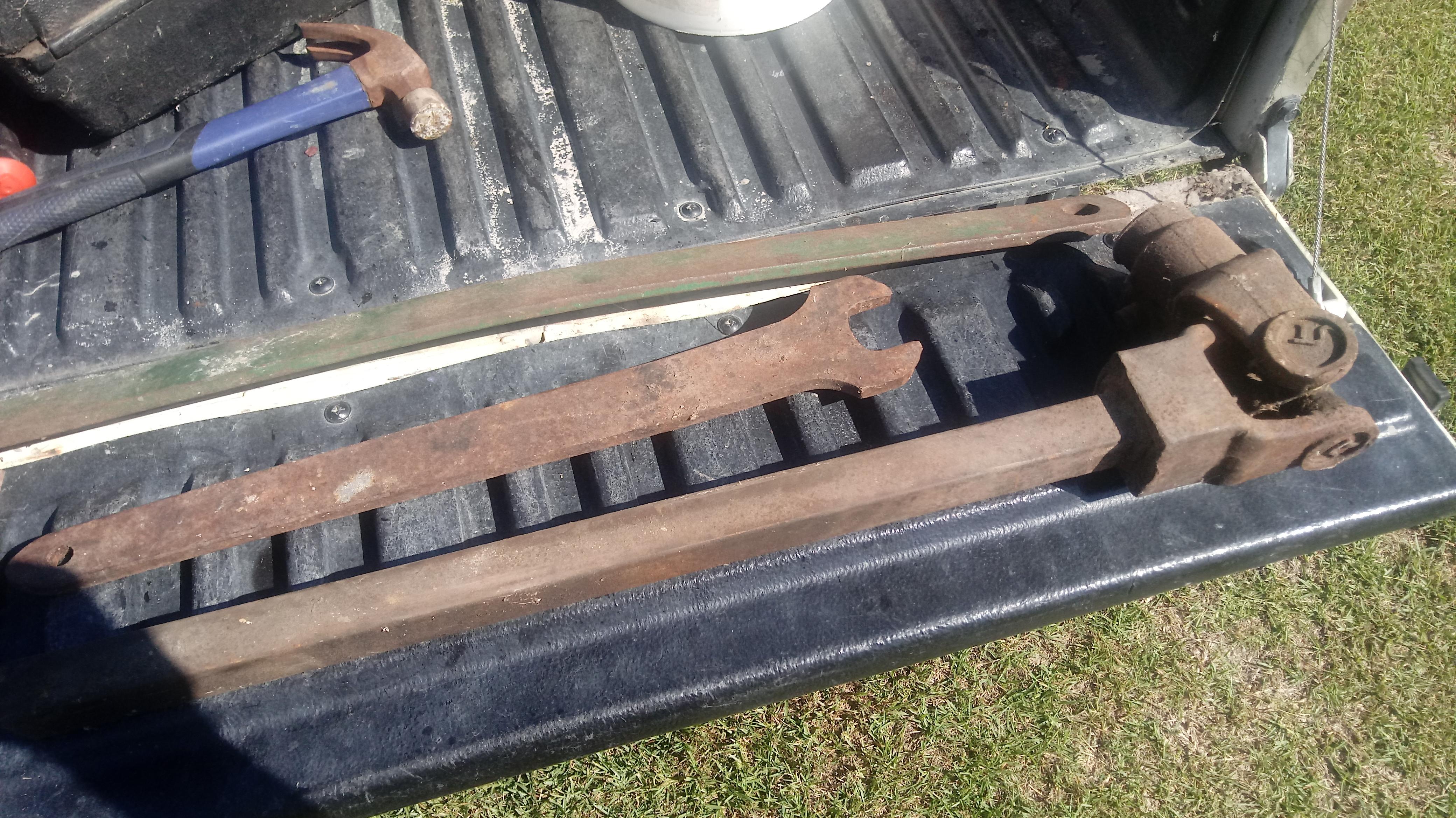

Back to front:
A hammer.
Some mystery steel bar.
A big wrench.
A power take-off shaft.
On the left:
Some kind of ring fixture (possibly wrought iron).
An old file.
There are several threads about identifying mystery steels and their uses. Check them out.
The file is the only high carbon steel there suitable for blades.  The PTO is probably a medium carbon steel and would probably make throwing hawks. The chain links look to me to be real wrought iron, most likely low carbon. The wrench should be medium carbon steel if it was commercial  and scrap pile steel if it's home/shop made.
Testing using the spark test, (described here or most welding books show it), and the forge/quench/break test will tell you more.
Frankly I might try to forge 2 interlocking hearts of the wrought iron and etch them as a 50 wedding anniversary gift,  A bit tricky to forge them as they are; but not that bad if you have the experience forging real wrought iron.
Well I was wondering is the long bar a leaf spring or no?
And also what about the bar that the chain link is attached to I was thinking it may be a wedge but idk
The bar with the green paint is potentially some decent medium carbon steel. Looks to me like some metal pieces I’ve forged that we’re from farming equipment. Some has spark tested the same as known 1045 while other pieces have spark tested better than mild steel but not 1045 and was somewhat hardenable. Great for punches.
Wedges were generally mild when high C steel cost a lot more!  Check it!  (Lots of stuff got mixed up during the great Depression when country folks would use whatever they could find to keep their farm equipment going. I remember one time there were two braces I salvaged from a piece of ag equipment: one was very mild and the other around 1084---doing the same job on the same piece of equipment!

hmm ok so not a leaf spring? Hmm
Definitely not a leaf spring but great metal for tools. Probably not enough carbon for a knife though, if that’s what you’re into. Don’t take this as gospel but a lot of that medium carbon steel used for farm implements is 1045ish steel and is some of the easiest and most forgiving to heat treat. Quench in water and draw color to suit.
Looks like part of a draw bar assembly to me. Give it a spark test and see. The PTO shaft should be a nice tough medium carbon and be good for hammers, bottom tools and such. The wedge and rig looks to maybe wrought from here. The wrench has enough cool factor to keep as is for the wall till you need a piece of steel that size.
I think that wrench it cool too. I hang that on the wall. If anything, maybe forge a bottle opener on the end so there’s a reason to take it down for people to use.

Ok thats really cool also I was wondering if the pto shaft would be good for making hardie tools and was wondering if I needed to heat treat it or no?
