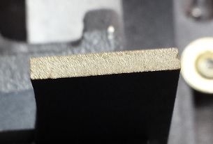

Hi guys, I started working on a parring knife for the wife and I put a test piece of left over 1/8" thick 52100 in the forge and toaster oven when I tried to heat treat it and then temper.
sorry if the picture isn't as clear as it should be, I took about 20 and this was as close as I could get.  It kept wanting to focus on the vise instead of the blade.
I heat cycled them 3x, then went past critical and quenched.  Then I put them in the toaster oven at 350 for an hour.  After that I put them in the freezer overnight.  This morning I went out and put the test piece in the vise and put a crecent wrench on the end of it to flex test it and it broke very easily.  So Do I need to temper at a higher temp, or go longer?  Any thoughts would be appreciated.

I was thinking 350 f. was too low. Make some test coupons and try drawing the temper farther. But, yeah a paring knife is pretty thin I'd try something more forgiving. Then again I'm not a bladesmith guy, my opinion is FWIW.
Kevin Cashen gives some great info on heat tratment for 52110 (as usual) here: http://www.cashenblades.com/steel/52100.html , but does not specifically detail tempering temperatures, as these are variable depending on what ultimate hardness you are trying to achieve.  However, a quick 5 second google search has one supplier, specialty metals, recommending a minimum of two tempering cycles at a minimum of 400 deg. F.
As regards flexibility, a thin crossection will make your knife more flexible (1/8" thickness is very thick for a paring knife, IMHO).  Proper heat treatment and material selection will ensure that it doesn't either take a set after a bend or break while bending, but the actual amount of flex under a fixed load is proportional to the blade thickness for most steels, as far as I know.  Personally I don't know why you would want a paring knife to be flexible, but I"m sure we have different ideas regarding what an ideal paring knife will be used for.
Hi guys.  Thanks for the input, it is muchly appreciated.  I found the Dry Ice discussion from 2012, so I will skip the trip to the freezer.
I ended up bumping the toaster oven up to 400F and put the steel in for an hour, then tested with the crescent wrench.  It didn't break as easily, so I put them back in the oven for another hour at 400F.  This time I could lean on the wrench and it didn't break.  So I'll update my notes and call it good enough for now.
