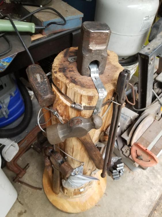

HojPoj Posted January 29, 2019 Share Posted January 29, 2019 As big as you can get, but I used an 8-pounder since it's what I had. I ended up taking a bit off the flanks so I could work some bends/corners a little easier. It works well enough for starting out. As Link to comment Share on other sites More sharing options...

Frosty Posted January 29, 2019 Share Posted January 29, 2019 HojPoj's sledge head mount is as nice as they come though I'd probably use a heavier strap to anchor it. Something I could run a couple lag screws through and really cinch it down. A sledge head mounted in a similar manner is all the anvil traveling blacksmiths used for I don't know how long and many still do. There is a video of a Japanese master swordsmith forging highly desired swords on a block of steel about that size. Your anvil really only needs to be a little bit larger than your hammer head. If you watch some videos of 3rd. world and the Japanese smiths working do ONE thing differently. Mount yours at a comfortable height to work at standing up or sitting in a wheel chair. Correct height is more important than size. Frosty The Lucky. Link to comment Share on other sites More sharing options...

Eventlessbox Posted January 30, 2019 Share Posted January 30, 2019 It's a kubota L305. Beat up quite a bit. And yet I'm sure with just a bit of work it will probably outperform a lot of newer models. Not that I have any use for it. Hoping to sell it to cover probate costs for the estate. For correct height am I looking for my hammer to strike flat if I'm swinging it naturally? I'm building the mount this weekend. And will be using some 4x4s in a manner similar to one I saw in another thread. Link to comment Share on other sites More sharing options...
JHCC Posted January 31, 2019 Share Posted January 31, 2019 Yes, that is correct. If you put a board (say 1/2" thick) on your anvil and hit it with a natural swing, the hammer should leave a circular dent. If the anvil is too low, you'll get a crescent with the curved side away from you. If the anvil is too high, you'll get a crescent with the curved side toward from you. Link to comment Share on other sites More sharing options...
