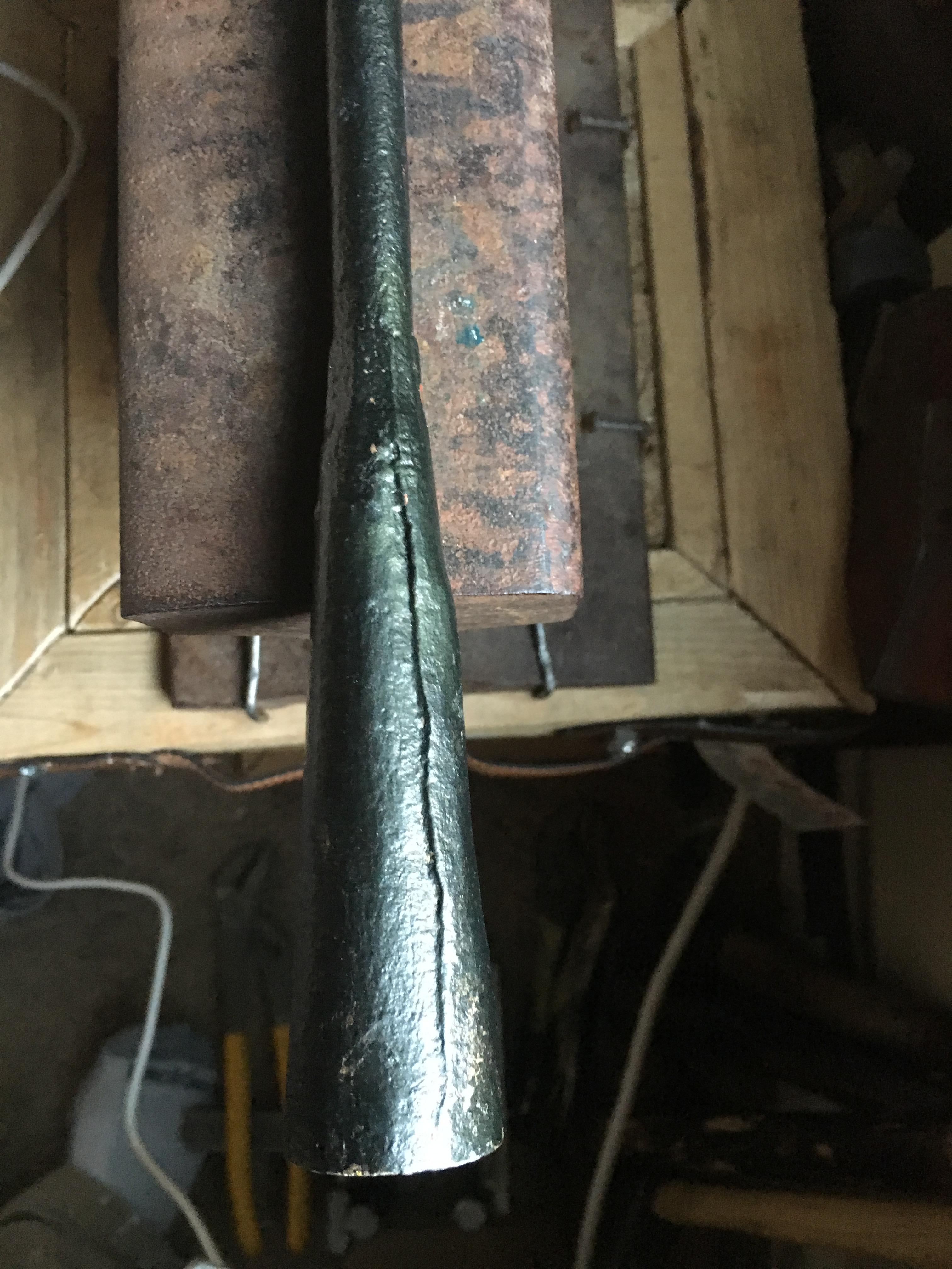

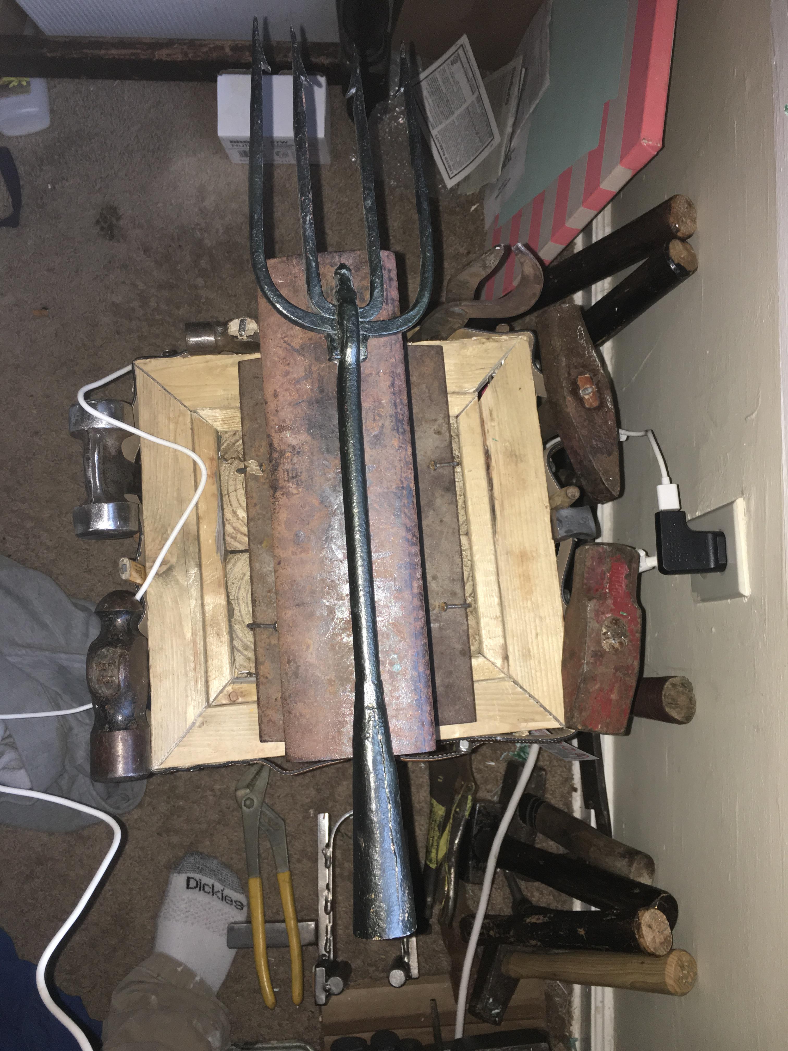

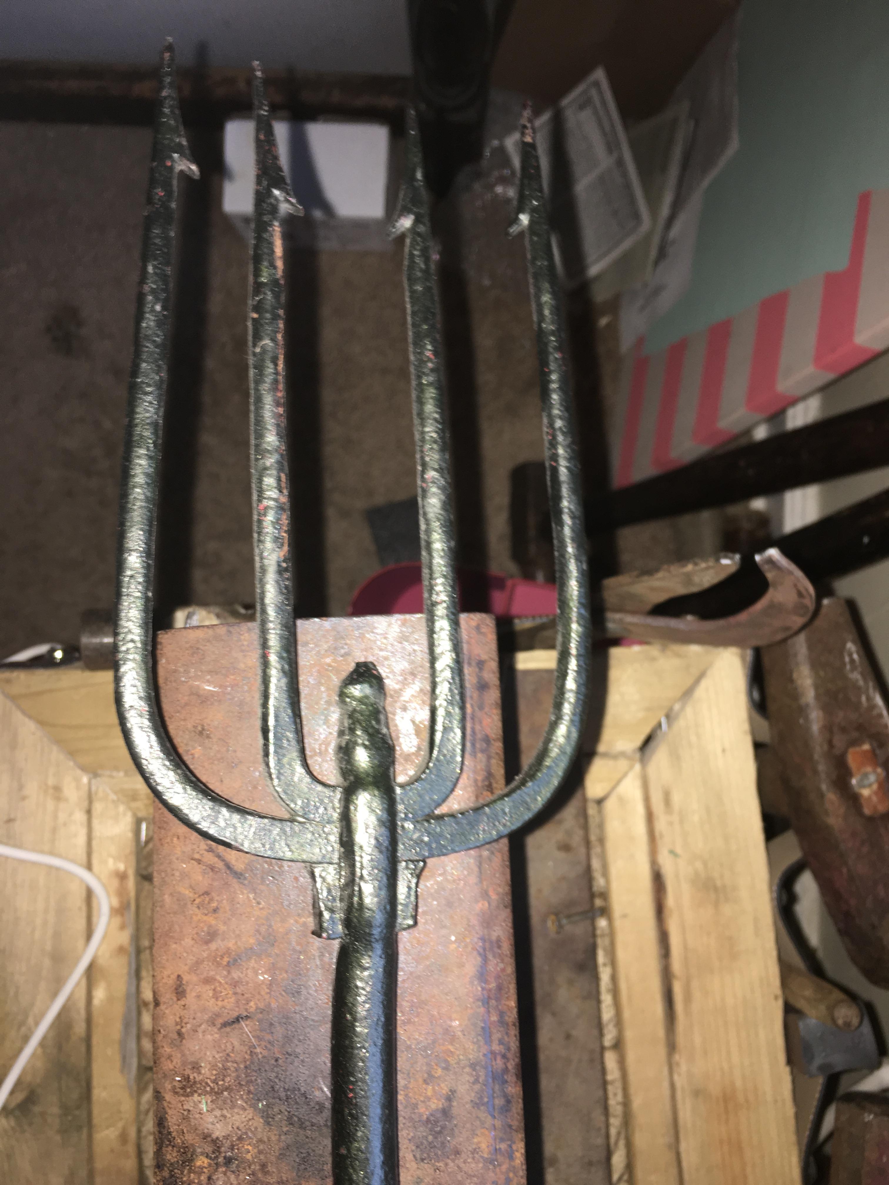

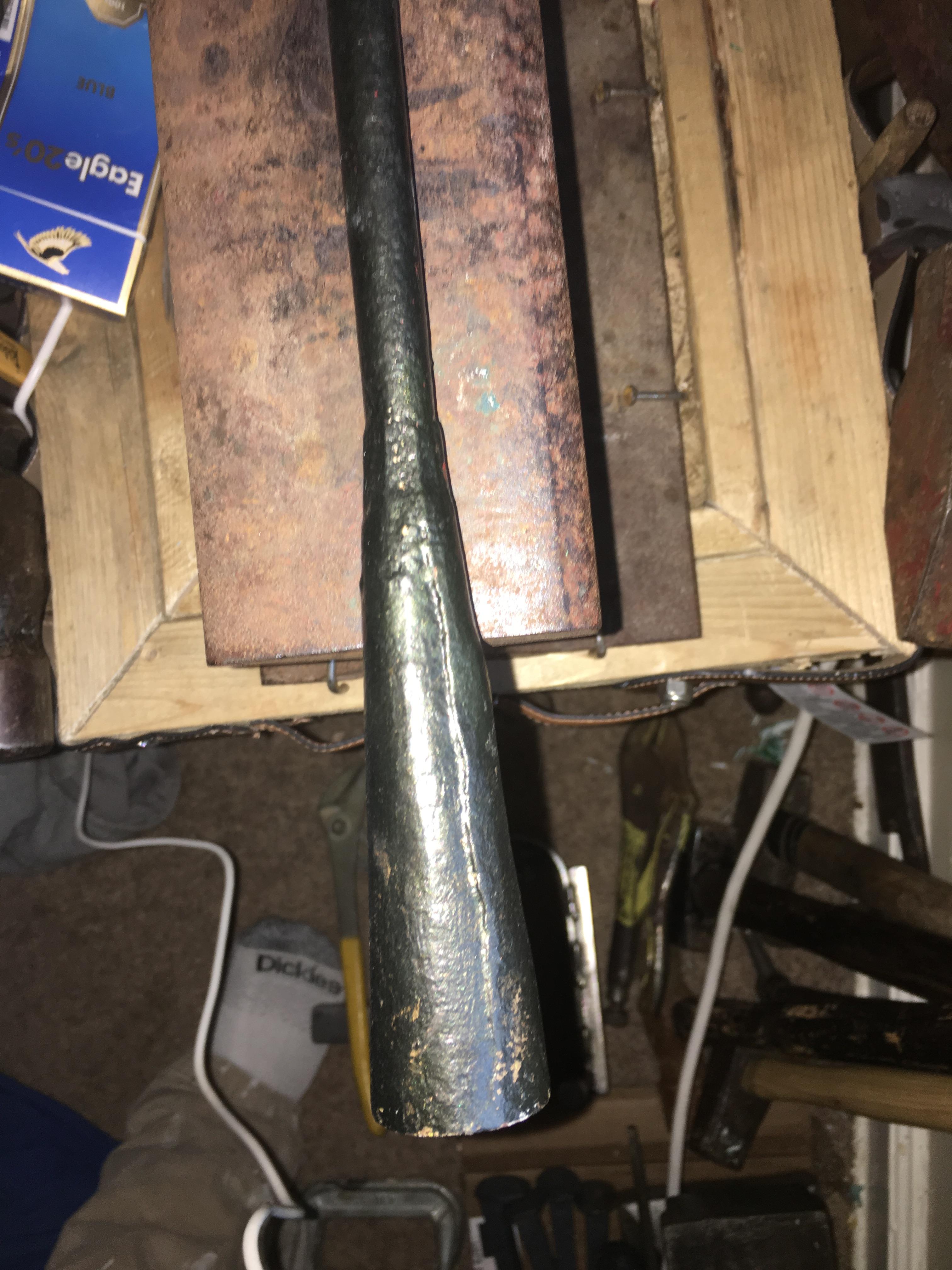

Matthew Hargis Posted May 8, 2018 Share Posted May 8, 2018 I have an old quadrant but I don’t know the quality of it or if it was forged or not. It appears to be well made but I don’t know much about how it was made. There is no date or makers mark I can find. I use it to spear gar and buffalo at night from my boat. It’s got two gar over 4’ on its resume and several small Buffalo. Here it is: what do you guys think? I hope I put his in the right thread Link to comment Share on other sites More sharing options...
Daswulf Posted May 8, 2018 Share Posted May 8, 2018 Yup looks forged. Link to comment Share on other sites More sharing options...

Frosty Posted May 9, 2018 Share Posted May 9, 2018 That's pretty darn cool. It'd be a quadent meaning 4 teeth, trident meaning 3 teeth. Definitely forged and probably pretty old though not ancient. Pre-arc welding would be my guess, the tines are wedged in. The barbs make me think giant frog gig. I don't know if I'd want to poke something I needed that to poke. Of course if I ran across one it'd be nice to have. Frosty The Lucky. Link to comment Share on other sites More sharing options...

anvil Posted July 5, 2018 Share Posted July 5, 2018 I just saw this. What a nice forging!. Then the ole blacksmith critique jumped out. It looks like the times are two pieces the inner and the outer. Since the tines are forged rectangular at the pass thru, the slit and drift must be the same size as the round parent stock, then forged down to a tight fit where the tines pass thru. This looks like a weakspot in the design. I would start with either two pieces of square stock or one piece of rectangular stock for the tines 8nstead of starting with round stock. Then I would slightly taper the tines and round them to the barb's. This would add a bit of strength at the pass thru, and make the whole tool more balanced. One more "add" to my decades long "to do" list. Link to comment Share on other sites More sharing options...
