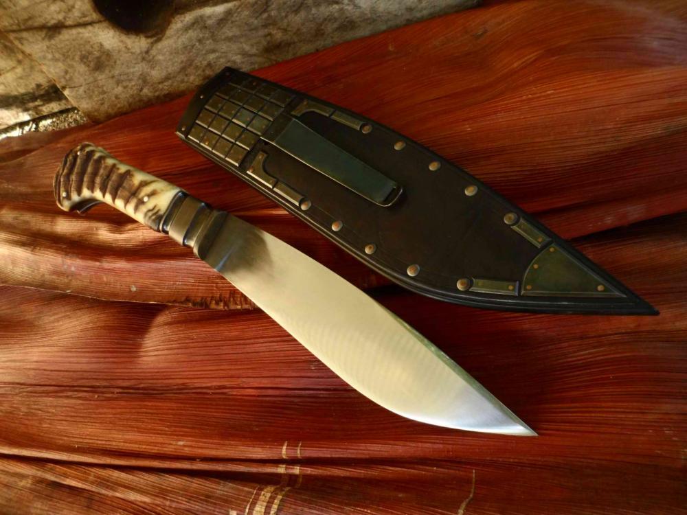

Some kind of ancient warriors belt knife, ....from whatever culture.

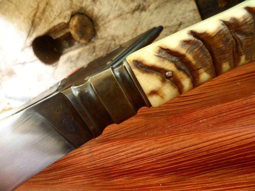

Blade is 205 mm long and ground from 1.2442 (115W8), bolsters made from mild steel and the scales are rams horn pinned with sterling.
Overall length measures 305 mm

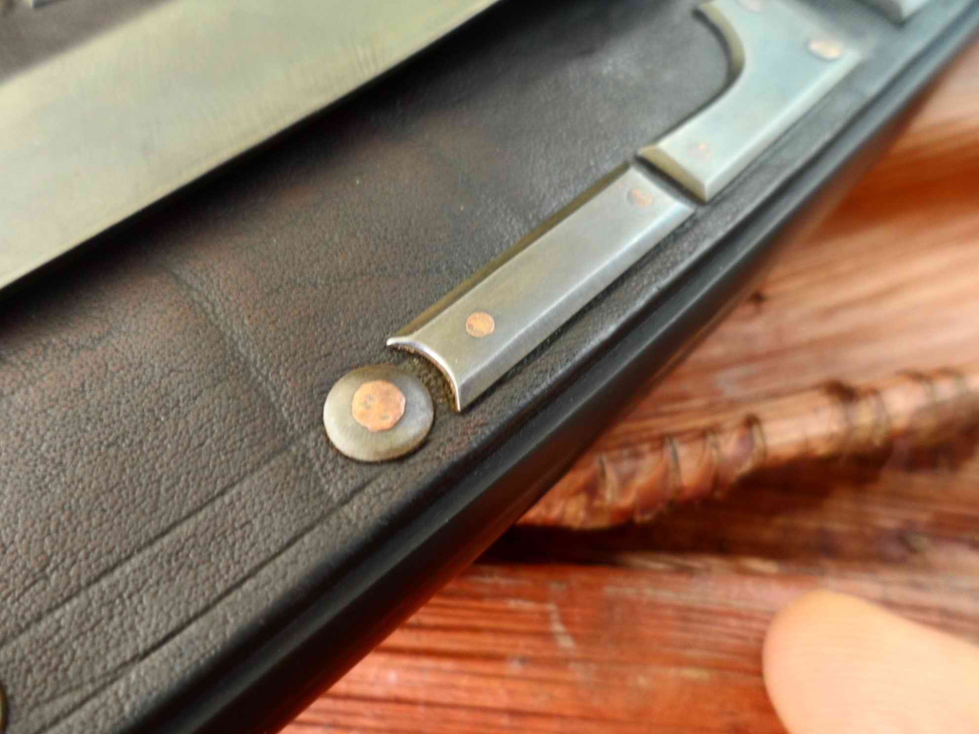

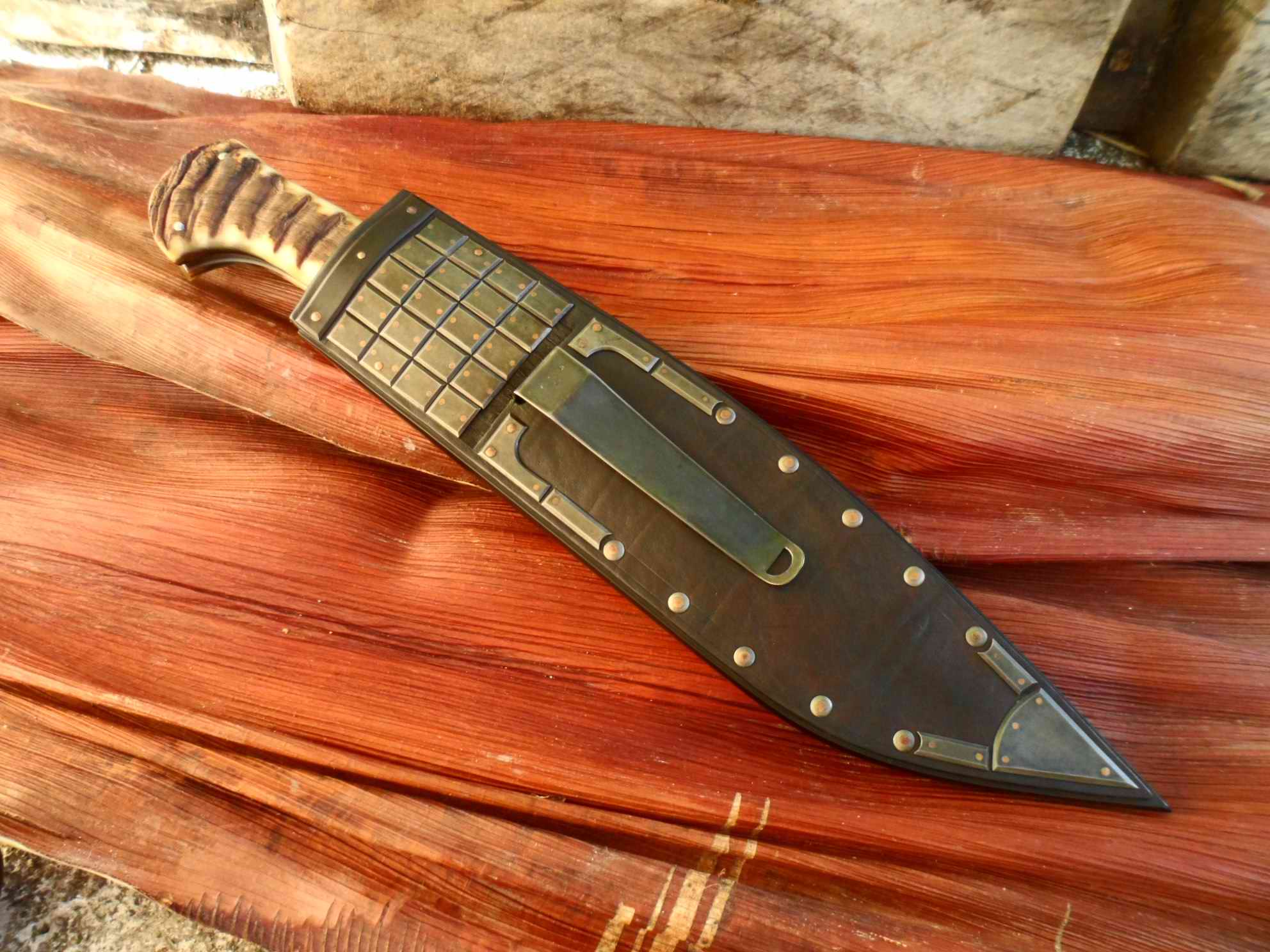

so because its a warriors knife I wanted the sheath as martial as possible.
I armored buffalo raw hide with steel and riveted it togehther with copper.All steel parts are counter riveted from the inside.The  two massive liners are made from a single water buffalo horn which had a natural radius that allowed following the blade shape.The throat is also reinforced with buffalo horn bands......at the end it consists of 177 worked parts .

I'm curious though how you colored the bolsters?? I've tried heat coloring, but never got anything like that.. Was it chemical? Or heat? Or?? Please advise..
Also not seeing any pins? Are they blind? Or did you weld them on?

I colored with gun blue from Birchwood and Casey.after some time the blue fades and changes in antique grey like its now.
the bolsters are pinned with 3mm pins.normally I take 3 pins and press them in a vise.
