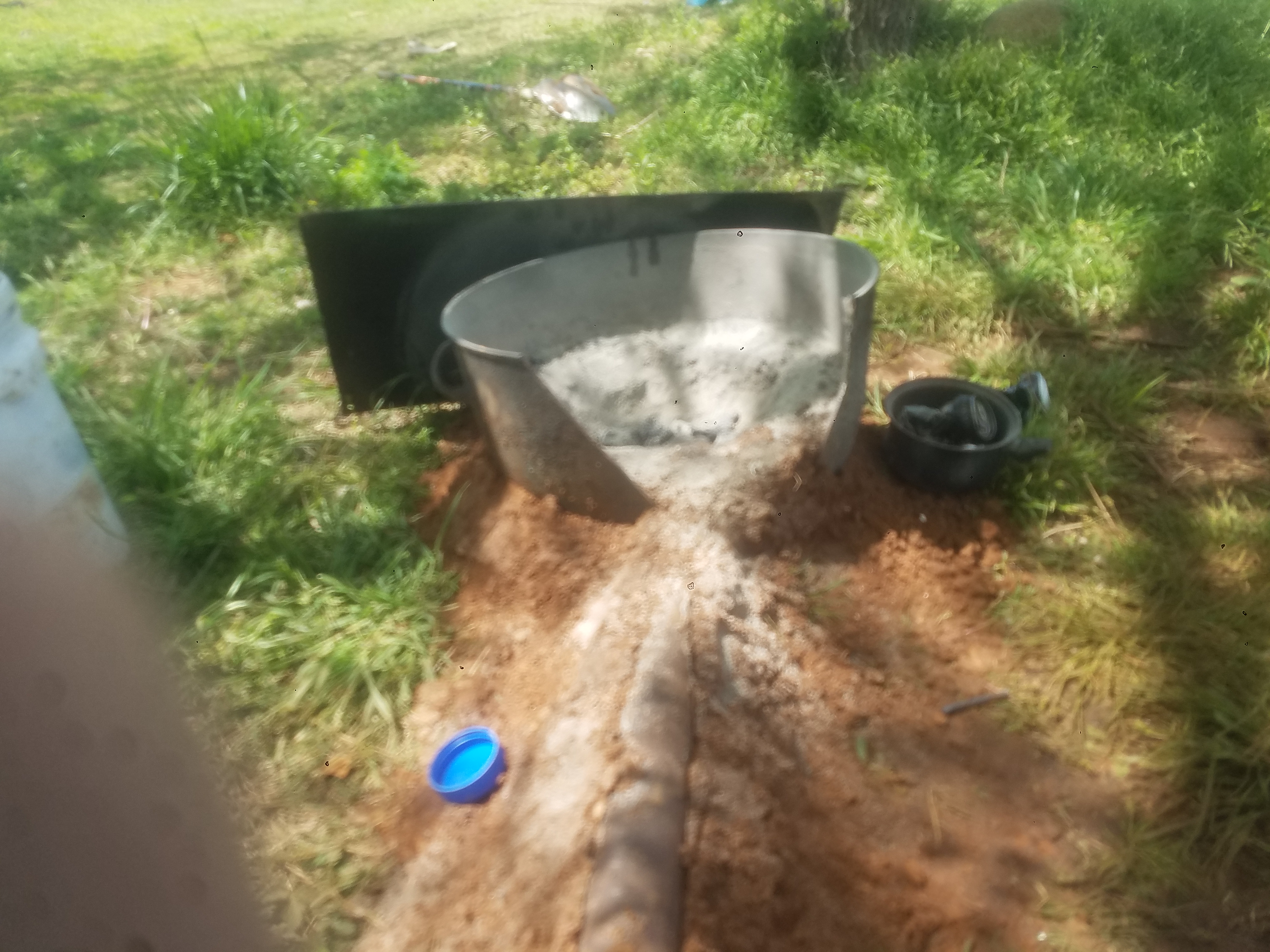

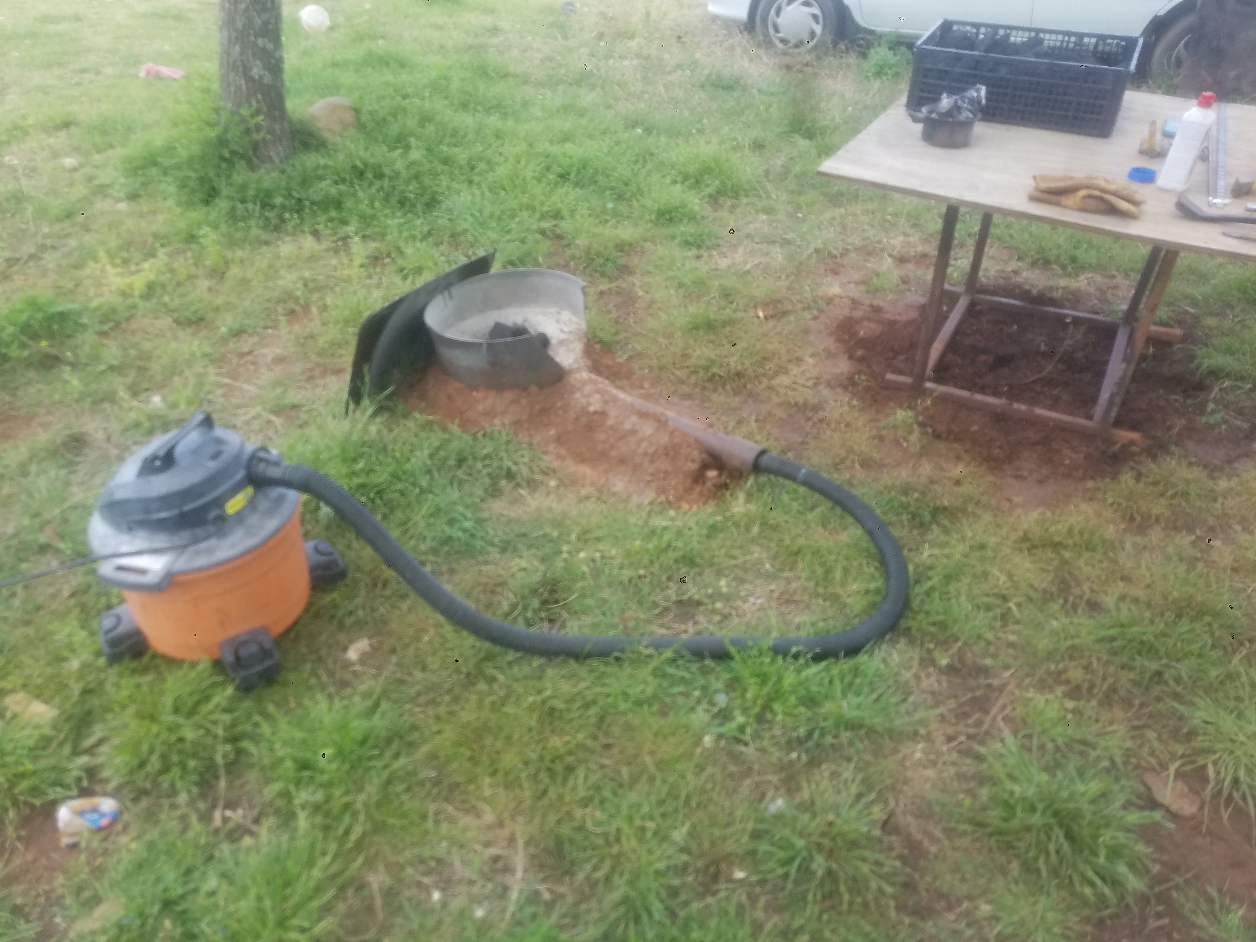

Davishomesteadandforge Posted April 30, 2018 Author Share Posted April 30, 2018 I got pretty busy over the weekend but I managed to upgrade my forge, I used a washtub and mounted it in 3/4" plywood. I'll post pictures later after work. Quote Link to comment Share on other sites More sharing options...

Davishomesteadandforge Posted May 1, 2018 Author Share Posted May 1, 2018 9 hours ago, JHCC said: Hang onto the I-beam; there's a lot of stuff you can make from it. For example, an anvil stand. That's the plan I think if I can think of a good way to mount my anvil 5 hours ago, Horacekincannon said: What part of Oklahoma are you from I would be happy to help you. Yep Washington , it's actually Cole but most people recognize Washington better. Anyone know if it's possible to pay dues for saltfork in person? I hate dealing with the post office. Also although further ado here's some pics of what i got accomplished. Quote Link to comment Share on other sites More sharing options...
Charles R. Stevens Posted May 1, 2018 Share Posted May 1, 2018 Might consider a pile of dirt to bank charcoal against. And other than keeping rain out of the forge the tub on top isn’t necisary Quote Link to comment Share on other sites More sharing options...
Frosty Posted May 1, 2018 Share Posted May 1, 2018 That's a beast of a piece of I beam. If you build an anvil stand like John's with it I definitely want to see the pictures! However if you just want to use it for a stand I'd just stand it on end and put the anvil where the web and flange meets. Maybe use the rest for a table vise, etc. stand. Even that heavy the flange will flex under the hammer if you use it as shown in the picture. Frosty The Lucky. Quote Link to comment Share on other sites More sharing options...
Davishomesteadandforge Posted May 1, 2018 Author Share Posted May 1, 2018 25 minutes ago, Charles R. Stevens said: Might consider a pile of dirt to bank charcoal against. And other than keeping rain out of the forge the tub on top isn’t necisary What do you mean by dirt to bank against? Also the top portion is removable mainly for rain and wind protection 18 minutes ago, Frosty said: That's a beast of a piece of I beam. If you build an anvil stand like John's with it I definitely want to see the pictures! However if you just want to use it for a stand I'd just stand it on end and put the anvil where the web and flange meets. Maybe use the rest for a table vise, etc. stand. Even that heavy the flange will flex under the hammer if you use it as shown in the picture. Frosty The Lucky. Any ideas how to connect it up there? I considered welding it but my welding is still pretty iffy Quote Link to comment Share on other sites More sharing options...
