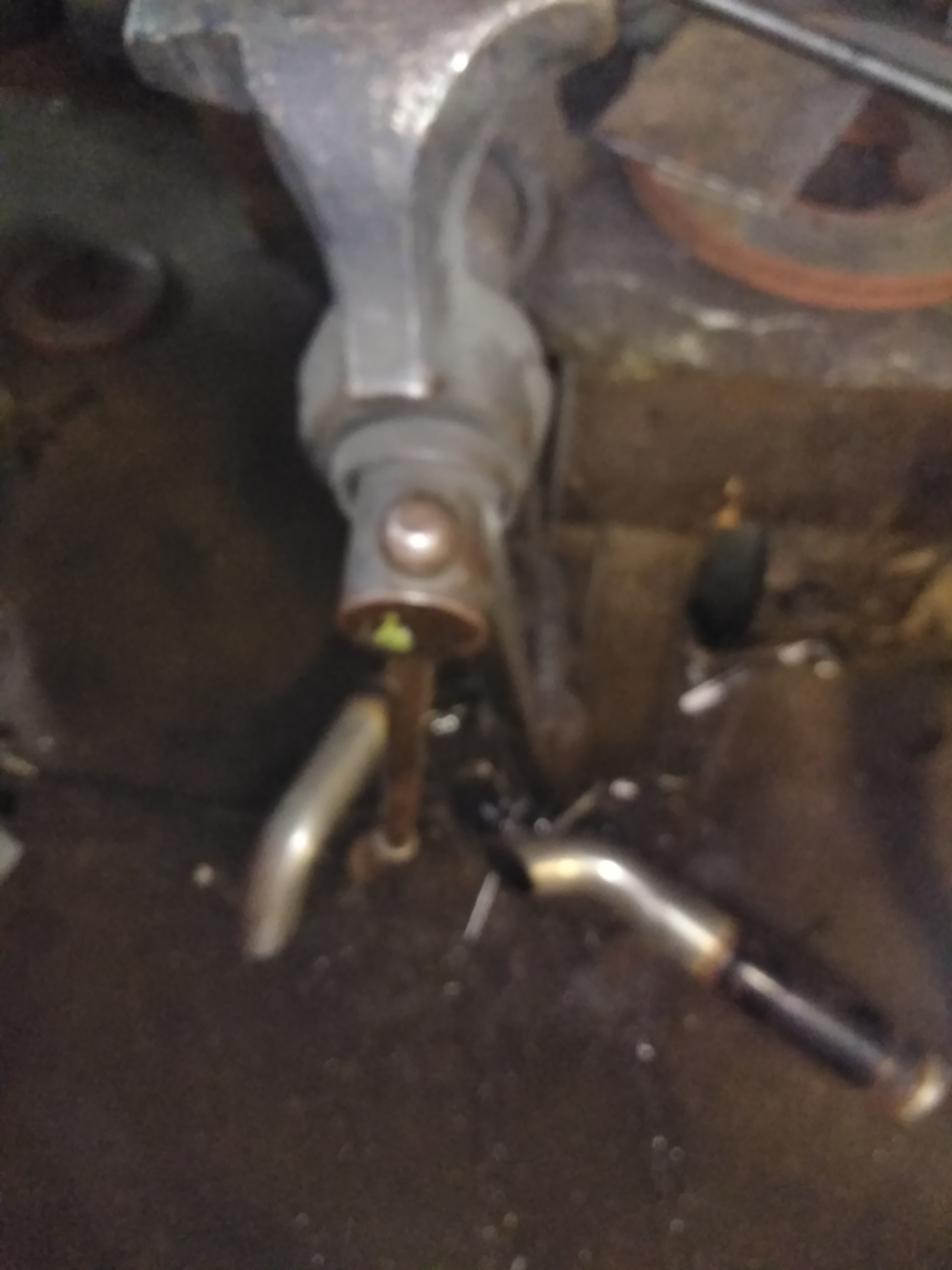

  9. Good news I had to get 2 new tires on my car this morning and the tire shop had a post vice so I was able to get pics and mesurements. I will post pics and keep you updated on the project.

  13. I was thinking of forging the parts out single pieces of material by upsetting the jaw area to get the size I need my main problem is finding good breakdowns of the different vices. So I can lay it out on paper before I start.
  14. As far as jaw width probably around 4 in and guessing around 50 pounds In case anyone is wondering I know I could buy one fairly cheap but this is how I am building my skills and I think it will be a fun project. If I was using just a lathe and a mill it wouldn't be difficult but I'm wanting to hand forge everything except the threads on the screw.
