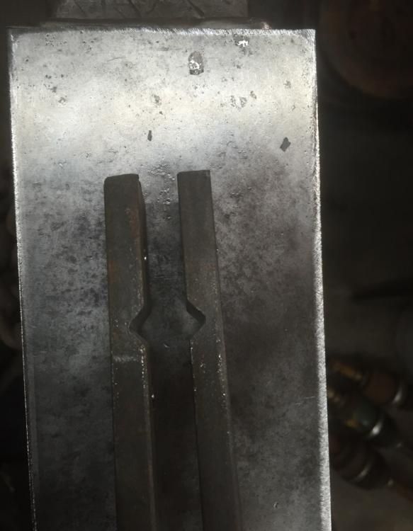

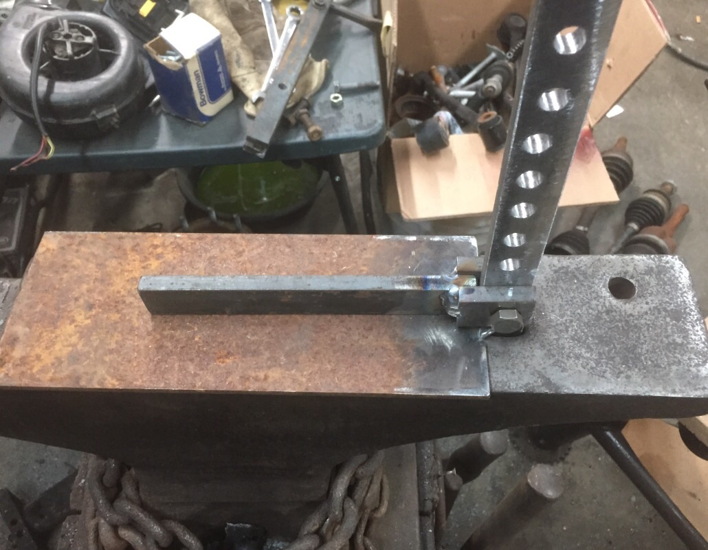

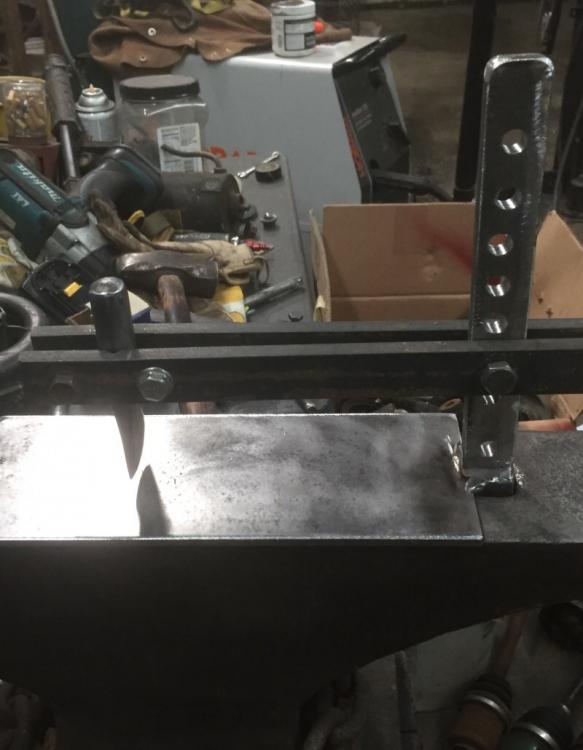

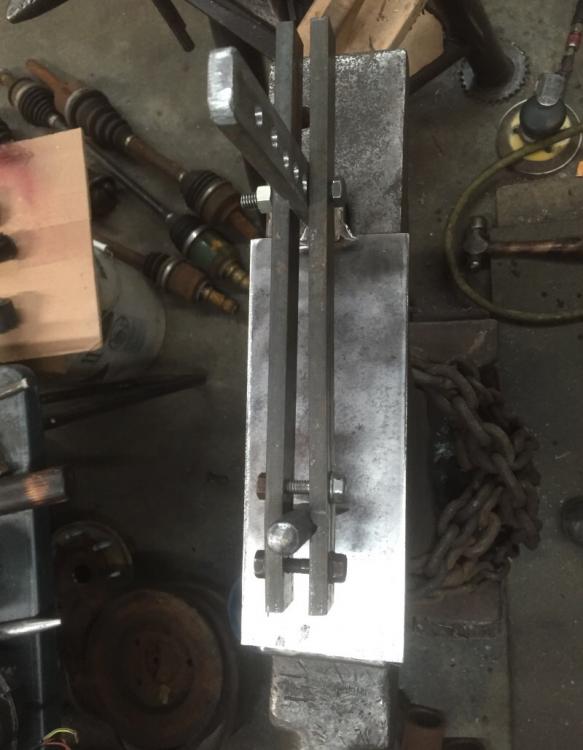

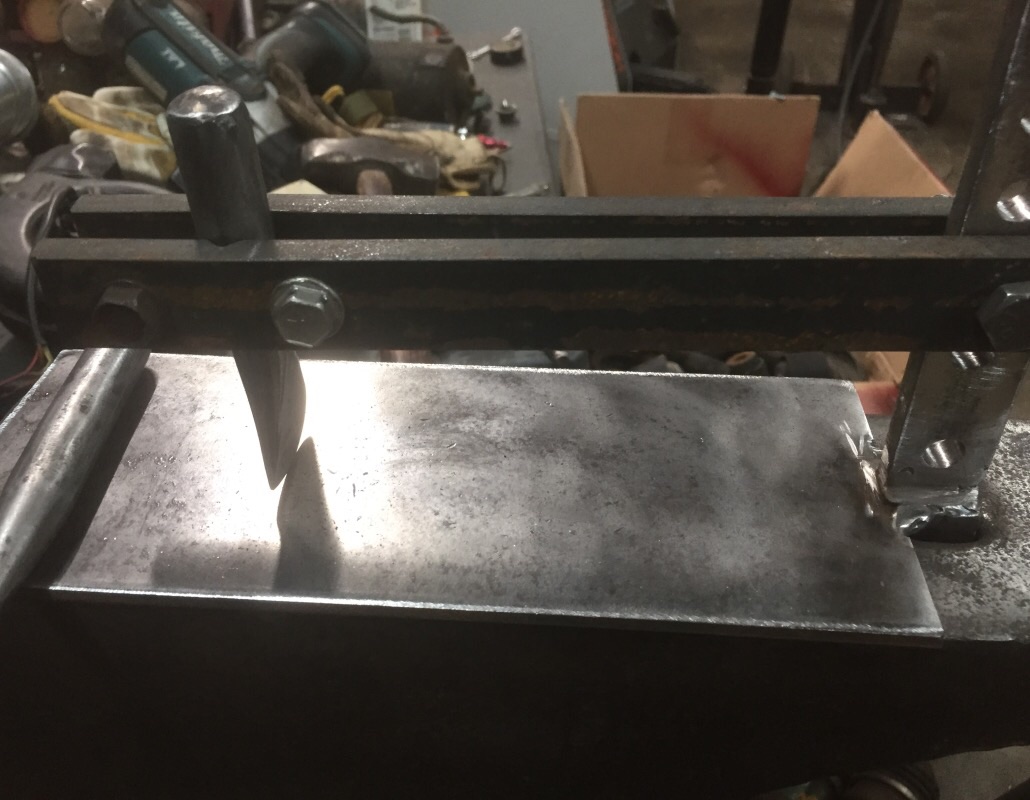

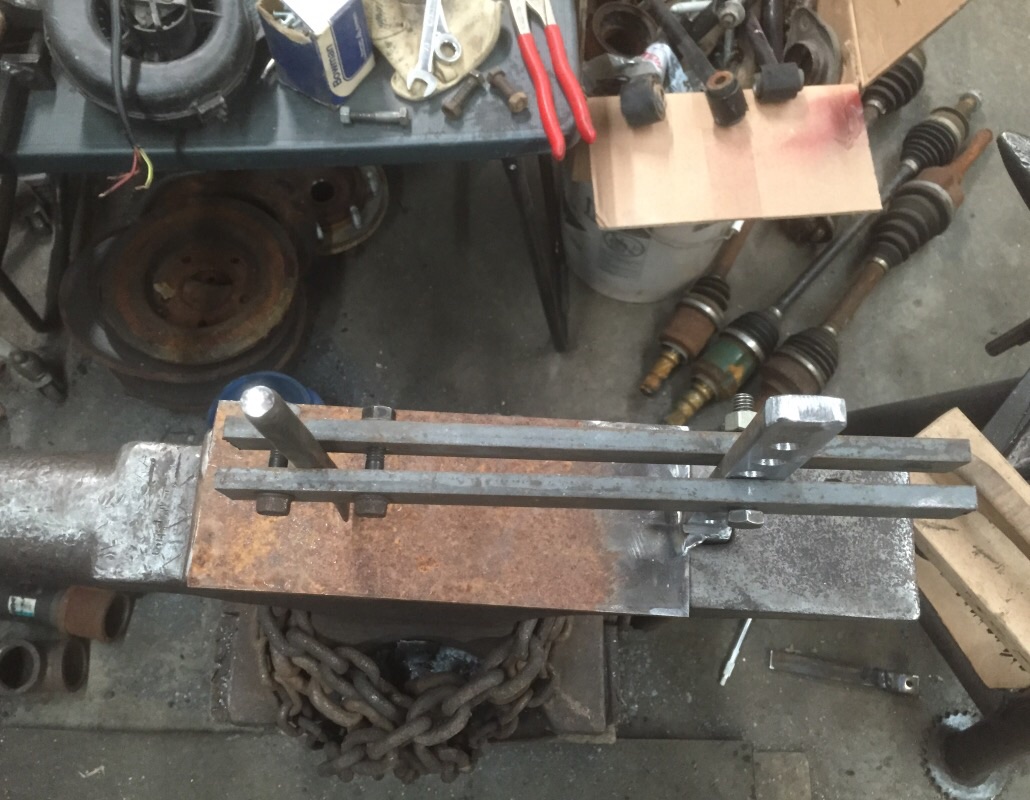

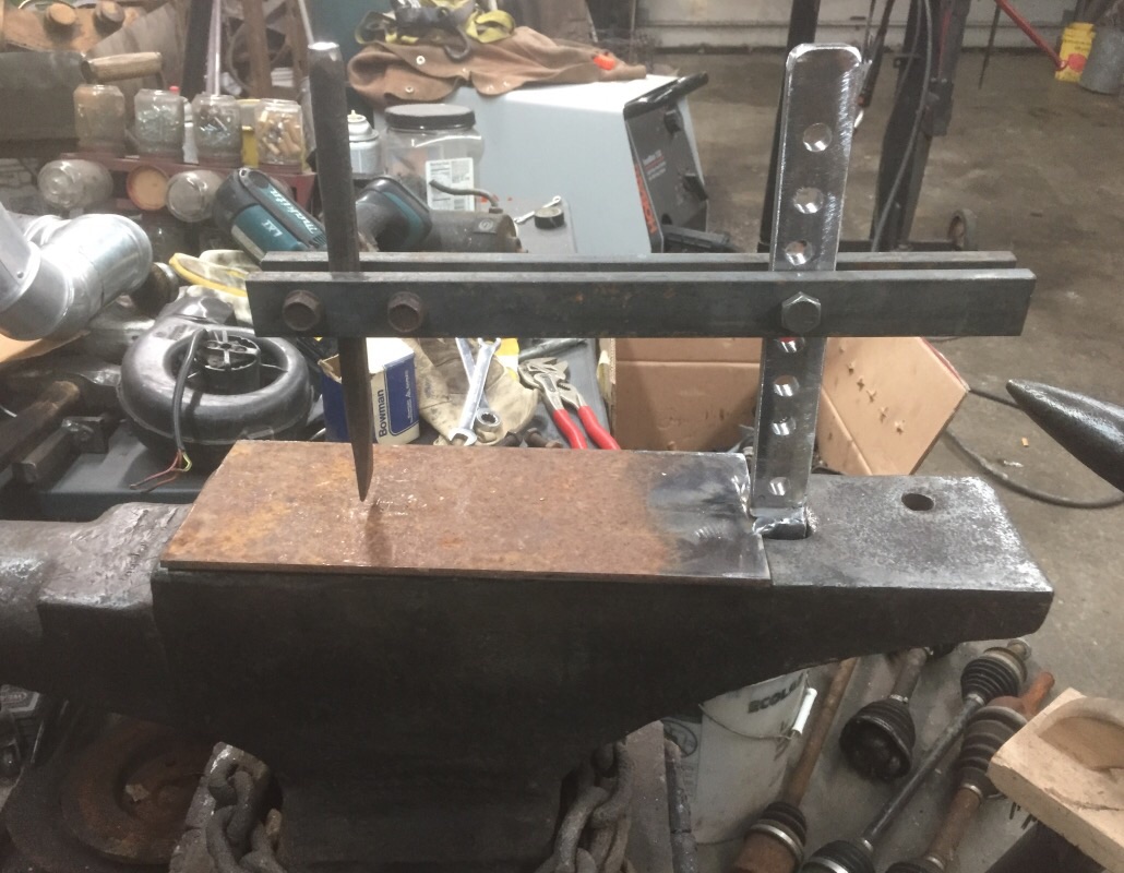

Daswulf Posted April 25, 2018 Share Posted April 25, 2018 This is a work in progress inspired from another chisel holder I saw while searching for something else. The one I saw only had one connecting point/ arm. I thought it was a brilliant idea but would be better if it had 2 connecting points.( an arm on either side of the vertical.) and different height adjustment. The other didn't have an extension to hit on the reverse to unwedge a punch. also with this tool I saw that different arms could be made for use as a fullering tool and possibly a guillotine tool. That will be in the testing phase but right now the chisel holding function even needs tested. Hope this is helpful or inspirational to others. I'll continue this as I build and test it. It's probably been made and posted a thousand times and I missed it. Sorry if that's the case. Upper two pictures show it as the chisel holder and the third is the bottom fuller. I need to make the top one yet and some different shapes. Nothing really new just my take on it as far as I know. More to come regardless. Quote Link to comment Share on other sites More sharing options...

VaughnT Posted April 25, 2018 Share Posted April 25, 2018 Very similar to one I made some time back. The problems I had were pretty basic once I'd made it and used it a little, and wondered why in the world I didn't foresee the problems in the first place. One of those face-palm moments to be sure! It will work, but you'll run into issues with the chisel moving in the arm, rotating and traveling up/down as hit it. Also, I found the narrow upright allowed for a ton of flex in the holding arm, and switched out to a piece that was 2" wide, or wider if you have it. The extra width keeps the arms tracking properly when they want to move back and forth. I couldn't find a way to hold the chisel firmly in place and was always having to stop and readjust it. Even with a really tight clamp on the chisel, Newton's Laws continue to apply! Quote Link to comment Share on other sites More sharing options...

Jim Coke Posted April 25, 2018 Share Posted April 25, 2018 Greetings Das, A simple (V) cut in the arms at the chisel pinch point would help with tension and alignment.. Just this ol boys 2c Forge in and make beautiful things Jim Quote Link to comment Share on other sites More sharing options...
Daswulf Posted April 25, 2018 Author Share Posted April 25, 2018 Thanks Jim. That does sound like the simplest solution. Quote Link to comment Share on other sites More sharing options...

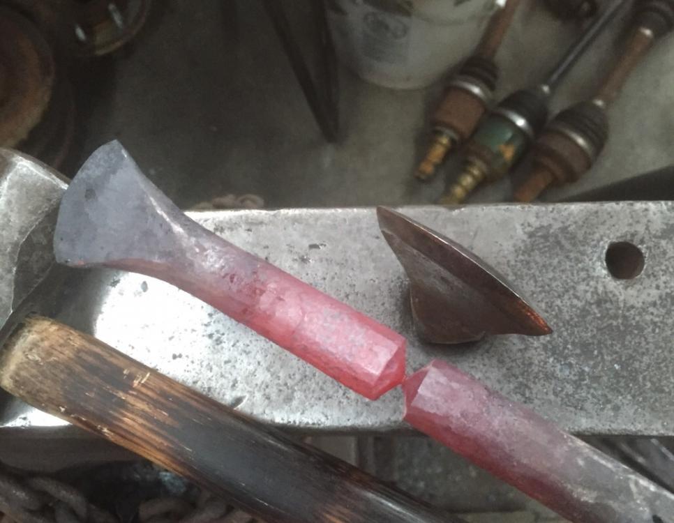

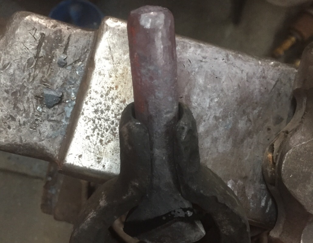

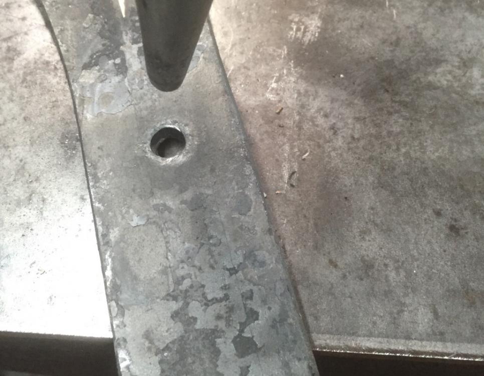

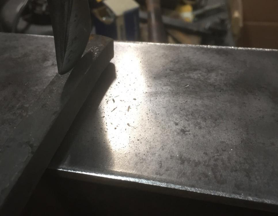

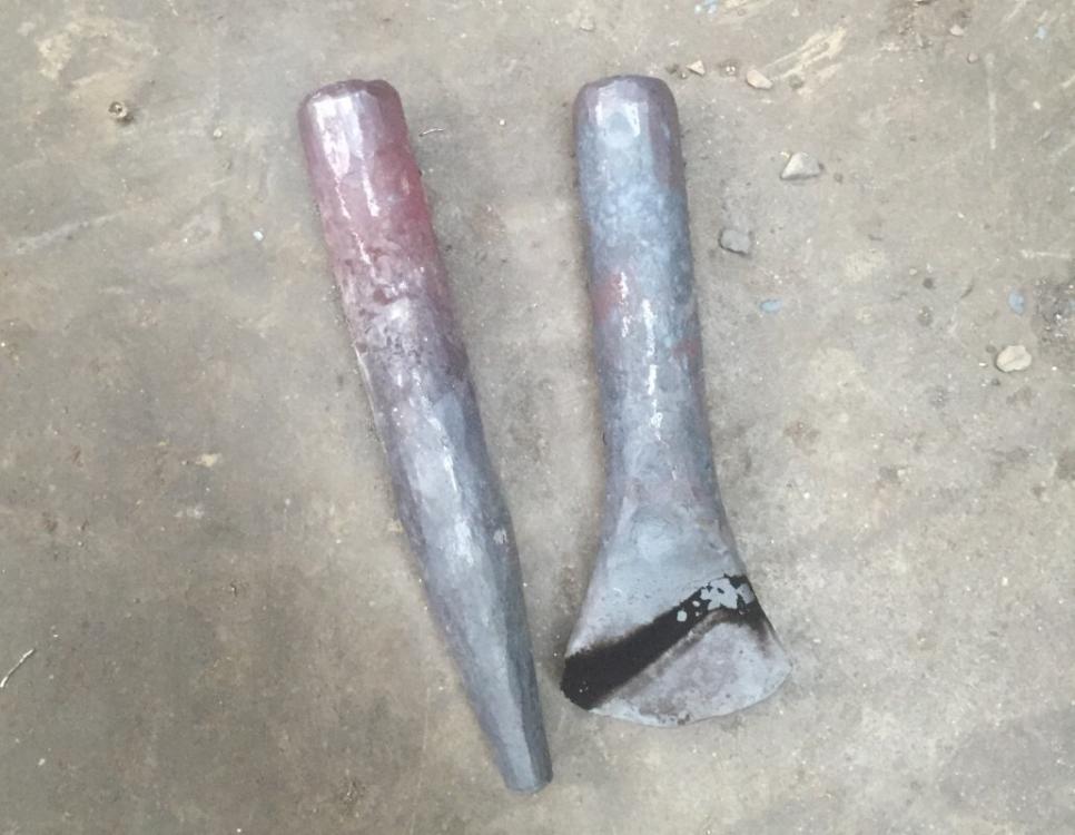

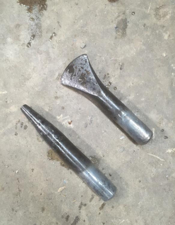

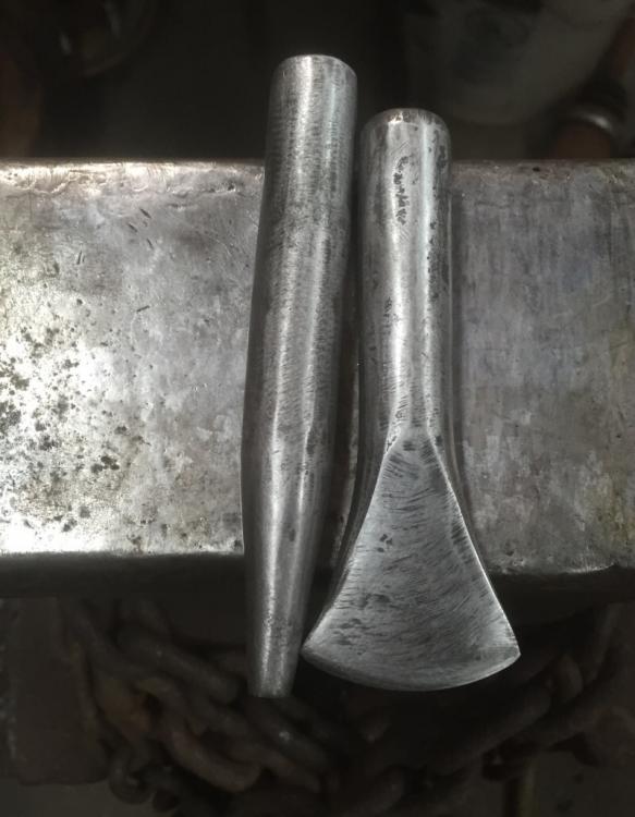

Daswulf Posted April 26, 2018 Author Share Posted April 26, 2018 I went straight to making the V in the holder. Right after I was looking at about every punch and chisel I have and they are all long or have flats on the sides that are incompatable with the v I put in the holder. Figuring i need shorter chisels punches anyway I made some out of coil spring. Will continue as needed. The tool worked great. It bounces up sand I just tap it back into place. Way more testing is needed. But the first run wasn't bad at all. Sorry, many pictures. Quote Link to comment Share on other sites More sharing options...
Lou L Posted April 26, 2018 Share Posted April 26, 2018 Really cool idea. Let me try to predict another minor possible problem that could occur during use. If you are cutting through thicker stock the angle of the swing arm will change slightly as it pivots on the support. This could cause the cut you are making to drift slightly toward the direction of the hardy. To keep it completely straight the pinch point of the chisel would have to swivel independently of the swing arm. Until you get this design down I think I’ll just continue with my practice of taping a bubble level to my top tools Quote Link to comment Share on other sites More sharing options...

Daswulf Posted April 27, 2018 Author Share Posted April 27, 2018 I'll get back to this next week some time. one main use for this for me is just scoring lines on stock for fancier twists. I do believe I'll make an adjustable side stop. Just from testing it out quick I can tell it will be easier then holding stock or tongs between my legs to score it. With other tasks, sure I'd like it to be versatile, perfection in all other tasks is not mandatory tho we can always try to see how far we can take it. Quote Link to comment Share on other sites More sharing options...

Frosty Posted April 29, 2018 Share Posted April 29, 2018 Make the tool holder L shaped with the leg down. The second arm doesn't have to be on top nor heavy. The rear pivot doesn't need to be connected directly to the post either but it'll need a guide or it'll be all floppy. I like a piece of tubing for the slide on the post, weld the pivot ear to it. Drill the front and rear pivot holes at the same time, stack tack and drill so they match as perfectly as possible. Heck, make a drill template so you can make different purpose built tools without having to adapt to the holder. Same for the bottom die. I've given it some thought over the years just never built one, I never really had the need. Frosty The Lucky. Quote Link to comment Share on other sites More sharing options...
rockstar.esq Posted May 1, 2018 Share Posted May 1, 2018 Das The chisel might benefit from having flats in the gripping area to keep it from rotating in your holder should you ever find yourself needing to work the cut into a curve or taper. If you had octagonal flats at the gripping area you'd have 45 degree increments for positioning the cutting edge. You might also want to inscribe lines on the bottom plate showing where the center of your tool holder will land. That could be helpful for aligning a bottom bolster when you're punching, swaging, or drifting. It could also prove useful for shearing chisel cuts if you put a support block in the right spot. This thing also looks like a natural for letter punching or touchmarks. An adjustable stop or cradle might be helpful to quickly index the stock into location. Your chisel reminds me of something I saw on a Mark Aspery video. He profiles his chisels with a false edge on the thin side to provide a sighting plane to aim the cut. It's especially useful when peeking over the far edge of the work. Looking at everything there, it occurs to me that a tuna can with a magnet in the bottom could serve as a handy tool quenching cup. Deep enough to cool the contact areas, shallow enough to slide under the swing arm, and just sticky enough to avoid falling to the floor. Quote Link to comment Share on other sites More sharing options...
