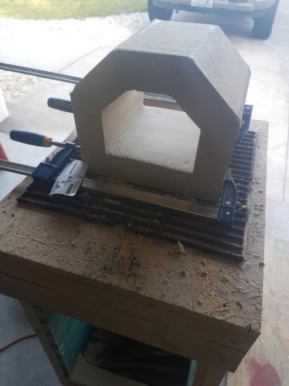

SeniorNugg3t Posted April 19, 2018 Share Posted April 19, 2018 I have zero experience with forging/blacksmithing. Looking to expand my abilities and learn from all of you. I built this forge last weekend. I didn't really have any idea what I was doing or follow any rules of thumb that I'm now learning about. Just kind of common sense approached it. This is a small mailbox style forge. Single propane burner i bought off Ebay. The design is my own and probably not the best... Well, here it is and now I'm trying to make it work right. Seems to be okay but I know there's things I'm going to need to do to really get it going. I have it sitting on a home-brew cart for now made of scrap wood. The floor and seams are covered with a 3000* refractory cement slurry. I may coat the whole inside with refractory cement for efficiency. I think to help with the burner depth, I'm going to build up the wall on the right where the burner comes in with the refractory cement and form a bit of a flare to it around the hole. Or, i could build a stand off on the outer frame mounting straps to recess the burner a bit and grind away some of the brick in the hole to make a flare shape. I may go with the cement method as it will reduce volume, and probably improve efficiency as it should keep the bricks from absorbing as much heat, or maybe a combination of both cement and stand off. Burner is pointing just left of center and my thoughts are the heat will hit the floor where the work will be placed, and bounce around circulating the heat, also alleviating much back pressure. The back wall is movable to allow for exhaust and longer pieces to be passed through. So I fired it up the first time the other night and there's a few things I want to discuss. For sure I have to address the burner mounting. It's too deep in the forge and the flare is getting hot. I don't have the burner tuned very well either but it surely pushes some heat lol! I have a lot of blue flame coming out of the mouth for the forge. Not sure what to do there. I've read it can be good and bad? https://photos.app.goo.gl/29NewFGoKtem0iby2 I've got a lot to learn... Please let me know what you think and what I can improve upon. Thanks! Quote Link to comment Share on other sites More sharing options...
ThomasPowers Posted April 19, 2018 Share Posted April 19, 2018 Hard or soft firebrick? If it's hard it looks like a terrible gas hog and the extra fuel it will go though would pay for a better insulated forge *quickly*. How do you plan to use it? Hard to make suggestions on how to improve it for use if we don't know the use planned. Blacksmithing can be anything from doing delicate hair pins and flowers to welding up 20 pound pattern welding billets and improving the forge would be quite different for those examples. Quote Link to comment Share on other sites More sharing options...
SeniorNugg3t Posted April 19, 2018 Author Share Posted April 19, 2018 It's hard brick. I can line it with Kaowool or refractory cement. I'm mostly wanting to work with shaping round and flat rod for now. general work. in the future, learn forge welding, make some knives. I have some split bricks for inserts to reduce volume as well. Did the video work? I'm at work so I can't get hardly any videos to play. Quote Link to comment Share on other sites More sharing options...

ThomasPowers Posted April 19, 2018 Share Posted April 19, 2018 First of all may I say that your construction looks very well done indeed; (I might be worried about expansion and contraction differences in the materials vs the heat they see). However that "style" is not very appropriate for a hobby forge. Lining it with refractory cement which is seldom insulative does not help the basic problem---you need insulation. A forge is a heat balance: heat in vs heat out. The firebrick surround is basically just a waste. A nice 2" thick layer of kaowool will do very well indeed. The shell around the kaowool isn't very important, I've used a tin from christmas popcorn as the lightest I've used and a section of Oxygen welding tank as the heaviest shell I've used. It's the kaowool lining that is the heart of the forge. Covering it is mandatory to avoid health issues with the wool shedding with use. Have you read Wayne Coe's site about propane forge building? Commercial firebrick forges are designed for 24x7 heating and hard usage and are very expensive to run! (And even they are now often rebuilt with insulative refractories due to soaring energy costs.) I would remove the firebrick and put some thin unplated sheet steel inside it conforming it to the straps already in place and line it with 2" of kaowool and put the appropriate covering material on the inner face of the kaowool and adjust the burner. Put split firebrick on the floor on top of the kaowool to deal with abrasion in use. Adjust the burner for proper length inside the forge and use the removed firebrick as front and back doors, not as efficient as insulative stuff but a lot better than nothing. A lot of the heat transfer in a propane forge is infrared, "letting it all out" is very inefficient. Can you tell us where you got that idea for a forge so we can warn off other new folks? For example there are a LOT of really bad youtube videos on building really bad/inefficient forges. We generally get told of them when people come here because they don't work worth beans. Often to the tune of "I've blown my budget making something that won't work" or even my least favorite: "I can't afford to build a forge correctly; so I built one that will cost many times more to run and it doesn't work". (I'm at work in Mexico and cannot run videos at all.) Quote Link to comment Share on other sites More sharing options...
SeniorNugg3t Posted April 19, 2018 Author Share Posted April 19, 2018 Thomas- The idea was project driven. I'm working on building some cool heavy medieval wood/steel furniture and wanted to forge the straps and the hardware. My wife likes the industrial type tables and whatnot and there's just so much garbage out there with guys nailing a bunch of pallets and pipe together looking like a 7th grade shop project gone wrong and lacking quality craftsmanship. The firebrick was super cheap and picked up locally for under $25 and I got a bunch of it. So i went with it knowing it was going to absorb a lot of heat. I think once I tune and set the burner properly, I'll get through the current projects I have going and then do like you said. Probably knock out the brick, plate it up, and throw some kaowool in there. I went into this with both feet with minimal/no knowledge on the matter. Only real money spent was on the burner. the rest was pretty cheap. I'd still chalk it up as a win because drinking beer in the garage and cutting up firebricks and welding scrap steel together is still cheaper/better than hanging out at the bars and the information learned is priceless. Thanks for your thoughts and honest input. Quote Link to comment Share on other sites More sharing options...

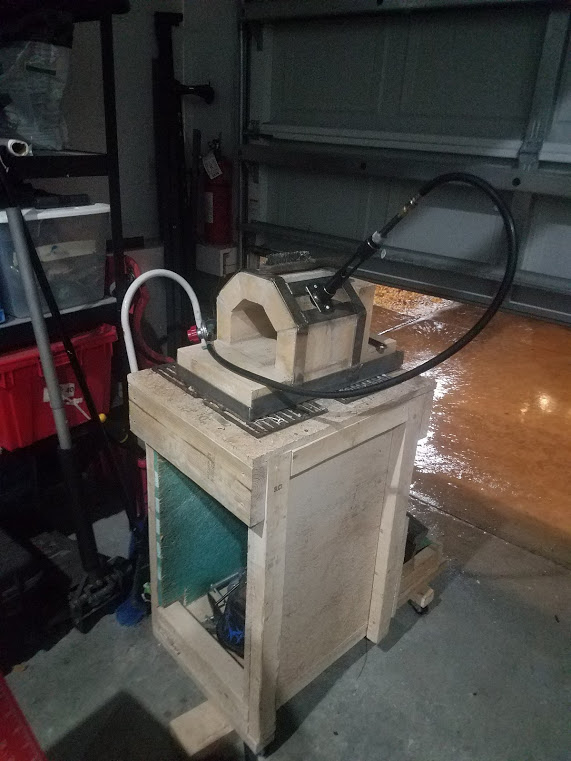

Mikey98118 Posted April 20, 2018 Share Posted April 20, 2018 I see good and bad ideas in your forge; how much changes you may want to make, would be much clearer if you light it up and post a photo of how hot it gets as it is. Before you run your forge...P-L-E-A-S-E move your fuel hose away from the forge body; where it is, you're likely to have a propane-fueled fire in short order!!! Quote Link to comment Share on other sites More sharing options...
Frosty Posted April 20, 2018 Share Posted April 20, 2018 Welcome aboard Nugg, glad to have you. Thank you for serving, much abliged. Not a bad job for just jumping in. Take a look through the gas forges section here and the most recent thread "Forges 101" for how we're building efficient gas forges currently. Hard fire brick is good for doing torch work on so you aren't cutting, burning and warping bench tops. Please don't tell me I don't have to tell you NOT to use an anvil for a bench to torch stuff on. PLEASE. In general a outer insulating forge liner made of two layers of 1" 8lb. ceramic blanket refractory commonly called Kaowool. Rigidized with a fumed silica solution to encapsulate fibers and stiffen the blanket making it stronger and more durable. A hard inner liner, AKA Flame Face of approx 1/2" layer of a 3,000 f. rated, water setting, castable , high alumina refractory. to provide flame contact resistant, mechanically durable and welding flux immune inner surface. A large flat floor like in your forge could probably stand maybe 3/4" hard refractory deck and a little extra kiln wash. (see below) Lastly and recommended though not actually necessary, is a high zirconium content kiln wash. This provides a nearly chemically inert surface even at welding temperatures. and is an efficient IR re-radiating material so more thermal energy you're paying for in propane is radiated back into the forge to be absorbed by your work. ITC-100 is a name you'll see almost everywhere for washing propane forges but it's expensive and there are better products. Matrikote and Plistex being two. A couple of us have been brain storming home brew kiln washes and refractory liners but I think those will be a while yet. Wayne Coe breaks up store quantities of forge building materials into sizes a person needs for small forges and he'll help you decide what you need. You're forge issues are really pretty minor for a complete NUGG to the craft. It needs some serious tweeking but I give you a well done. Frosty The Lucky. Quote Link to comment Share on other sites More sharing options...

Hans Richter Posted April 23, 2018 Share Posted April 23, 2018 On 20-4-2018 at 4:38 PM, Mikey98118 said: P-L-E-A-S-E move your fuel hose away from the forge body; where it is, you're likely to have a propane-fueled fire in short order!!! Welcome SN, a nice proper forge. After my idea a bit to open, and I'm 'beg' you to, to remove the hose from the exhaust. Quote Link to comment Share on other sites More sharing options...
SeniorNugg3t Posted April 23, 2018 Author Share Posted April 23, 2018 The picture with the hose... The forge had not even been fired yet and hose was placed on the cart to keep from running over the regulator when pushing it into the corner. When the forge is hot the hose is well clear and safe. When it's running the tank is taken off the back of the cart and placed as far away as the hose will allow. Quote Link to comment Share on other sites More sharing options...
Mikey98118 Posted April 23, 2018 Share Posted April 23, 2018 Good. Quote Link to comment Share on other sites More sharing options...

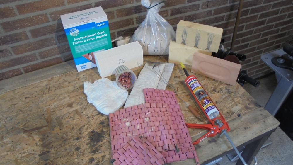

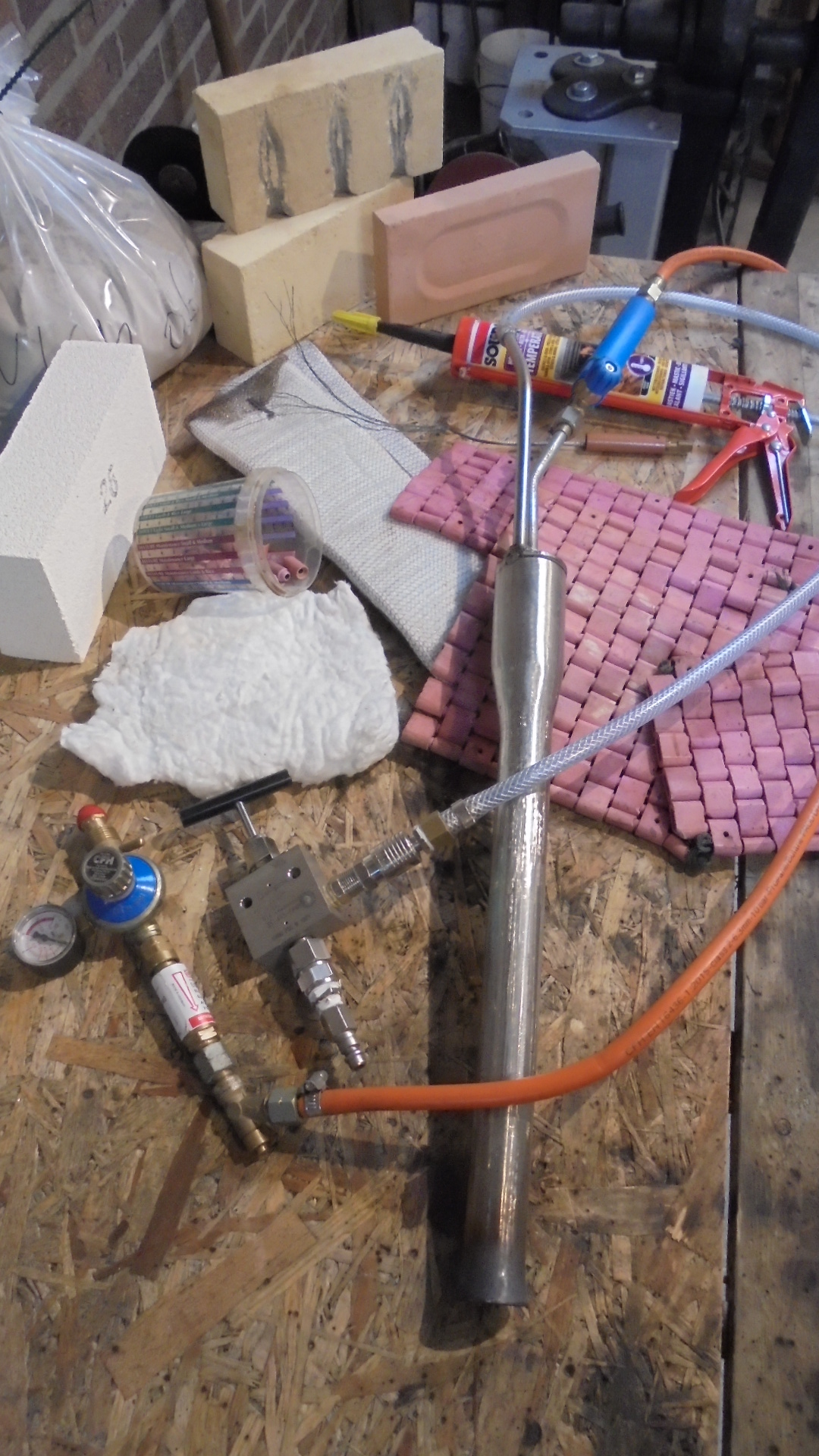

Hans Richter Posted April 24, 2018 Share Posted April 24, 2018 Hi SN, please find below a assembly of all the refractory I use to work with. All of them have their advantages and disadvantages. From left to the right. · Plaster of Paris, use it to make pouring moulds (lost wax) for my foundry or add it to the mortar for quicker stiffness because of the exothermic reaction (you have to work quiet fast) · Blanket Superwool (NO KO-wool because of an-organic fibres and less change of sintered fibres and future cancer) till I find (here in Europe) a good rigidizer I only use it for sealing leaks and small openings or cover it with mortar. · Soft bricks (low density) which I use for surfaces are not exposed to mechanical stress and not as a direct flame face · Ceramic beads for filling gaps on the flame face and to attach future superwool lining to a hardening/kiln/raku oven · Ceramic pads how are excellent surfaces and reflectors to flame faces -I have very good experiences with them in de gas forges and both of the furnaces. · Mesh enforced Superwool pads which are good backups and insulators behind the bead pads and also as insulators not exposed to the flame face · Aluminium Silica mortar to connect the bricks and fill some gaps or line/cover future Superwool structures · Kanthal-wire (heat resistant nickel alloy) to connect/make pads (superwool/ceramic beads) · Heat resistant sealant to seal small joints or gaps · Hard chamotte/fireclay bricks (high density) for body/base of furnace or gas forge as a flame face and ‘heat keeper’ (soak up a lot of energy) use them also as stone moulds for bronze casting · Hard fireclay/kaolin brick (high density) as direct flame face and resistant to mechanical stress which I use as possible for all the forge/furnace cambers. Last but not least a picture of one of the 4 hybrid forced air burners I use for the forges and furnaces. They work as normal venturi burners at normal circumstances (without pressured air injection) 1750°F at 15psi propane pressure and after pressured air injection up to 2200°F at 25psi. Need this temperature to forge weld and melting bronze. Burners are made from 1in Inconel tube. However there are not so famous as Frosty’s legendary T-burner or one of Mikey's but their miniature copycats of the burners I know and build from the oil crackers in all the petrochemical plants I worked for several years. Gents, the hunt is open shoot on it, and comment (very welcome). Cheers, Hans B.t.w. Got many of the stuff from here https://www.stork.com/en/cooperheat-equipment-shop Quote Link to comment Share on other sites More sharing options...
SeniorNugg3t Posted April 25, 2018 Author Share Posted April 25, 2018 7 hours ago, Hans Richter said: Aluminium Silica mortar to connect the bricks and fill some gaps or line/cover future Superwool structures So an alumina-silica mortar can be used to cover fire blanket? Quote Link to comment Share on other sites More sharing options...
Frosty Posted April 25, 2018 Share Posted April 25, 2018 3 hours ago, SeniorNugg3t said: So an alumina-silica mortar can be used to cover fire blanket? No. Mortar is intended to glue things together NOT survive as the flame face in a forge. It isn't that kind of refractory, just because it says it's good to 3,000 f. doesn't mean directly in a 3,000 f. fire. It means it won't fail to keep the brick, tiles, etc. in place in a 3,000 f. furnace but it has the brick, etc. to shield it. Propane fire is extremely chemically active it can be a nasty thing. Just contact Wayne and order up some Kastolite 30. He'll even help you figure out how much you need and his prices are reasonable. Why guess? Frosty The Lucky. Quote Link to comment Share on other sites More sharing options...
