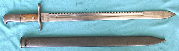

BIGGUNDOCTOR Posted April 19, 2018 Share Posted April 19, 2018 Smoggy, both the Germans and the Swiss made sawback bayonets. Many of the German ones seen today have had the saw ground off as they were deemed cruel and unusual . But as a sapper's tool they provided a long saw. The ones I have seen are all push cut and have a crosscut tooth. C.Baum, yes, we call that field dressing the game. For in the field I would check out the site I posted above as they have some good information regarding using saws in the field. Myself I would think a longer folding type blade would be best as it would allow a longer stroke and reduce the time and effort need to do the task. A thin blade will also take less effort to use as less material is being removed by the blade. Quote Link to comment Share on other sites More sharing options...
ThomasPowers Posted April 19, 2018 Share Posted April 19, 2018 IIRC "All Quiet on the Western Front" mentions what happens if you were caught with a saw backed bayonet by the enemy... Quote Link to comment Share on other sites More sharing options...

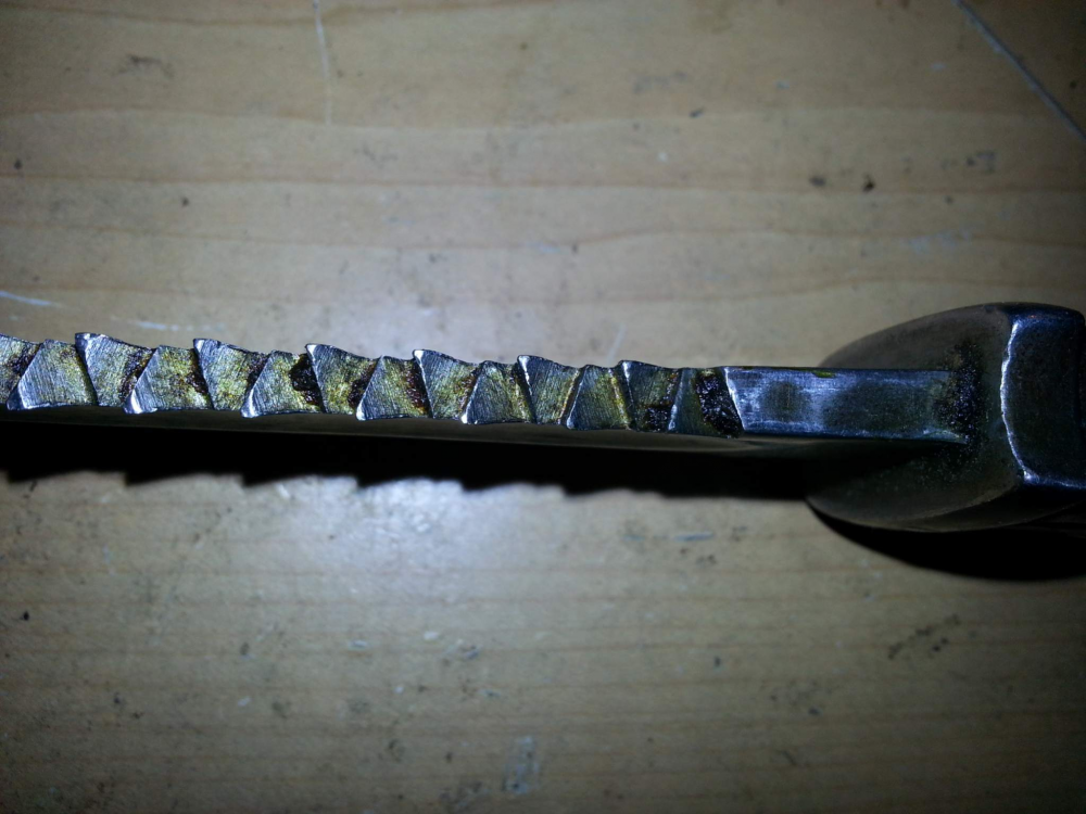

c.baum Posted April 23, 2018 Author Share Posted April 23, 2018 I never imagined such a high activity in this thread. Many thanks again! I hope you don't mind that it took a while for me to answer, i've been on a business trip. I don't think that a combined knife with a "saw back" is a good idea. I think that saw back will damage too much venison when handled too careless. On 19.4.2018 at 2:57 PM, JHCC said: Kind of like a friction-folder knife? That's my intention. On 20.4.2018 at 7:10 AM, bigfootnampa said: Personally I think a blade of 8” to 10” is about the minimum for reasonable efficiency. That's too long. Maybe you should ask the search engine of your choice for pics about "Aufbrechsäge". I hope that helps you to understand what i mean. On 20.4.2018 at 7:54 PM, JHCC said: The old "misery whips" also had different styles of tooth depending on whether they were for softwoods or hardwoods. There's some interesting detail at this page. What an interesting link! Not for cutting bones, but maybe there will be a wood saw following. Quote Link to comment Share on other sites More sharing options...
