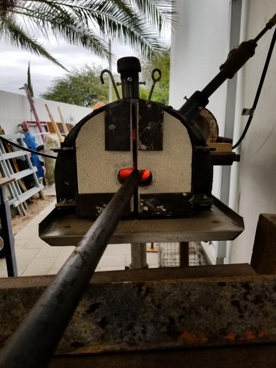

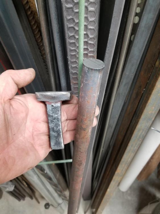

bigb Posted January 20, 2018 Author Share Posted January 20, 2018 Thanks and getting those parts should not be too hard, I have two clients who run repair shops for sports & exotics. Jaguar, Land Rover, Triumph, MG, Austin and Jenson, Morris etc. One of them works on Pantera and Lotus as well. Needless to say when we go to their shops there are many distractions. I have a couple stub axles right now, seems like they are about 1.5" though. I have 12 feet of round bar from the top of a window lentil that seems to have a bit of carbon in it from spark testing it. It is 1" or slightly bigger, going out there to measure it again today and spark test it again. Quote Link to comment Share on other sites More sharing options...

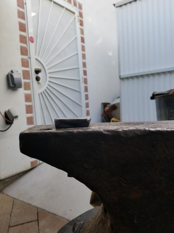

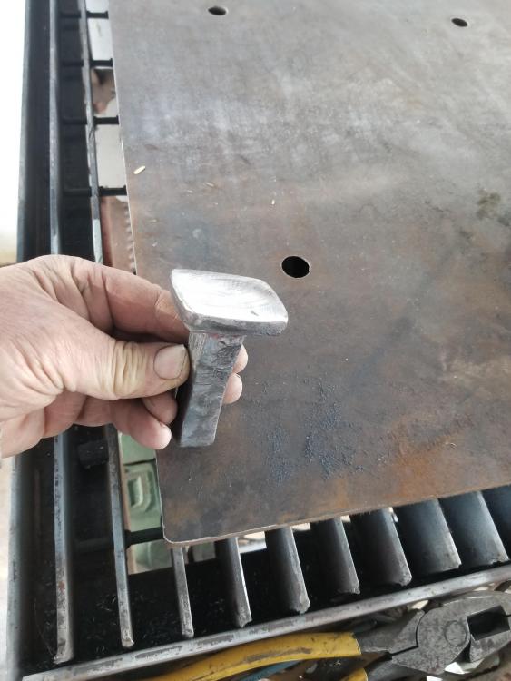

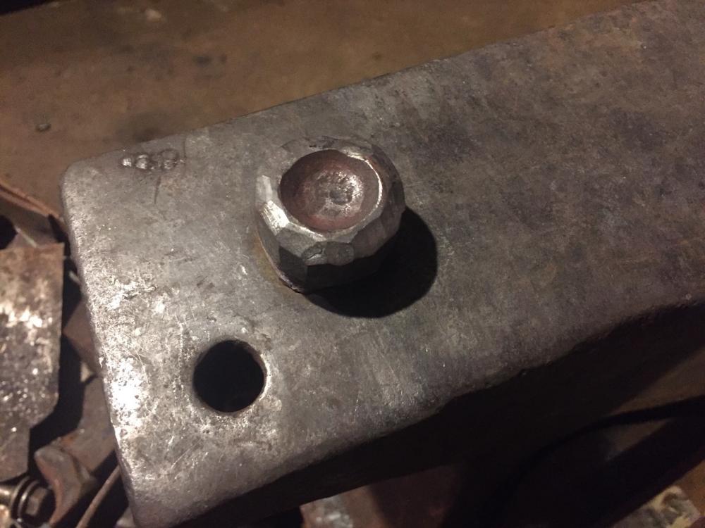

bigb Posted January 21, 2018 Author Share Posted January 21, 2018 So I used some of my 1" round from a window lentil to make my first hardie tool, a rivet bottom tool. It took a long time and a lot of fuel but I learned a lot. For my next hardie I will break out the welder and try some other suggestions. I have not put the dimple in it yet, going to make it for my tong rivets which are not here yet. Some of you may notice the hardie tool is crooked, yes I discovered that the hardie hole on my old Mouse Hole anvil is slanted toward the back of the anvil. So any tools I make for it will likely fit only that anvil. Anyway it sits very flat, does not wobble and does not jam into the hole either. Here's a few pics Quote Link to comment Share on other sites More sharing options...

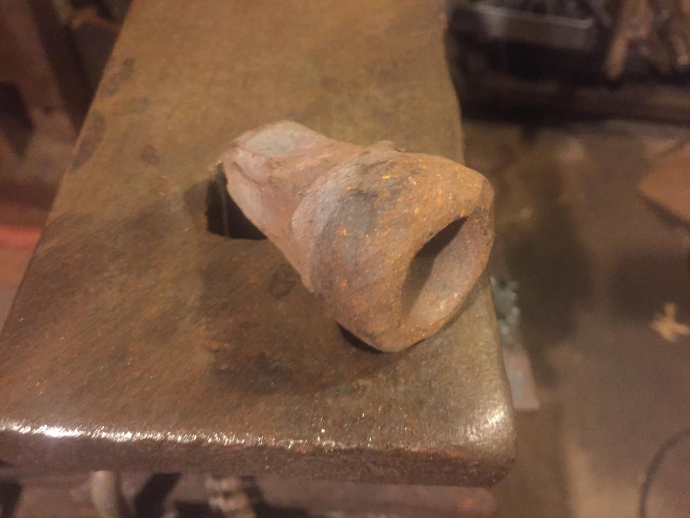

JHCC Posted January 22, 2018 Share Posted January 22, 2018 You don’t need something that wide and flat for a rivet header. Make that one into a swage, and use another section to make a header without flattening down the top, like this: Quote Link to comment Share on other sites More sharing options...

bigb Posted January 22, 2018 Author Share Posted January 22, 2018 On 1/22/2018 at 1:34 AM, JHCC said: You don’t need something that wide and flat for a rivet header. Make that one into a swage, and use another section to make a header without flattening down the top, like this: I thought about that but I am wondering how I am going to hold the tongs, the set tool and the hammer all at the same time. I might have to lay the tongs down on the anvil Quote Link to comment Share on other sites More sharing options...

JHCC Posted January 23, 2018 Share Posted January 23, 2018 44 minutes ago, bigb said: I thought about that but I am wondering how I am going to hold the tongs, the set tool and the hammer all at the same time. I might have to lay the tongs down on the anvil The rivet set in my photo is sitting in the hardy hole and does not to be held separately. Here it is on its side: Quote Link to comment Share on other sites More sharing options...
bigb Posted January 23, 2018 Author Share Posted January 23, 2018 40 minutes ago, JHCC said: The rivet set in my photo is sitting in the hardy hole and does not to be held separately. Here it is on its side: No I realize that, I was talking about the tool to form the head on top, the hammer and the tongs. 3 things to hold on to when working alone. Quote Link to comment Share on other sites More sharing options...
JHCC Posted January 23, 2018 Share Posted January 23, 2018 Just dome the rivet freehand. Quote Link to comment Share on other sites More sharing options...

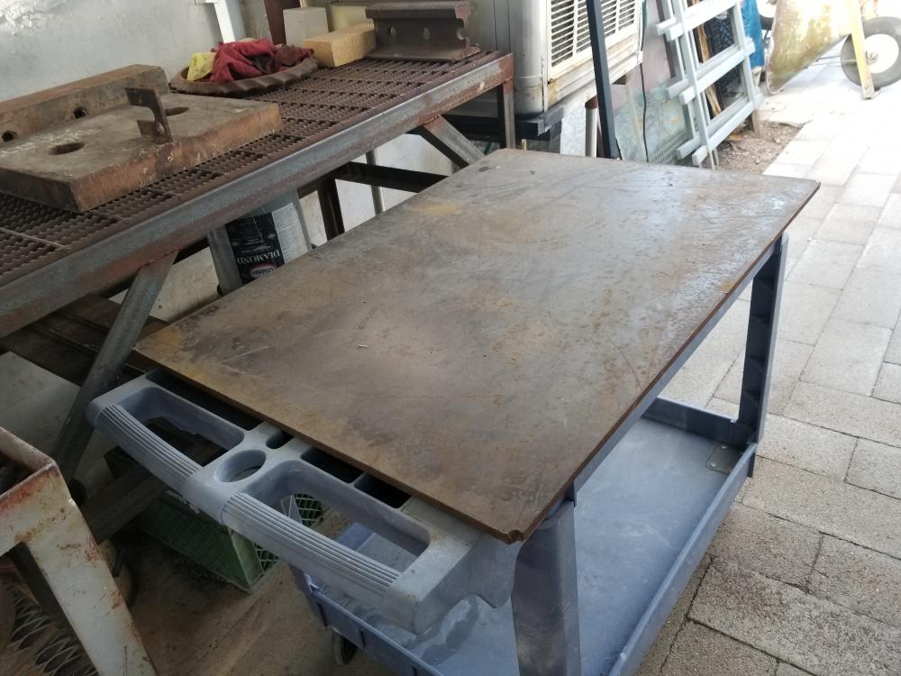

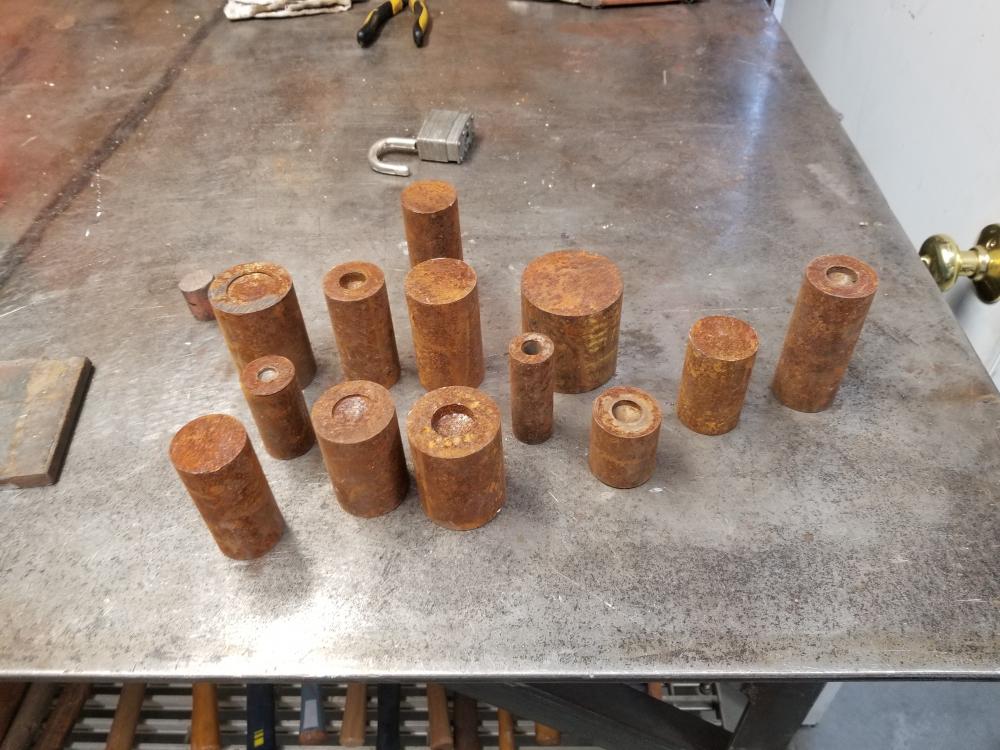

bigb Posted January 24, 2018 Author Share Posted January 24, 2018 Picked these up at the scrap yard, the larger diameter ones just look like cut offs but the smaller ones with the divots were in with a pile of machinery parts and very large gears. Thinking of using for hardie tools.Found a nice, perfectly flat chunk of 1/2" plate as well to add to my work surface. Quote Link to comment Share on other sites More sharing options...
ThomasPowers Posted January 24, 2018 Share Posted January 24, 2018 Test as some of those may only be mild steel! Quote Link to comment Share on other sites More sharing options...
