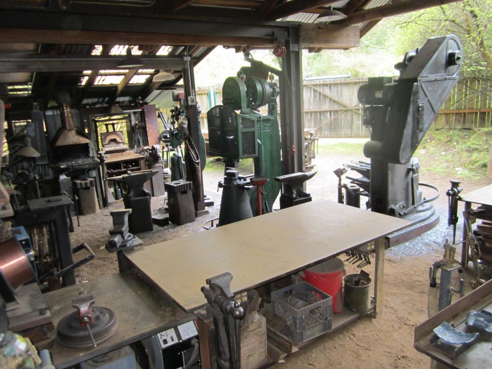

beaudry Posted January 11, 2018 Share Posted January 11, 2018 A packed dirt floor is traditional in a forge shop and easy on the body. You can dig it up to run water , air , or power lines. Anvils , post vises , fixed benches and power hammers and other stationary machinery can have proper sized concrete footings buried below grade. Sparks don't fly far when they hit a dirt floor and hot pieces don't roll and are easy to pick up. Rake it smooth and flat every few days as a way to gather your thoughts and to warm your body up for the days work ahead. Dirt floors aren't perfect, but they have a lot of advantages. I've never lost so much as a rivet in the dirt. Here's mine, 20+ years of dirt, sand , clay, scale , swarf ,crushed clinker and ash, wetted down and tamped periodicaly. Quote Link to comment Share on other sites More sharing options...

beaudry Posted January 11, 2018 Share Posted January 11, 2018 I'm sure that there is ''recipe'' for a dirt floor, but eliminating any organic matter and rocks that keep the floor from compacting is a good start. Some clay in the mix helps. Keeping it damp helps to pack it down and keeps it from being too dusty in dry weather. In addition to the inherent softness of the floor , the natural gentle contours that develop over time feels good as you move around the shop. I sweep mine with a stiff broom between times that I go over it all with a fine toothed spring rake to gather up the leaves that blow in and the small rocks that work their way to the surface. There is some maintenance involved and a lot of people would prefer to just pour a concrete lab and be done with it. I wouldn't put a wood floor in a blacksmith shop, although it was fairly common at one time. Recently ,I had an inspection at short notice from my industrial insurance company in regards to fire and ways to minimize the risk . Among other things, they seemed to like the fact that I had a dirt floor in all the areas of the shop where hot work was done. Quote Link to comment Share on other sites More sharing options...

beaudry Posted January 11, 2018 Share Posted January 11, 2018 My forge shop was something that quickly evolved in the flat area in front of my enclosed wood shop [ wood floor ] and machine shop [ concrete slab ] . Within a few months the business took off into a full time paying occupation and it grew to it's present form. At first I just had a tarp for an awning to cover the area until I built a heavy timber roof structure and some sidewalls. Even now , knowing some of the disadvantages and advantages of different types of floors, I'd still do it basically the same way. Quote Link to comment Share on other sites More sharing options...
