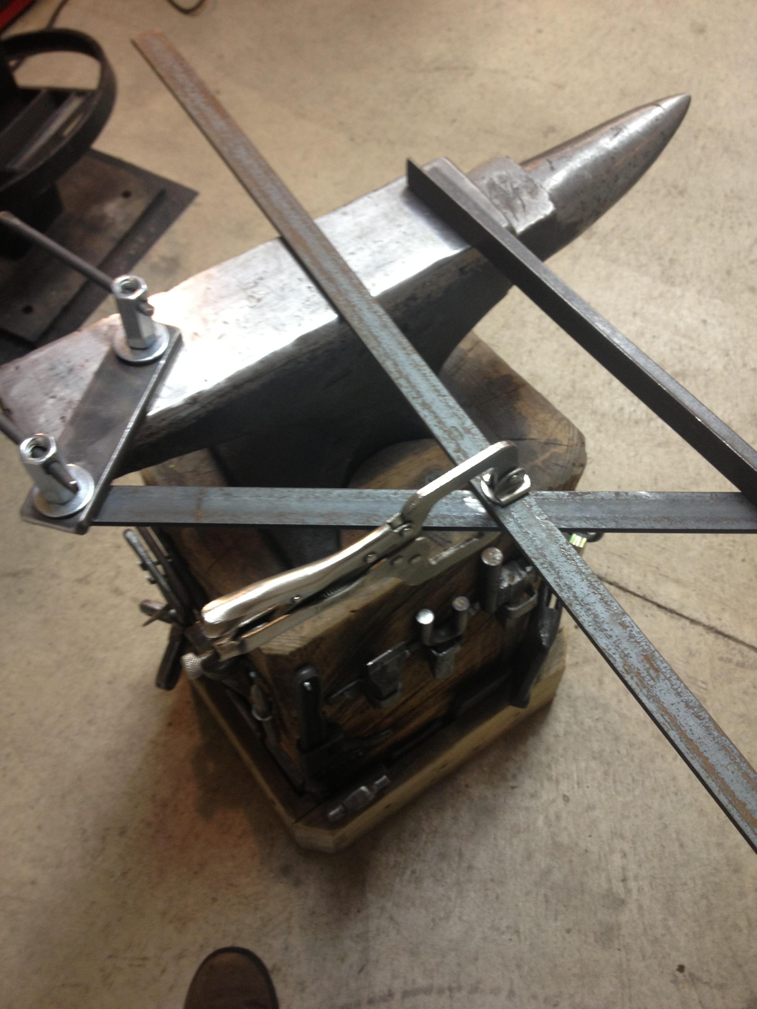

Jim Coke Posted October 24, 2017 Share Posted October 24, 2017 Greetings Grumpy, Looks like the one I designed to support long stock on the anvil ... Same concept.. Forge on and make beautiful things Quote Link to comment Share on other sites More sharing options...

Jim Coke Posted October 24, 2017 Share Posted October 24, 2017 Greetings LBS, Mine is designed for the hardi hole.. Three locking points that are just bolts with shaft connectors with a drilled hole for a handle .. This allows for adjustments and other uses .. Great tool and easy to make.. Have fun.. Forge on and make beautiful things Jim Quote Link to comment Share on other sites More sharing options...
