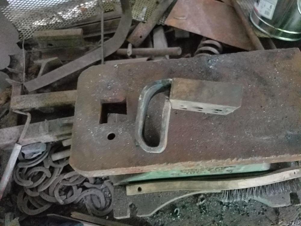

I wish I knew how to post pictures. I haven't figured that out or i'd show you a couple of ways to make weld  on shanks that are not solid, that is not forged from the same billet. One is to bend a piece of 1/4 flat stock of the same width as the hardy hole into a 'u' shape, and another is to weld 2 pieces of angle apex to apex and grind the limbs (edges of the angles)  to fit. I don't claim credit, but I don't remember where I saw these ideas. Also thanks for your service

I finally got on the home computer to post pictures. First 3 are hardy shank methods I mentioned above. I have an unpowered smithy in a gazebo (4th picture), so I don't have a power hammer, no striker available either. I have another shop building with power where my arc welder and grinders are, so forging a hardy shank isn't really an option for me. I thought these ideas for weld on shanks would be worth a look for others similarly situated.
I understand what you are talking about now.  I think i would rather go the forge a shank first and then when i see how hard it is and then may e go to this method.  Thanks for the info.
