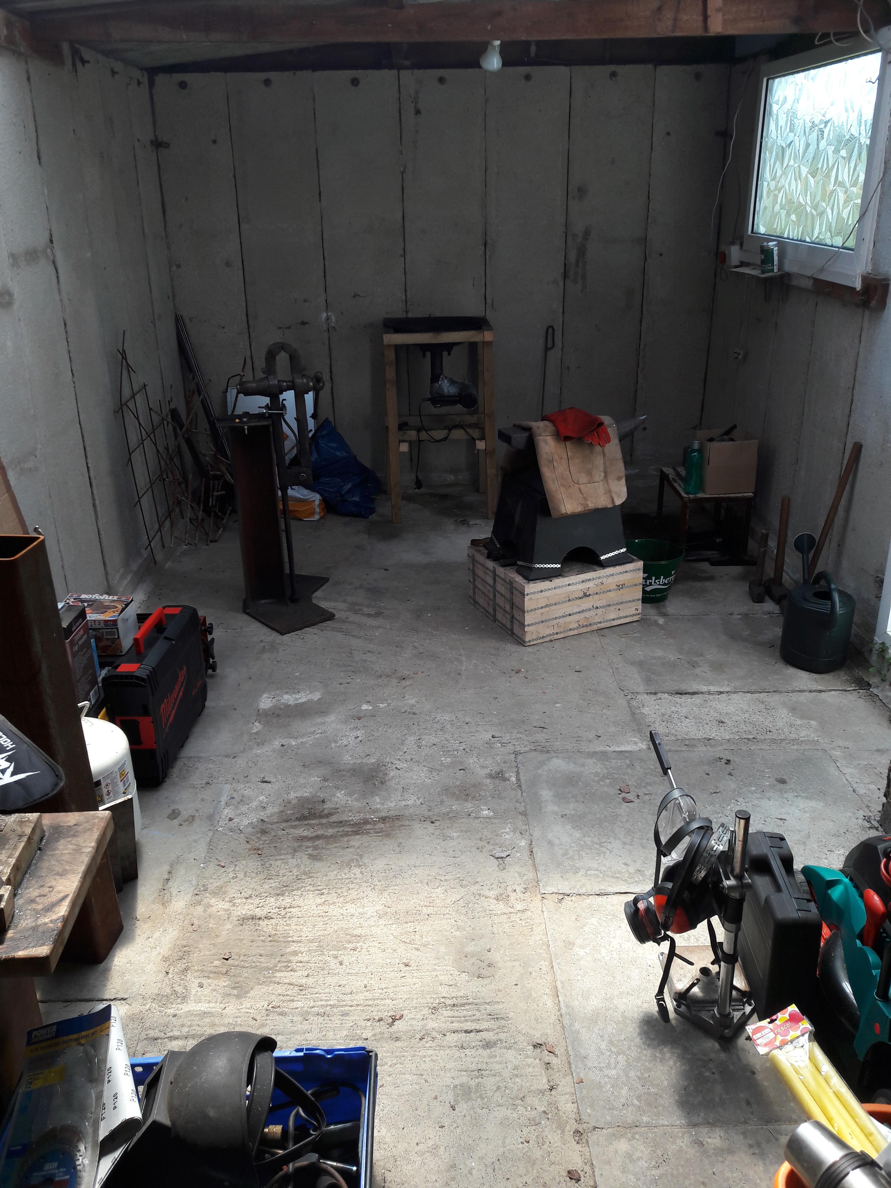

Hi All,
So I have finally moved to my new house which is amazing.
But even better is I get a new workshop which is alot bigger, it is 6m by 3m.
I will be making alot of changes, to get it just how I want it and thought I would show all of you.
Thanks,
Luke

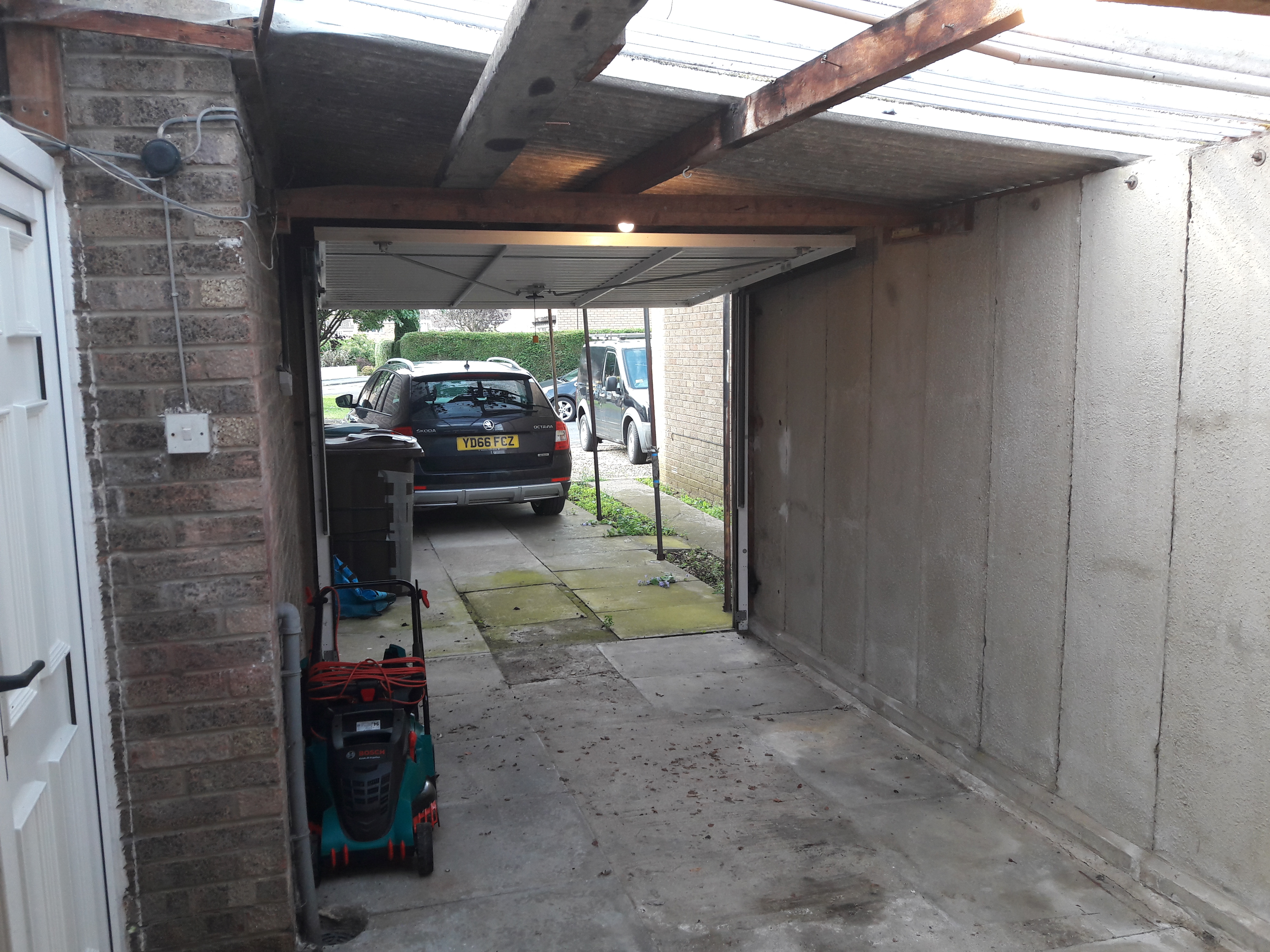

Nice space but close to the neighbor’s house… !

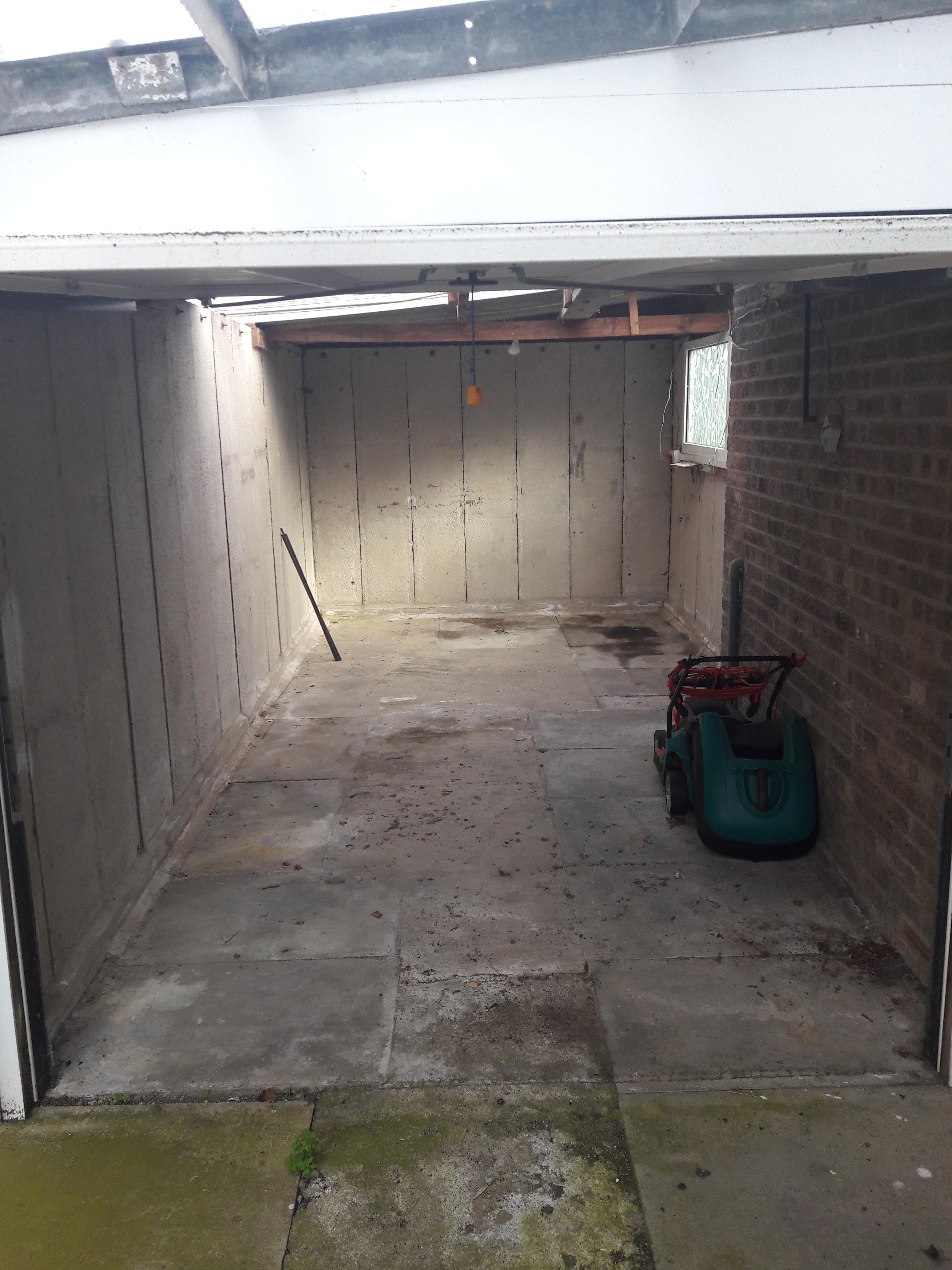

Well that was one concern but there is about a meter gap, and I have no power hammer :( Also the ground is quite soft so shouldn't carry the vibration to much.
Is that asbestos on the walls?
No they are just cast concrete panels, however the roof is.

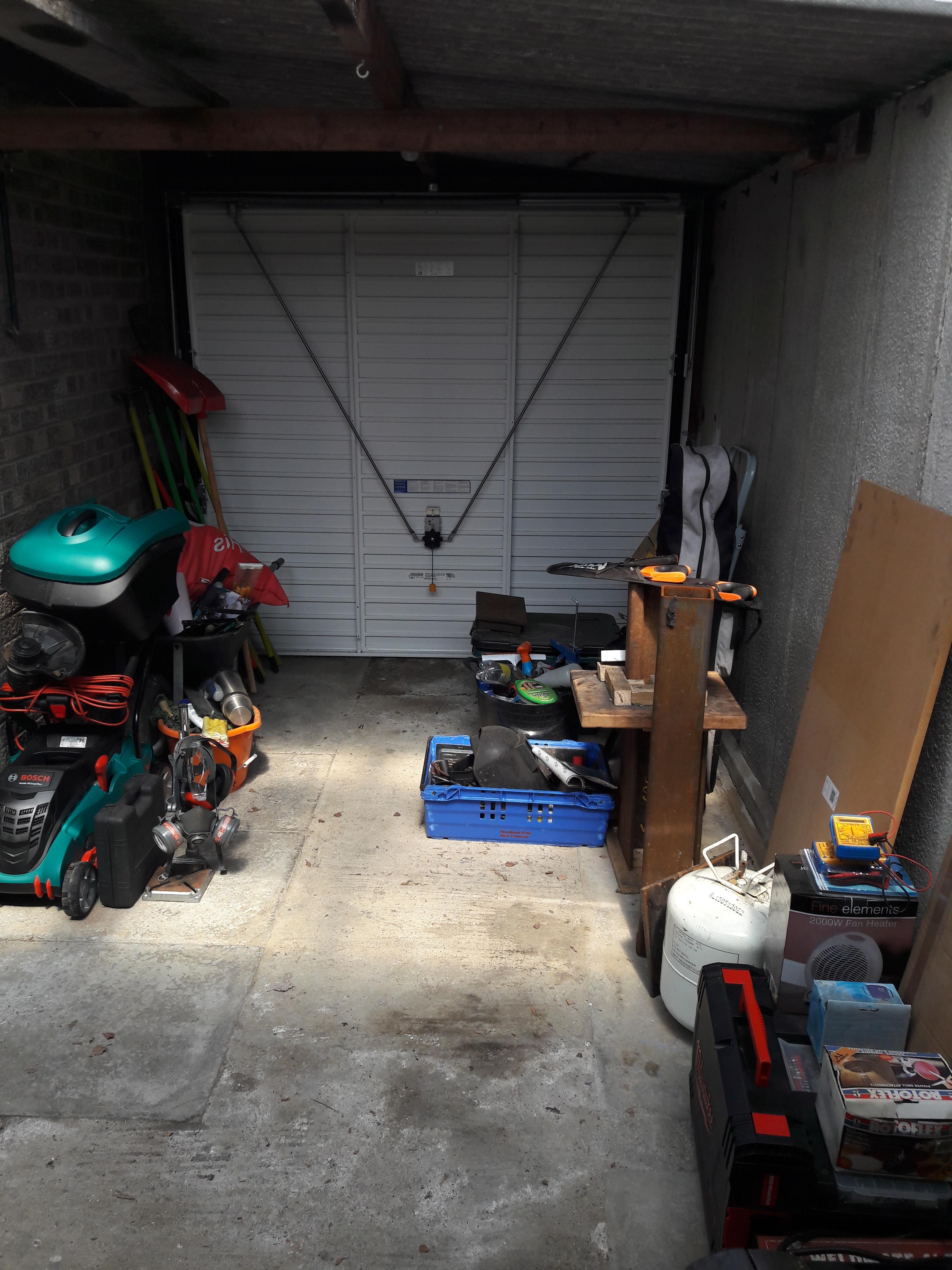

Well that filled up a lot quicker than I thought.
Nearly all the stuff near the big door is going to get moved to the new shed so I will gain all that space back.

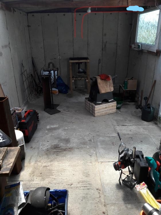

So I need to put a chimmney in as the weather is now taking a turn for the worse and can't leave the doors open anymore.
Going straight up through the roof. So I was planning to take the route through the side following the red lines on the picture, then to increase flow add an inline fan where the blue smudge is to keep it away from the heat and then the cowl linked on the outside.
I could really do with some advice on this as I have read a number of articles on the site, and I think I have found a midground that will work for my setup but was hoping to get a second opinion.
6" ducting ( I know 8 or 10 would be much better I don't have the space on the exit point to fit the diameter)

So I was wondering if my previous post was so stupid that it has shocked everyone into silence or it got missed in all the new posts.
I am aware that an 8" or bigger would be better, but for now I have to work with what the building allows.
When I get a new roof on the place I will be going for a full chimmney with the height and diameter required.
But do you think what I have outlined would at least clear the small amount of smoke and CO that will be produced.
I am burning coke so the levels of smoke are negligble once the initial start up is done. Also I intend to fabricate a wide hood to help with capture.
Any advice would be greatly appreciated.

Basically the items you have selected are appropriate for toilet exhaust from a group toilet with around 3-4 stalls.  I would never recommend this type of system for the exhaust from a residential kitchen hood, much less a hood serving a solid fuel forge.  There are several material and equipment size choices that are just not appropriate.  Also, I don't know what your codes are over in the UK, but over here use of that type of system would not meet code and in the event of a fire would likely void any homeowners insurance.  I strongly suggest you consider other options and get a local, competent engineer to evaluate same before use.
Some of the issues for use of you proposed setup as a forge hood evac system:
  1. Corrugated aluminum duct for long runs of hot, product conveying exhaust (fly ash...) is a bad idea both from a material selection (aluminum not steel) and surface configuration (higher friction from corrugations, local spots for potentially collection of flammable materials).  The corrugated duct also has a tendency to sag on horizontal runs, which can exacerbate the problem.
  2. Your fan is rated at 175 CFM with little or no static pressure.  Depending on your hood configuration this may not be sufficient (a good rule of thumb there is for a conventional overhead hood you need at least 100 ft./min. velocity at the opening, i.e. a 2' x 2' hood requires at least 400 CFM. As inlet velocity is the key driver for the effectiveness of a sidedraft hood, you would likely need a much higher velocity at the relatively small opening).  The fan also has a plastic impeller and a small motor inside the hot airstream.  Neither of these is a good idea for a hot forge exhaust system.
  3. The outlet cap is also plastic and has a bird/insect screen with backdraft damper.  Again material and configuration are not appropriate for the task.
If you are relying on this as general exhaust from your space (not attached to a hood), then some of the previous issues won't be a problem.  I would still recommend that you go with a sidewall exhaust fan for general exhaust (more air exchanges as required, figure around 2.5 CFM/SF as a good rule of thumb).  Remember that any exhaust you remove has to be replaced from somewhere, so you will also need a makeup air opening to the shop exterior.

1. I did read some information about aluminium ducting on the form but I thought this related to the insualted ducting, So would steel spiral ducting be ok as it still has the raised areas. Along the horizontal run I was going to a series of brackets to support.
I am guessing this would be ok then.
http://www.ebay.co.uk/itm/Galvanized-Steel-Spiral-Duct-Tube-Ventilation-Different-Diameter-Extractor-fans/322263599833?_trkparms=aid%3D222007%26algo%3DSIM.MBE%26ao%3D2%26asc%3D49480%26meid%3D510179e5369545ec96215dab30fa897b%26pid%3D100005%26rk%3D6%26rkt%3D6%26sd%3D110826630595&_trksid=p2047675.c100005.m1851
2. Apologies I miss read the spec on the fan I thought it was 298 CFM not in meters, and yes I did have my concerns for the material on it. But I thought the distance from the heat source would address the risk. I agree after reading that spec that it is totally unsuitable
3. I did find an alternative cowl which is made from Stainless Steel and rather than having the backdraft it has a larger opening and  only has a mesh on the inside to prevent birds getting in. https://www.amazon.co.uk/dp/B01LW17LPX/ref=twister_B075XCPCYT?_encoding=UTF8&psc=1
I have remeasured the space I have and may be able to just squeeze an 8" pipe in the space if I reinforce the surrounding area, the only issue i would have is finding a way to mount an up section on the outside of the building I will try to get more pictures of the setup.
I will also try to find more on the regulations in the UK I only seem to be able to find ones for internal chimmneys.

Ok so after some more research on the laws it has to be at least 5 foot (1.5m) above the highest point of the roof so it looks like I have no choice but to go straight through the roof.
So think I will just go with the two options below and make my own cowl to go on top out of some sheet metal I have.
