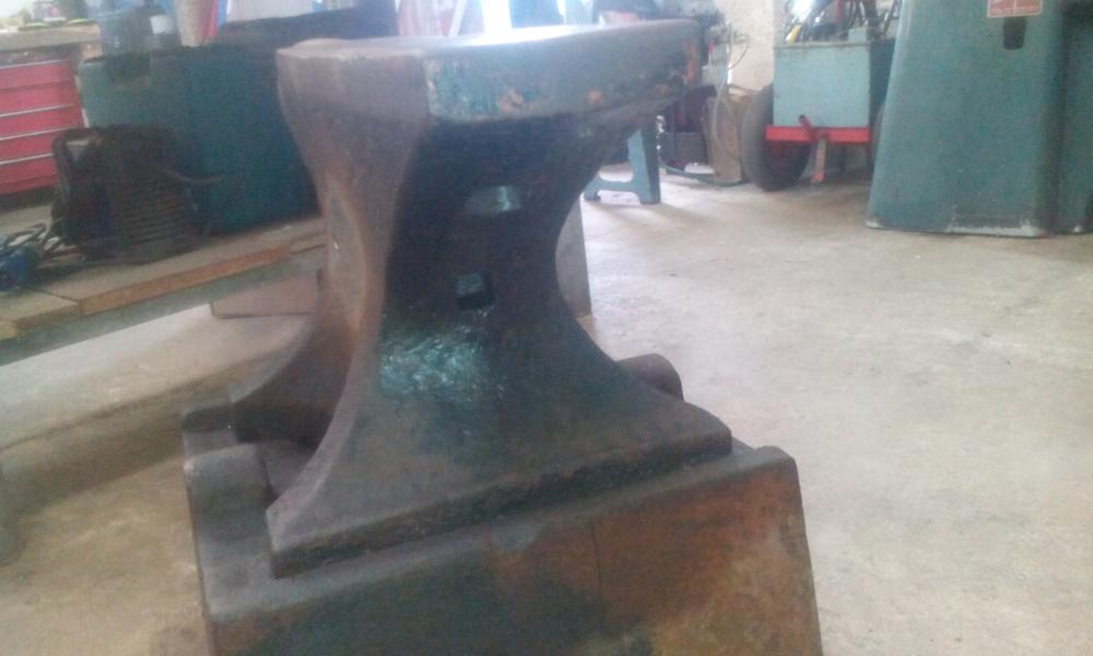

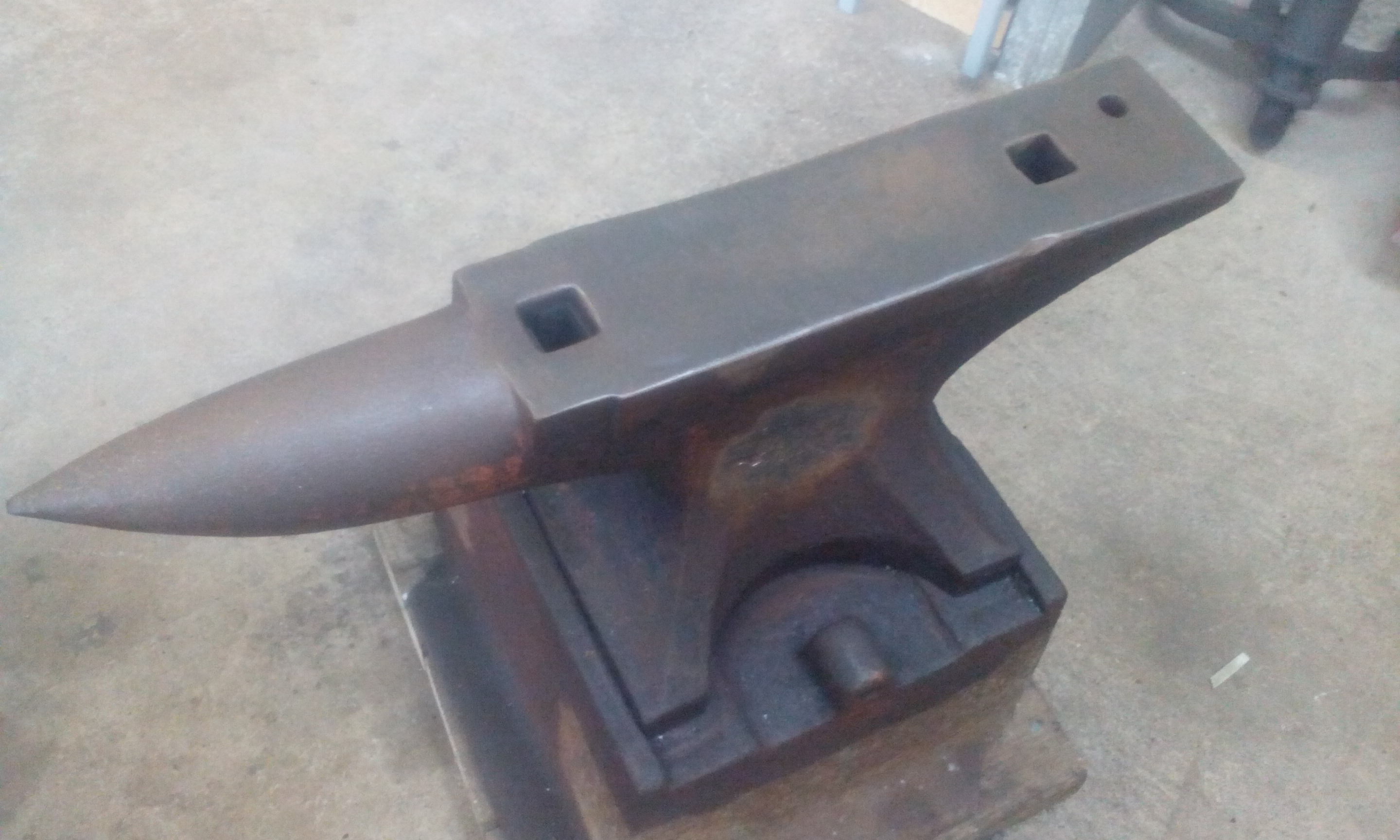

I was wondering if anyone might be able to help me identify my anvil. I bought it afew years ago but have only gotten round to trying out blacksmithing recently, great fun :D

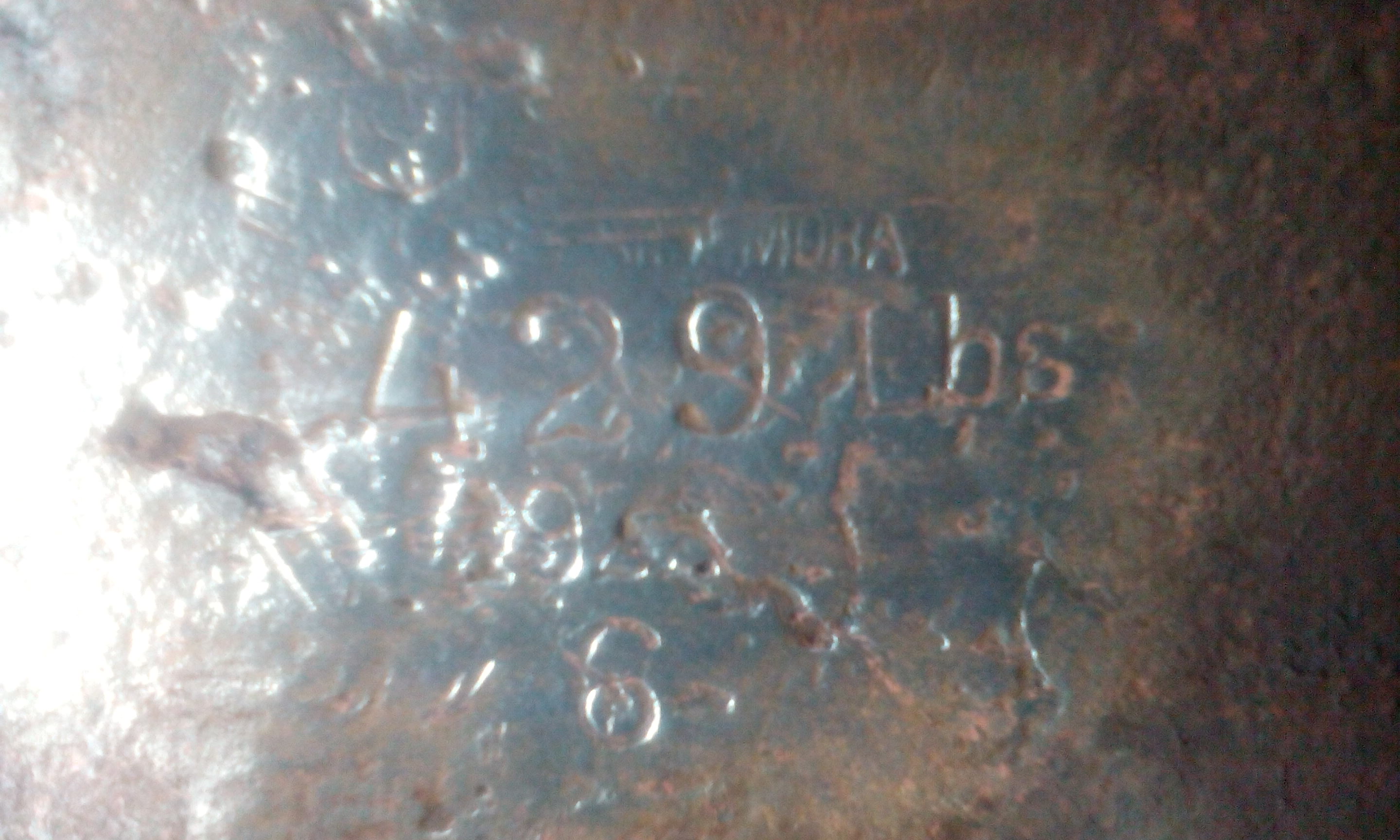

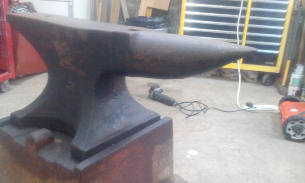

It is 429 Lbs and seems to be in pretty good condition as far as I can see anyway. Here are some photos -

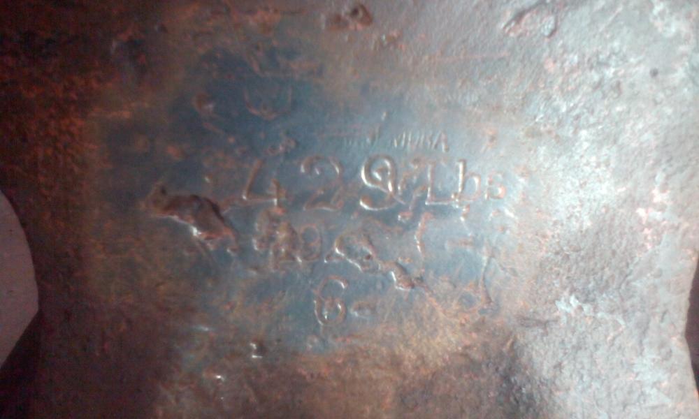

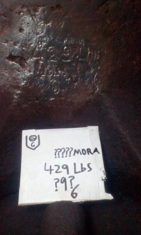

There are numbers, a symbol and some letters stamped onto the side.
I can make out the weight but cant see much of the writing, some of it is missing. The only letters I can make out are MORA which seem to be part of longer word.

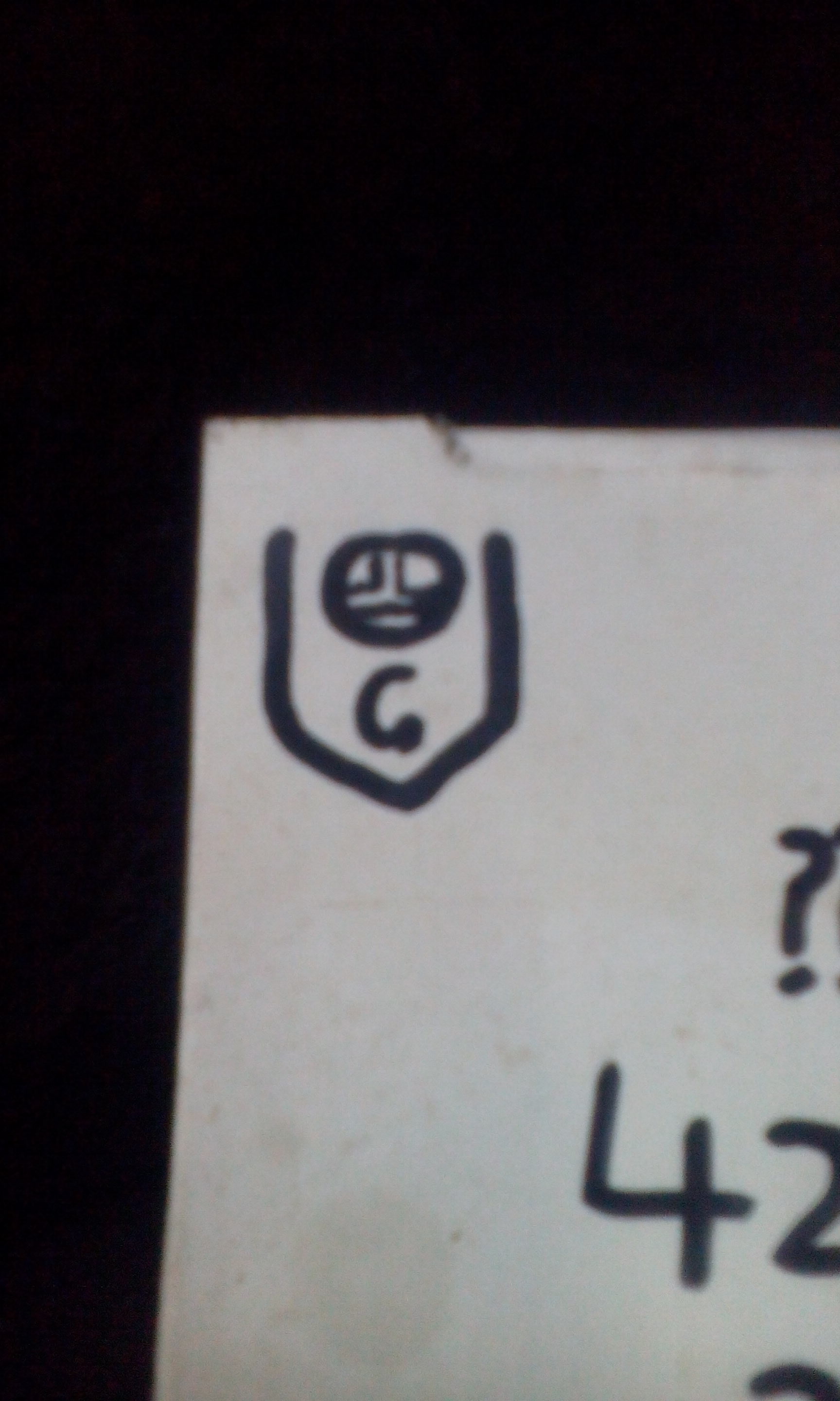

I drew a picture of the symbol and numbers/letters hope that helps
Also there is my first pair of tongs :lol: room for improvement im sure

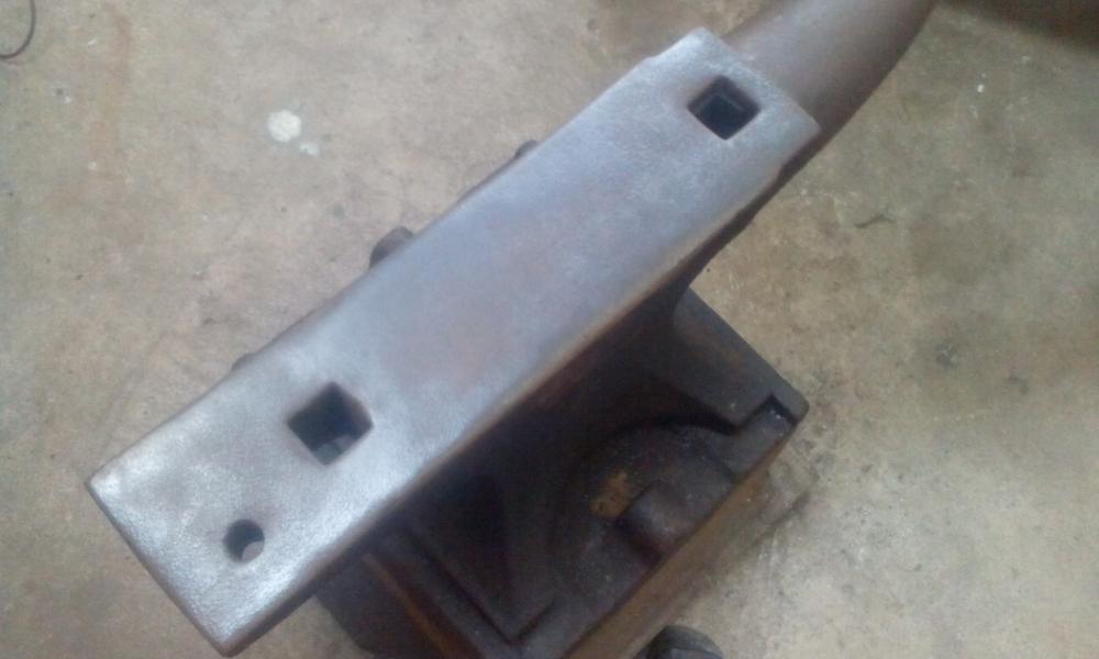

Lovely Soderfors anvil!   That is part of the shield logo  you see, and Dannemora was part of the Swedish mining district where the high quality iron-ore was known for.  The double-hardy hole pattern like yours was not a very common one.
The year stamp is partly visible, maybe 1922?
Here's a better look at the shield logo on a sign that I have:
Thanks, didnt expect such a quick response! It may say 1922 now that you say that, il have a closer look at the anvil tomorrow.
So the anvil is from sweden?
Yes, cast steel, made in Sweden.  VERY good stuff!!  Worth a lot of money here in the U.S.  Where are you located?
Also the anvils looks to be sitting atop of a Blacker hammer anvil base.  Interesting.
good to know :lol: i feel i may have got myself a bargain then! im in the Shetland Islands
Also yeah, no doubt that symbol is definitely the same. good stuff
