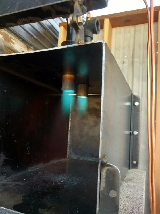

Finally have had a chance to work on the forge again! the following pics will show some of my successes and failures.
This one is the initial firing of the "Frosty Burners"
This is after trimming the tip a 1/16th on the first burner

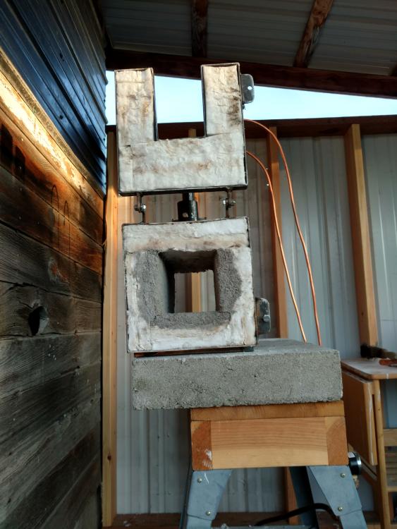

I decided to finish lining the Forge. Two 1" layers of Kaowool with a heavy 1/2" of Kast-O-Lite then a final coat of Metrikote. I used a collodial silica rigidizer on the wool before the kastolite. Let dry a little and then fired the forge to dry the rigidizer and after applying the Kastolite let sit over night before applying the metrikote. Now will let it sit for a few days to cure and get rid of any residual mosture before firing again!
This looks like only 3 sides of kastolite but I did finish the top also. I did 1 side at a time, rolled the forge 90 degrees after it set did the same for both sides, let dry over night and turned it over to do the top the next morning! 1 1/2" ABS pipe worked well as a form around the burner openings!

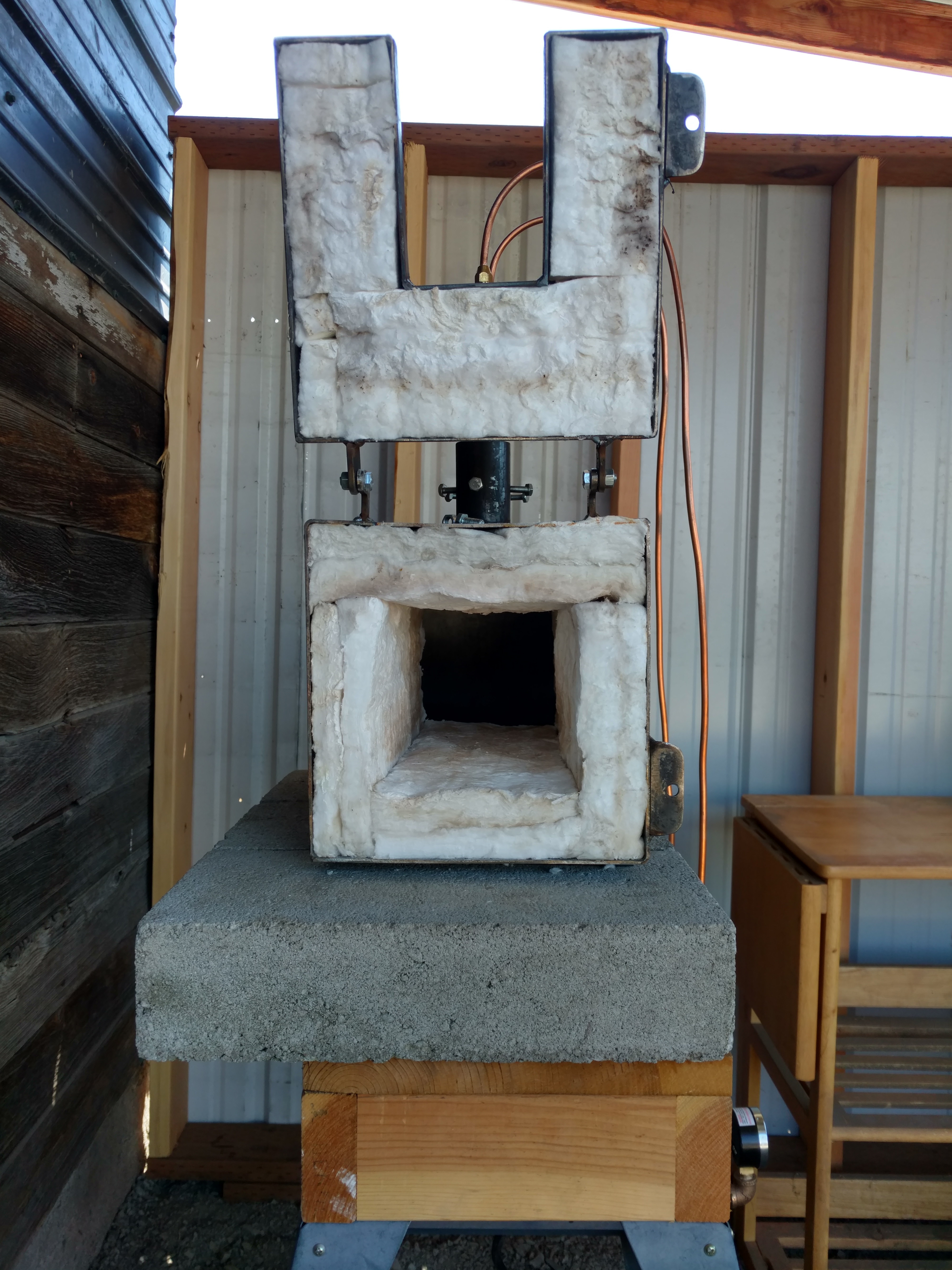

And the finished product.
From what little the burners have been running it seems that the fairly good flame is going away with the more the interior space is cut down. I also had been using Larry Zoeller flares in the original test burn but found some of the thread protectors that Frosty mentioned in his "T burner" instructions so I changed the burners to those. When I did the drying burn for the rigidizer there was a small amount of Dragon breath and orange flame. Regretfully I did not get a pic of that but will document the rest of the tuning.
