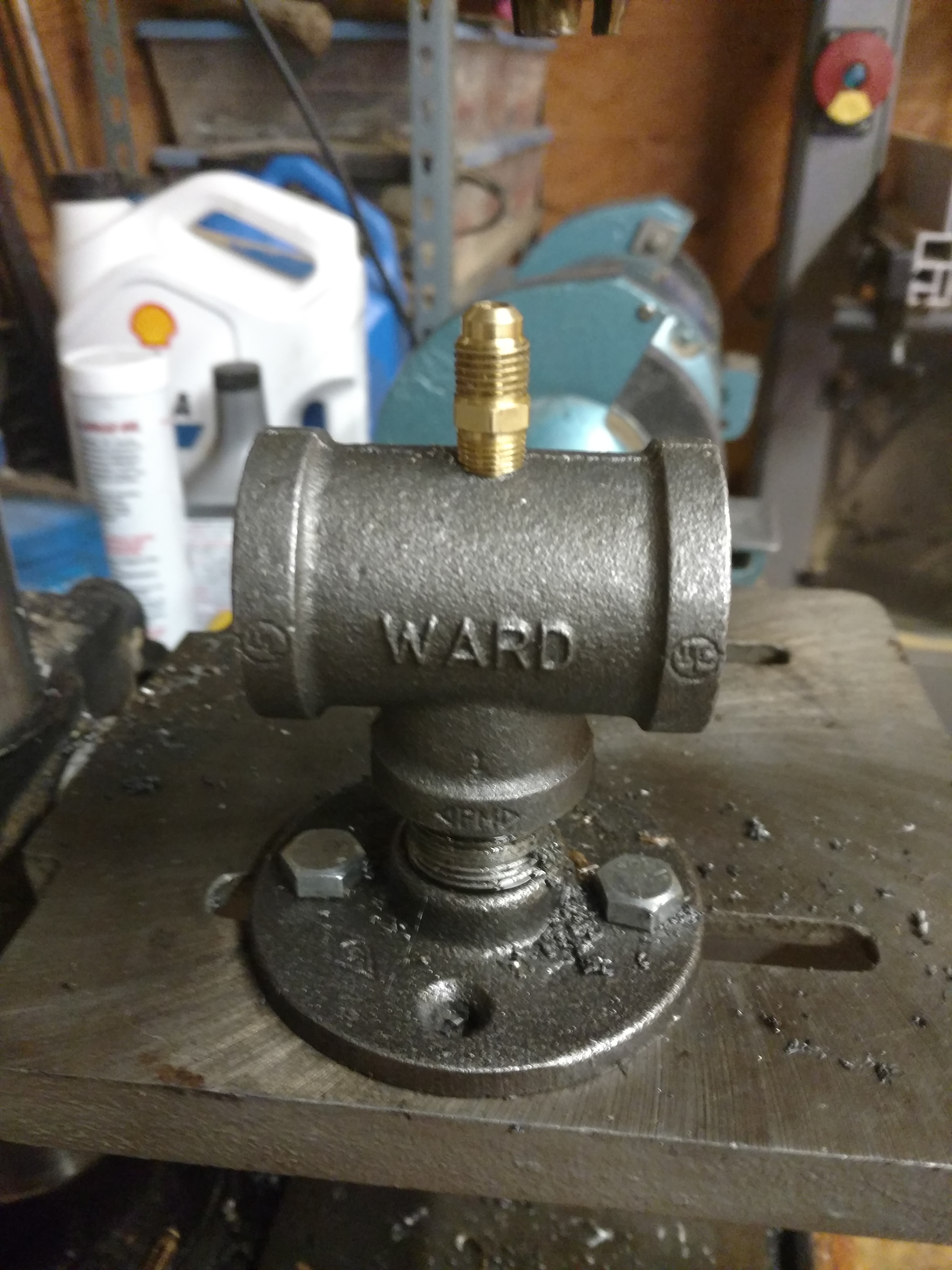

I intend to document this build and post on here with enough pics to explain what I am talking about, showing my successes and failures. The first thing built were Frosty's T Burners. Using his instruction guide the process was fairly simple and straight forward. To elaborate a bit on some of his notes, the ridge on the center line of the T's can and will deflect a drill bit if you don't take extreme care to make sure the bit is centered. I found by filing a small flat spot before center punching for the hole makes it a little  easier to stay accurate.

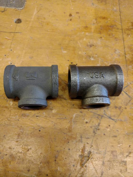

As you can see by this picture that all though the fitting is straight up and down it is still offset to the left. Had to redo
During this process and not wanting to spend a million dollars on a learning curve by buying all black pipe, I tried soaking galvanized fittings in vinegar to see if they were a viable option. The galvanized were $6.00 while the Black are $17.00. As you can see the T on the left is a Galvanized fitting soaked for 36 hours in vinegar with the black one on the right.
Was finally successful in getting a couple of decent 3/4" T burners. Still not sure whether I will use the Schedule 80  3" nipple with the Tweco .035 tip or the Brass fitting.
 The last picture shows how I adapted Frosty's idea of the floor flange and bolting it to the table on my drill press. So far it seems to work pretty good.

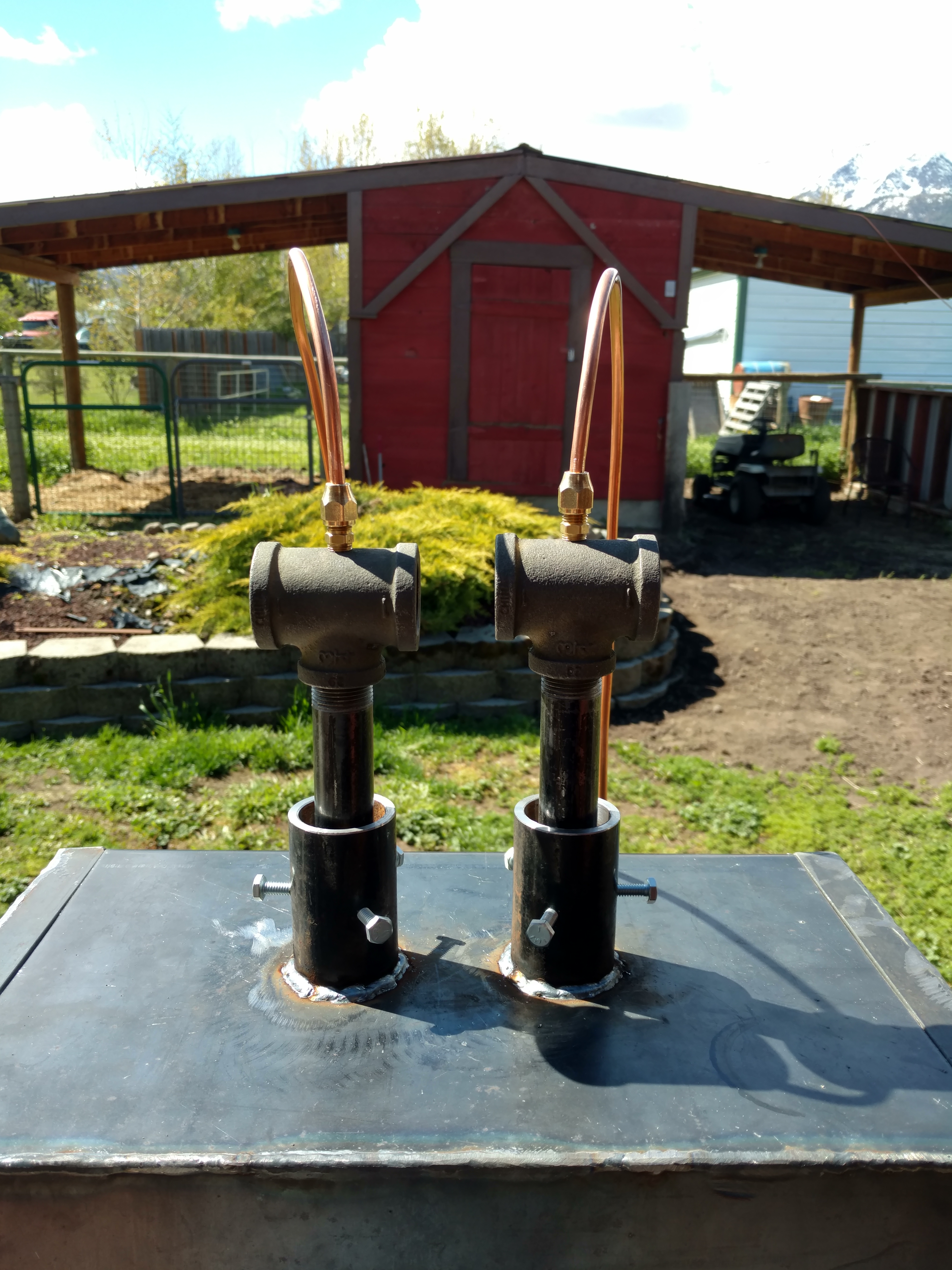

After getting the forge body back, the next step for me was to mock up the whole affair and see how my ideas would play out.IMG_20170515_193328897.thumb.jpg.a1fcbddcdcb9f5d0d4d7acee13b5fb9e.jpg
Still trying to decide if I want to hinge the front, but plan on putting some tabs on the back for some adjustment. The burners are 4" apart.
The next pictures are of the plumbing from a main shut-off through a gauge (I haven't found a good gauge yet) then to the manifold with a shut-off for one burner so you don't need to run both if you don't need to. The pipe is 1/8" black pipe to 1/4" flared copper. The regulator is just off the tank and not shown here.

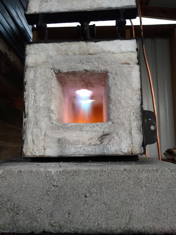

But I didn't insulate and I should have cause 4 hrs after shut down it is still so hot you can't even touch it. If you look at my burners I made the jets from oilfield heater treater burners and they work awesome they already have the perfect hole in them but I opened them up to 3/64.
I'd say you learned something by reading this forum.  I hope you are going to insulate, without it you will only heat to a dull orange at best. Looks good, let us know how the burners perform.  You may need to rotate your burners slightly to allow each T to gets it's own air.  I would have them facing across the forge to avoid gas's from the doors.

As it stands now, I intend to use two layers of 1" Duraboard with a refractory coating of an undecided nature yet. Probably will use some type of fire brick for the floor. 1" Duraboard on both the door and back end also. With the forge being 10X16 this should leave me with about 480 Cubic inches of forge area, which 2 - 3/4" T burners good for around 700 inches should be plenty! May end up dropping to 1/2" burners later!
Thanks for the tip on turning the burners! I had thought about that but wasn't sure!
You tells em and you tells em but they still . . . <sigh> No bricks! Hard fire brick is a heat sink and insulates only slightly better than limestone. Either coat it with hard water set refractory, Wayne Coe sells small quantities for reasonable. Or lay a high alumina kiln shelf for the floor.

With 2" of Duraboard insulation isn't an issue but fire brick is still a serious heat sink and it's susceptible to borax based flux.
This is the completed forge box with hinged front and adjustable rear. Just need some cleanup and paint, and some insulation (which is proving to be very difficult to get) and it  is ready for final assembly and testing.
These are the hinges I fabricated for the front
This is the adjustable back,
This view is from the back showing the front open and the rear in the closed position
