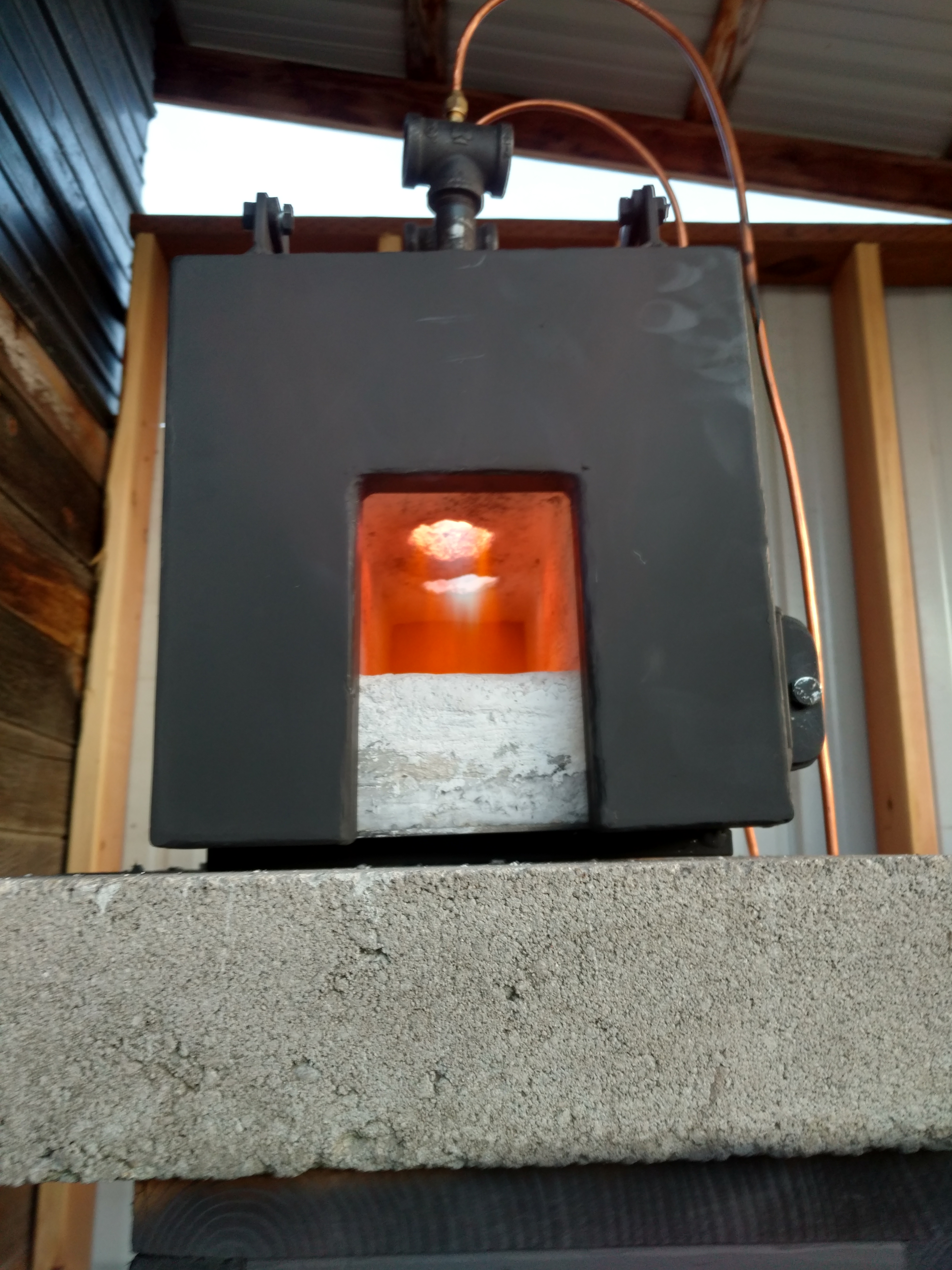

On the bright side this thing gets hot inside in a hurry! The down side is obvious in the next few pictures. My forge is outside but fairly well protected from wind so hopefully that doesn't come into play. At this time I am only running at about 2 psi. I have cranked it up to 5 psi and it just magnifies the same issues shown here.
This is just a few seconds after starting
This is about a minute after starting
This is about 2 minutes after starting
The same time as the last pic just a few seconds later
How hot does it get? It looks slightly rich about how I like but it might be burning a little lime in the refractory.
How many cu/in is the chamber?
How does it work for you, heat any steel with it yet?
I heated a small piece of leaf spring about 8' long and it turned almost the whole thing red in less than five minutes. But that was before the kastolite and metrikote. I haven't put anything in since then because I'm still waiting for the lining to cure. So I haven't really pushed it yet. It's only been a few days so just wanted to make sure it was good and dry before using. Turn it on long enough to see the difference after making changes to the burners
There is 361 cubic inches in the chamber. 4 3/4 X 4 3/4 X 16.
You're in dry country 24 hrs. should do the trick.
361 cu/in is in the upper limits for a single 3/4" burner, 2 are serious overkill even with the length. There's where the dragon's breath is coming from, there just isn't room in the forge for all that fire.
Try getting it HOT then turning off one burner. One end will be hotter than the other but you can only work on so much at a time and when you need full length heat light the other one.
It's going to be a screaming HOT forge.

Frosty I have played around with the burners some more and after pausing to think of where I started and what I've done, with what you said, decided to reverse the direction I had moved the flares. Results are a much improved flame and was able to increase to 5 psi with no more dragon breath than with 2 psi. with both burners going and much diminished dragon breath with just 1 burner. I think one final adjustment tomorrow when it is cool enough to handle will hit about as good as I get. I heated a chunk of leaf spring to workable color in about five minutes from start up. Not being a 100% sure of what color is need for welding i was at what i would call yellow in less than 10 minutes. Will get a couple more pics tomorrow!
Sounds like you got IT cornered. Yellow is usually plenty hot to weld depending on the steel and your technique.

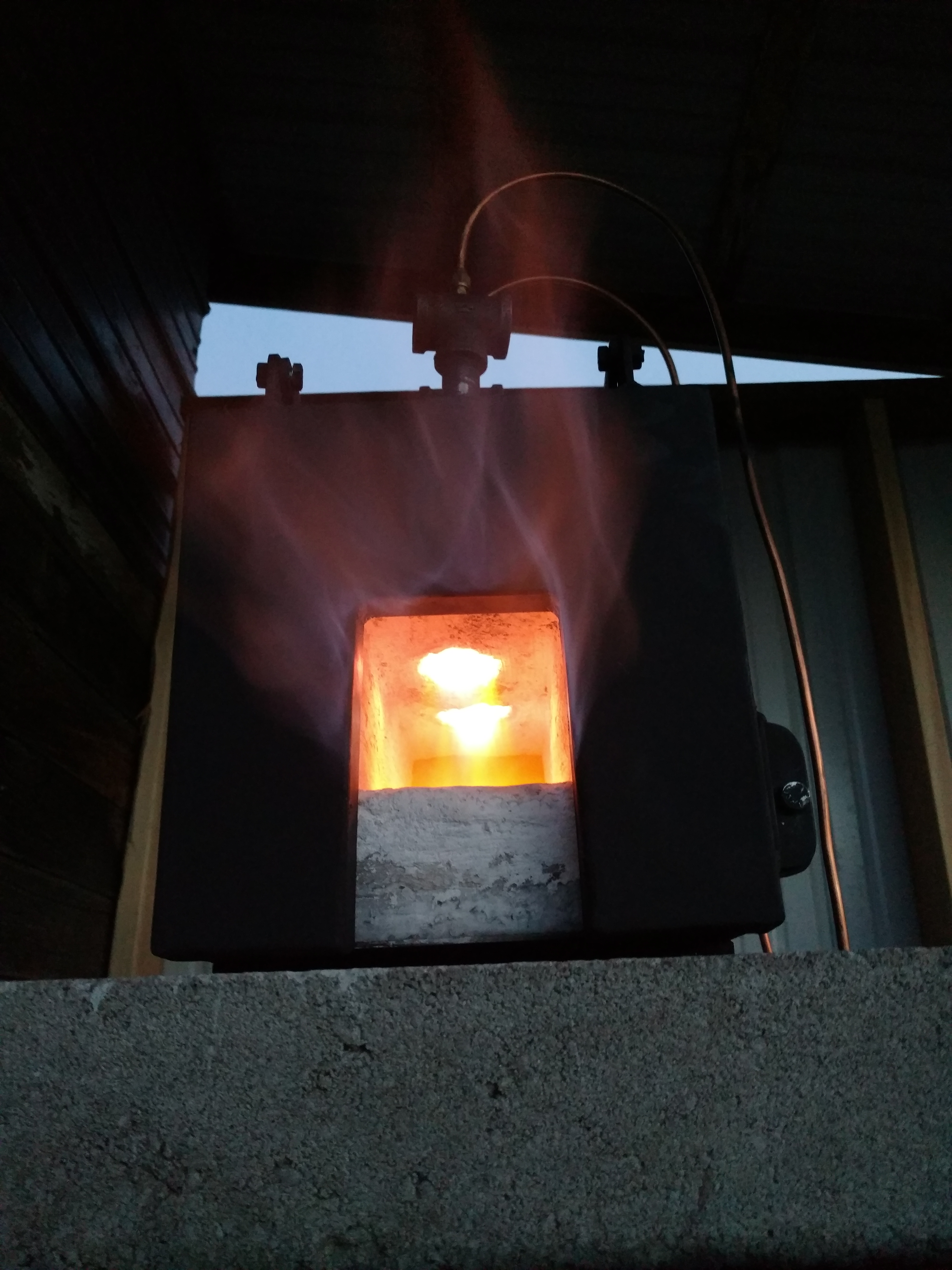

Looking at the one clear flame photo, I would make one last helpful change. Move the front burner, that has a lightly reducing flame to the back of the forge, and move the back burner that has a neutral flame to the front of the forge. This allows more distance for the secondary flame to burn off, and insures that the fuel that didn't burn, must pass in front of a neutral flame before it exits the forge. Better results all the way around for a small additional effort, yes?
Thank you Mike! Looks much better with that change!
The forge is outside so will take pics tonight when it isn't so bright out! Thanks again!
I'm hoping that the photo will be something of a revelation to other folks, about how big differences don't always need big changes; looking forward to seeing the next photo.
